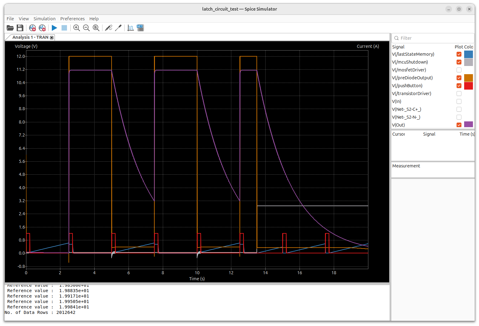

Fine. So I’m looking at the momentary switch. It seems to be a simple issue with just two traces that needs some modification. Going to bread-board it. And then of course, I would like automatic turn off functionality.
Latch Circuit for momentary switch with MCU shutdown
This has been a little tricky due to the D1 diode that needs to be there to prevent back-flow of current from large capacitors. But should be tuned now.
In case anyone wants to play around with the Kicad files of the Latch Circuit:
latch_circuit_test.zip (16.7 KB)

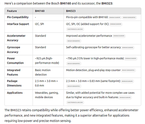

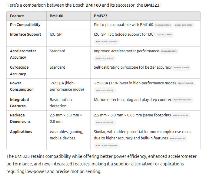

At the time when you were fiddling around with a replacement IMU for the BMI160, did you consider using the BMI323. It is pin-compatible with the BMI160
just a little more precise. And it’s cheap on LCSC.
Sorry this is a fast comparison made by chatgpt and there might be hallucinations. But just wanted to ask before trying it out.
so it could be fixed on v1 hardware ? I am building another board so I could test if this is working on that one good to know :slight_smile:
Sure but I havent found anything about it to be compatible with the current VESC firmware, thats why I used the other IMU
We may have to ask BenjaminV, if the IMU has been tested with VESC already or if there could be any problems using it. The thing is there are filters and stuff that need to work in order to use it correctly. As it is my understanding you cannot use just a more precise IMU and hope everything will work the same. I mean more precision means it could be more subsceptible to vibrations and so on. I guess its not that easy to just use something else but I could be wrong … (Its a problem in FPV (Drones) . Which is also a hobby of mine)
You’re right it needs investigation for this particular part…

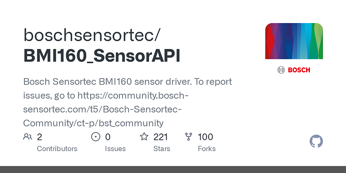

From where did you get the information that ICM-20948 works with Vesc?
its in the change log and source code of vesc:
i mean I am software DEV thats why I first look at the source before considering hardware changes :smiley:
Ah yeah, and I just forgot that there’s a communication interface to the IMU - SPI or I2C, I don’t remember, but it’s probably going to be different for different IMUs…
i mean i haven’t tested the ICM-20948 implementation yet, I just tried to implement everything from the spec sheet.
