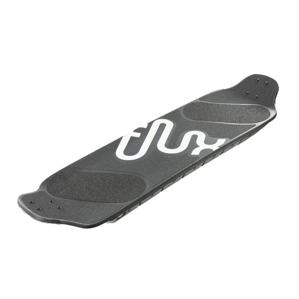

What are the differences between the 2 versions?
I know he said the deck has more concave and the enclosure is new and it looks awesome but it might not be friendly for diy because it was made specifically for his setup and escs but I’m sure we could figure something out
I am sure there is something we can do to accommodate an enclosure.
Nah I’m sure it’s fine. The new deck and enclosure go together. Most of the enclosure is filled with cells. His, others? It shouldn’t be a problem.
Enclosure is injection molded. Its a bit more segemented. With how it sits on the deck it’s similar to evolves gtr enclosure(noticed some spots where it wasn’t as close to the deck even after securing it.

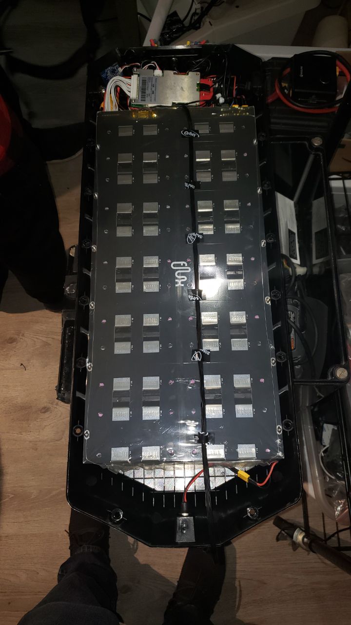

Build inside looks prettynear. Got to open one up to help a local install their Davega. The section for the esc is less roomy then the current one but if your stacking your bms kn your esc. There’s room for a robo.
It does have openings for a dc port for the head lights and. Tail lights.
I’m sure diy builds with it would be similar to like a eboosted enclosure.
Edit 1 : added picture
Edit2: I’m not sure how 21700 would fit without an added gasket bigger than the OE one

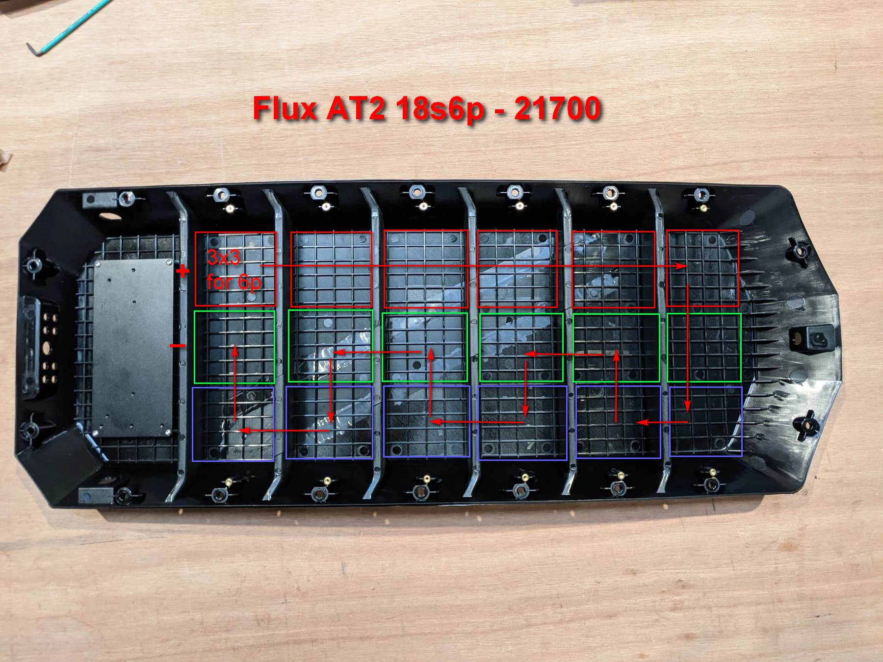

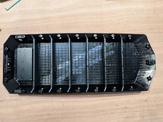

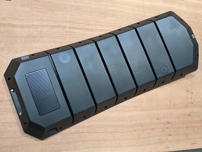

New AT2 deck and enclosure on sale for Black Friday, what do you guys think? Trying to decide between this and the MBS Pro 97 DWII + eboosted for a bottom mounted carver. Price is only $100 more for the Flux after buying the same trucks, wheels, etc.
New enclosure is injection molded and can hold 18x 21700 cells in each of the 6 compartments for a 12s9p configuration or possibly a 18s6p if 6 sets of 18s1p batteries were made and paralleled. Extra room in the front for a small BMS like Flexi
Heat sink mounted & ready
Edit: or this for 18s6p
@Skyart i would love to hear what you would put in this enclosure 18s6p sounds awesome
Personally I’d definitely do this over the mbs for a bottom mount carver.
Dude I’m so tempted :star_struck:

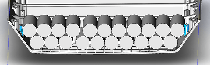

I believe 18s7p 21700 can work aswell if you cut the tubes with inserts out (indicated in blue)
