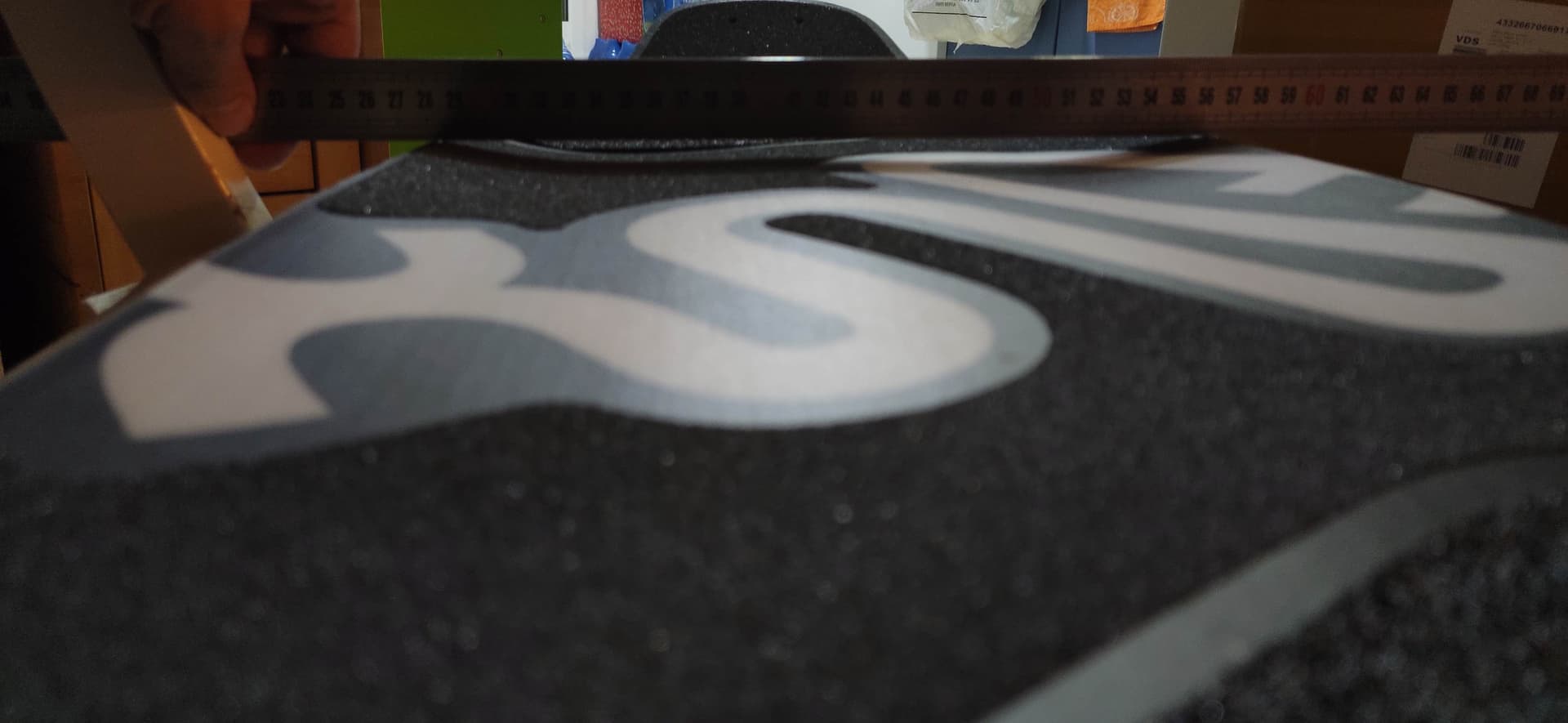

Thank you! Could you please tell me which is which on the bottom picture (194428) ? And which one is less flat for the feet?(less concave) Thanks for your pics, it’s worth a thousand words!! :grinning:
Looks like both have the same concave, let me recheck…
From the pic, it seems that i will have more space for my feet with the new model since it’s flatter longer.

They have the same concave, with the griptape looks different in photos.
Hope it helps!
Yeah, the concave is really minimal. I only noticed it when riding in rain and the water would pool up on the deck.
AT2 has a bit more concave as a different press was used. The CAD files for both were the same :slight_smile:
