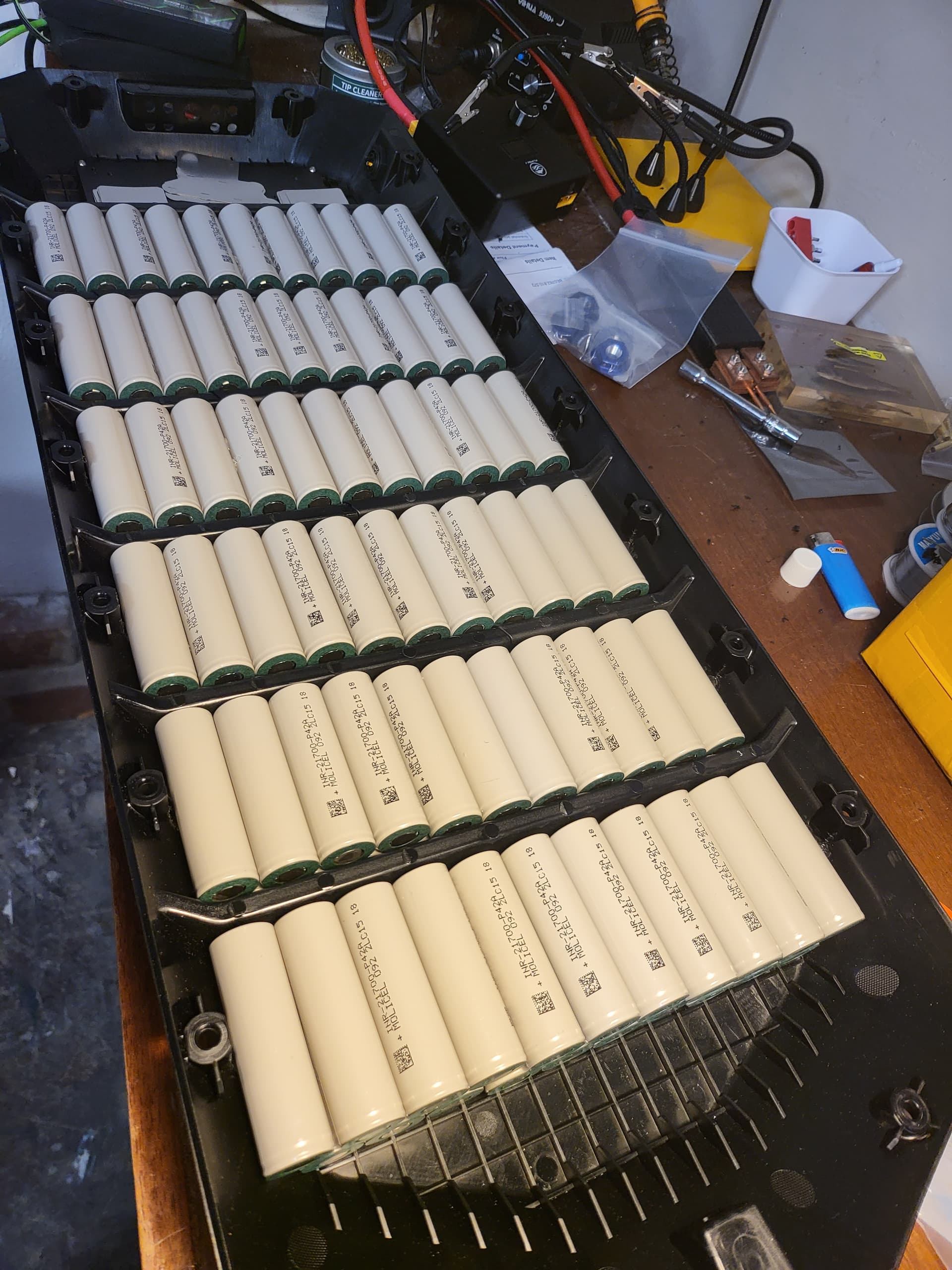

There are inserts molded into the inside of the enclosure, pointed out in red, I believe these are for bolting down the stock flux PCB battery. You have to cut those out and then 7P will fit. All internal and fairly easy to remove with a Dremel.
seems easy and worthwhile
I’ve got the At2 diy. Great deck, super wide and stable, it’s a keeper.
12s7p p42 (zfg Esk8)
6374 190kv
I know it will take more cells and it great having such a huge enclosure but I didn’t want a super heavy board also. Later if I need more range I can add the extra cells.
Confirmed 18s7p fit
Wow that is insanity
Technically, yes. Now show us practically.
I’ve done 16S7P in the same orientation. 21700 height is a little less ideal, and BMS placement above the esc is clunky but the factory method as well from my understanding. It’s overall an easier fit than plenty of other stuff I’ve done.
My in progress board has a 18s7p of 21700s. Needed to add a extra gasket because the battery ended up a little too tall
What gasket did you get?
Bought some .5" closed cell foam on amazon and cut it to size
Is a 16s6p possible on the first gen enclosure?
Yes. 18S6P would maximize the space. 16S6P would leave that room open

18s5p in 2 different configurations
