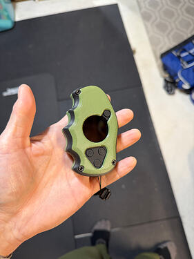

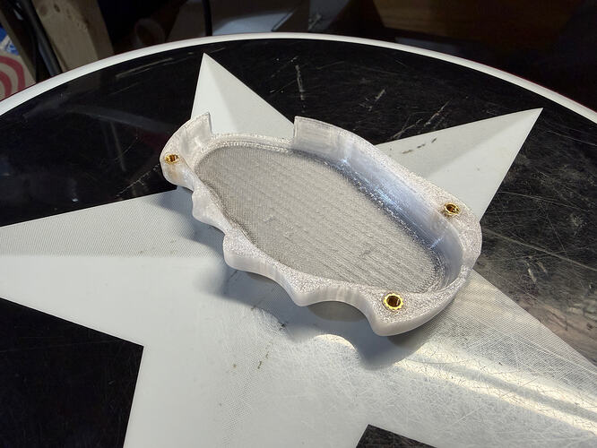

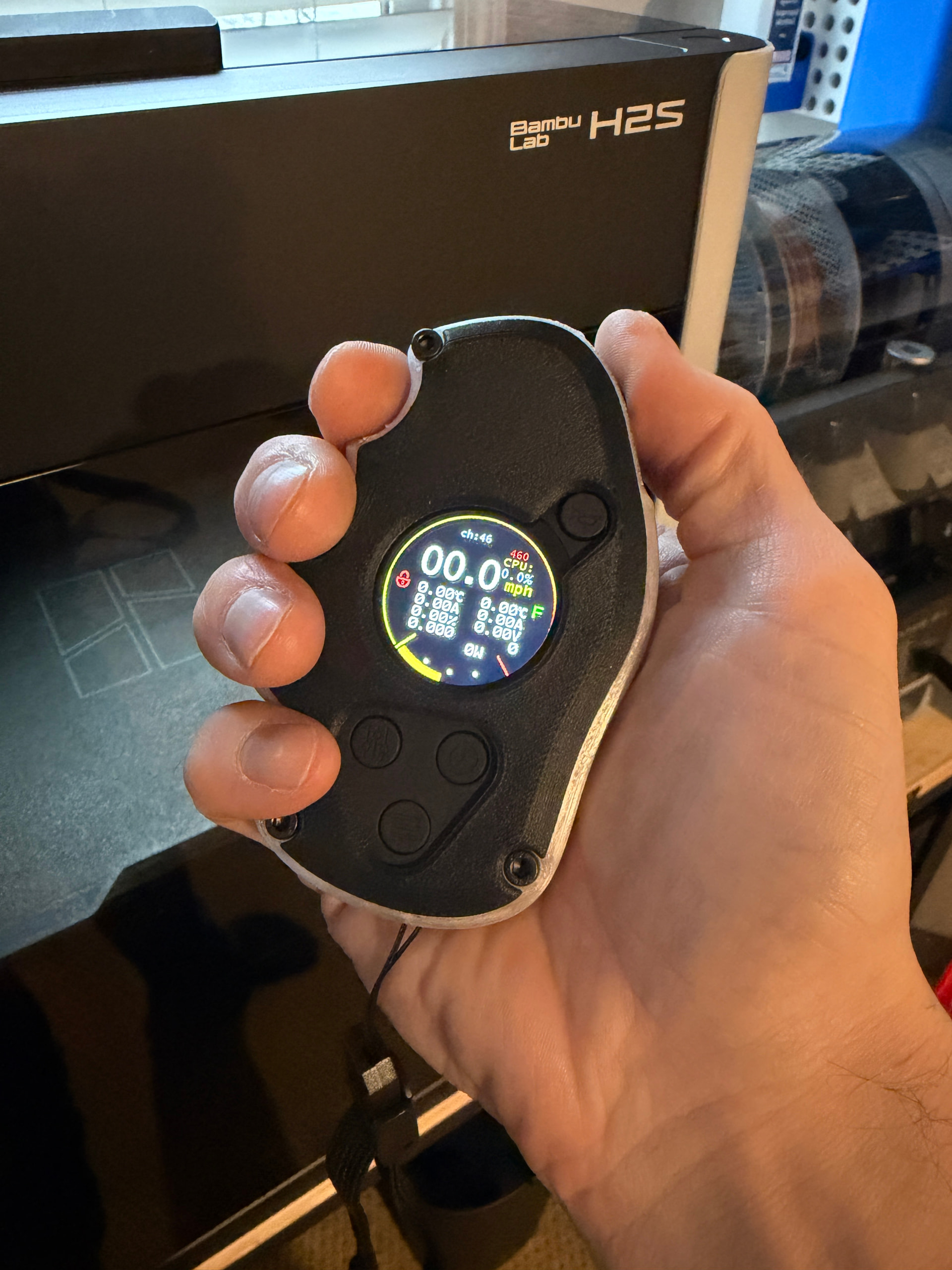

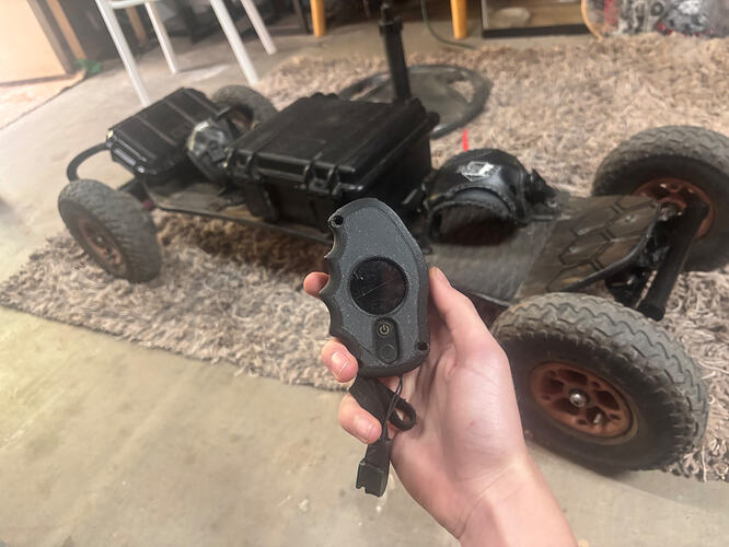

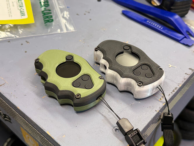

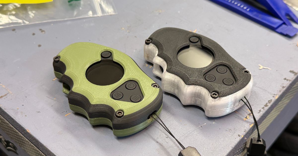

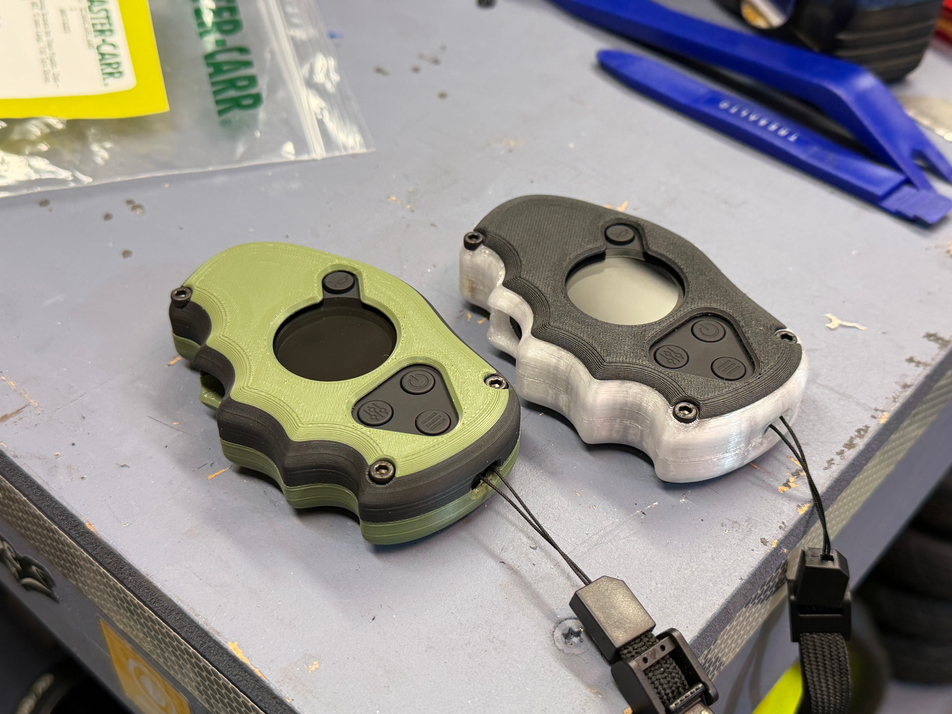

Using a file originally created by @Daada in his thread for a TPU VX4 Pro sleeve case I created a two-piece hardshell case for the VX4 Pro remote with finger grooves. I tested a few designs and this one feels good to me. I have fairly average medium/large hands. I did two different variations - one is using M3 thread-forming screws from McMaster-Carr that I had, and the other uses brass heat-set M3 inserts and standard M3x12 socket head screws. Both versions work great in my testing. I will link everything I used below.

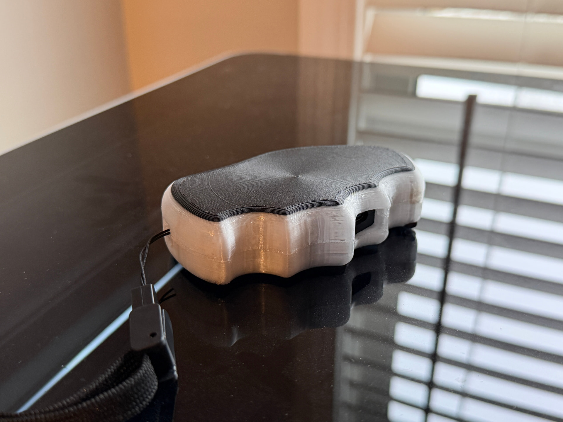

Here is my case hosted on Printables. This includes STL and STEP files for both versions, so feel free to modify any way to see fit. I printed one of mine out of translucent/CF PETG, the other olive green/black PLA+ and did a filament swap for the last few layers for a contrasting color look.

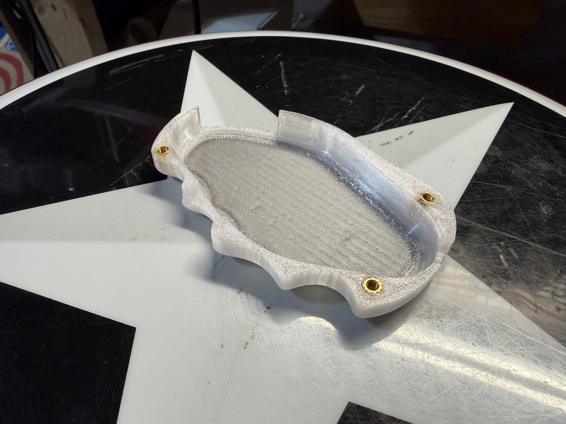

Because of the large fillets coming off the faces of the case, I found it printed cleaner by keeping the outside of the halves facing upwards and using supports on the underside. More material/time but gave me a way nicer finish. For the PLA prints I used PETG as my interface layer with 0 gap and vice versa on the other remote. Supports come off easy and leaves a good underside finish.
EDIT 4/22: I have added a file for the VX4 NON-PRO version with two buttons/no horn button. It is in the Printables link below.
EDIT 8/22: I added a big booty version that is uploaded on Printables and Makerworld. It has a bigger bottom for better hand placement and I reworked the locating alignment system that isn’t so fragile, along with changing the fillet to a chamfer for quicker easier printing.

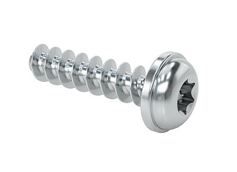

These are the M3x12 Thread-forming screws I used from McMaster-Carr:
These are the M3 brass threaded inserts I used from Amazon - note you don’t need a special tool for installing, you can just press them in with a soldering iron:

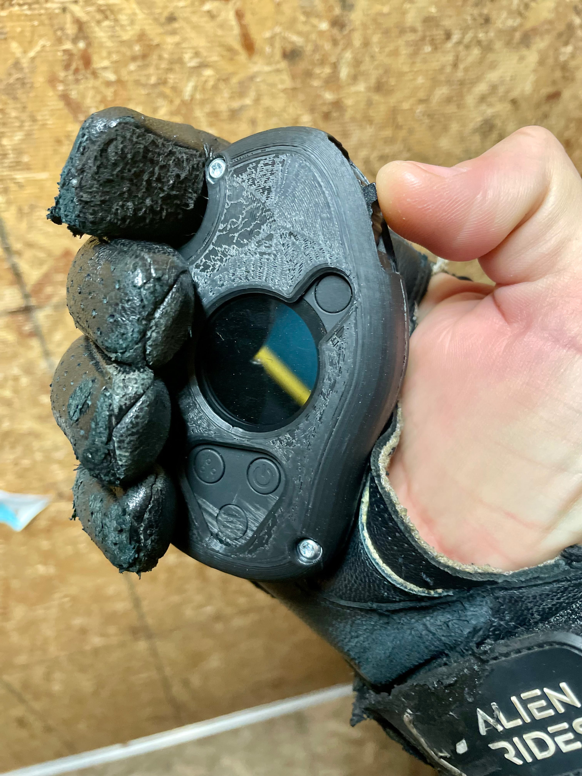

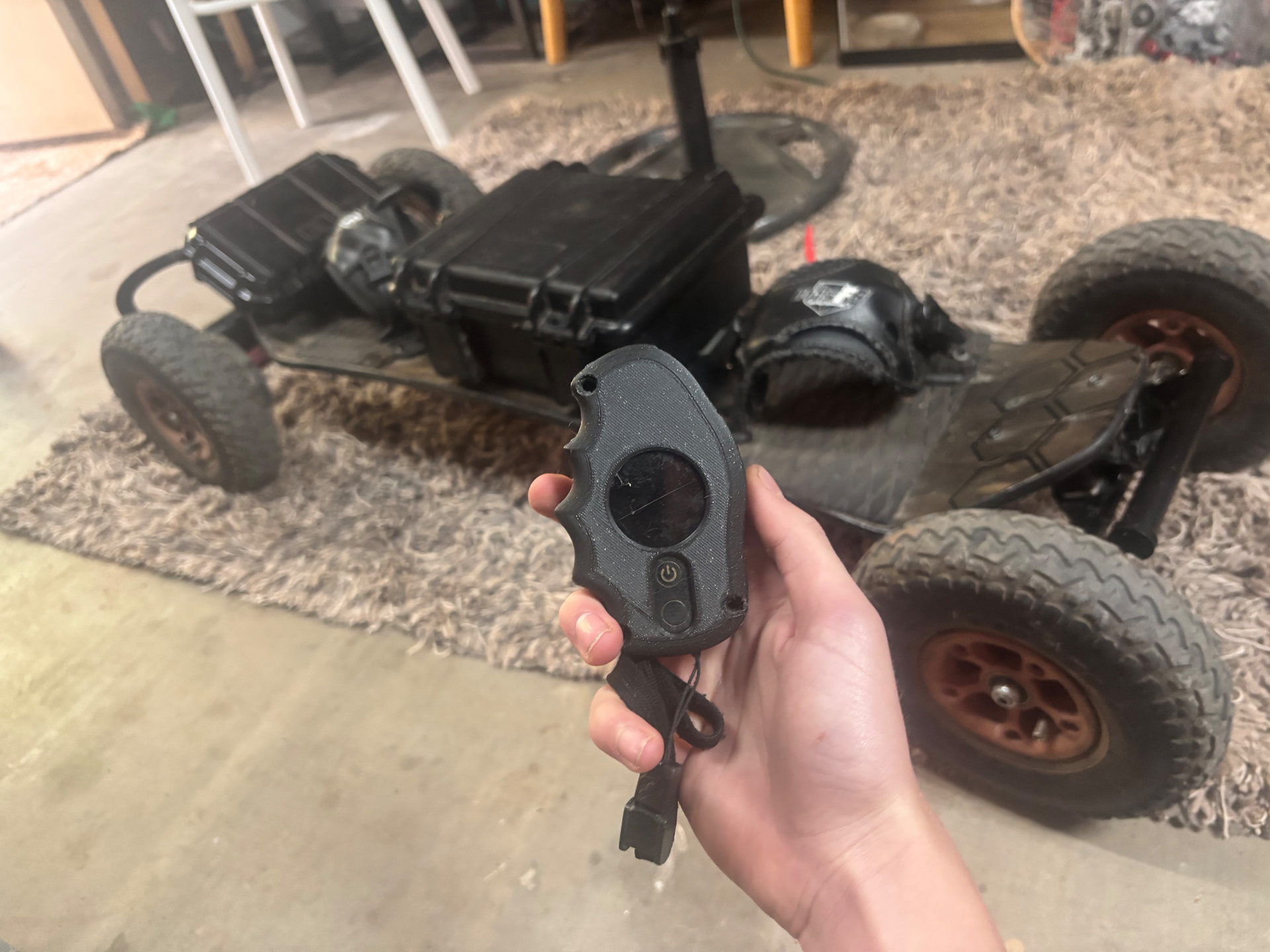

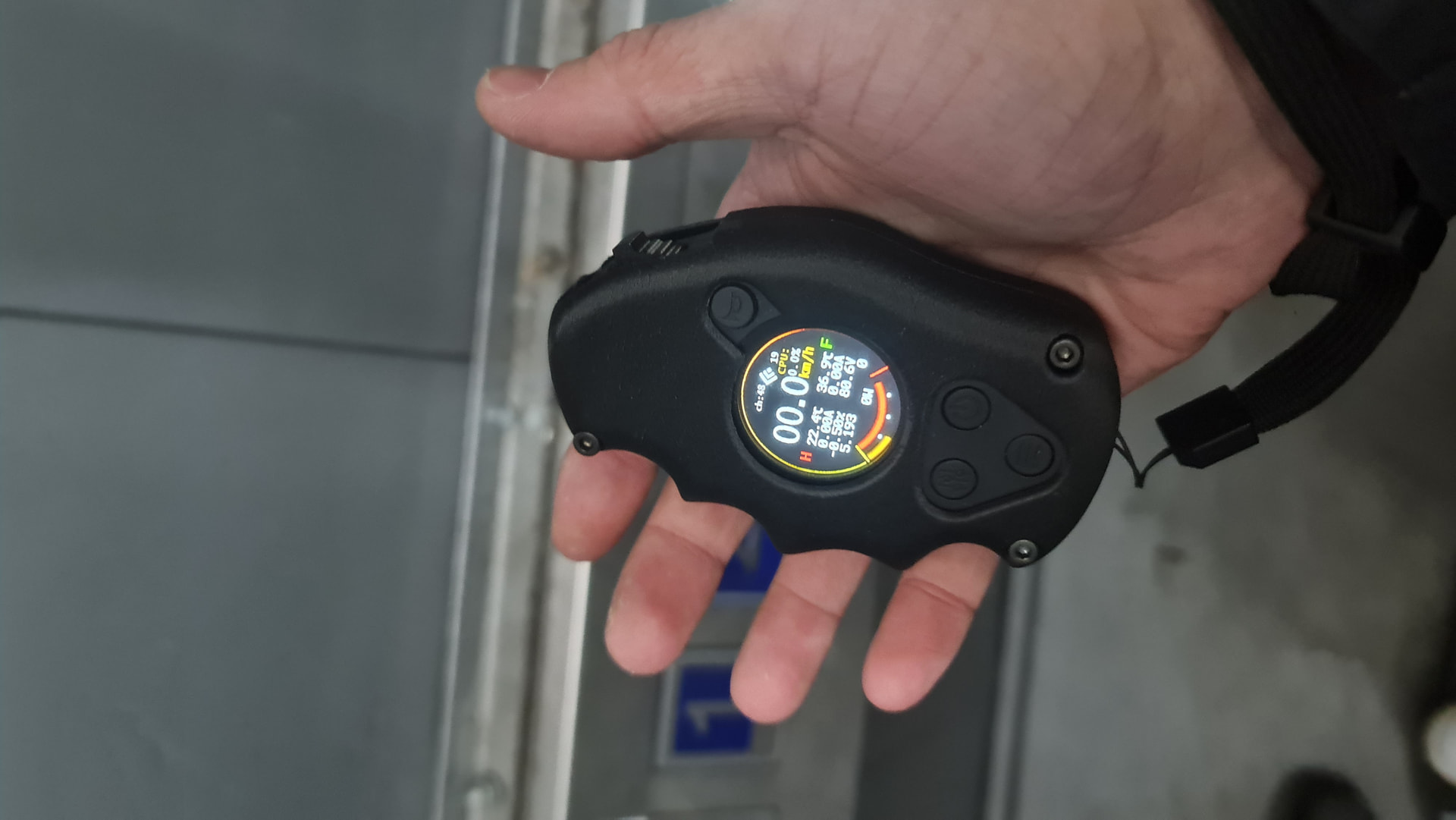

I printed the pro shell for my non-pro vx4 and I can tell myself that I didnt mind the empty missplaced button holes in the shell. I would call it funktional.
I printed it with supports on the inside, laying down flat. The top came out nice but the lips where both parts touch broke of quite easy. Could be a bit beefier so the lip would be easier to print in this orientation.
I was about 50/50 with that lip not getting ripped off with supports in my tests- I was thinking about looking at beefing it up a bit also, or messing with my support settings to keep them away from it

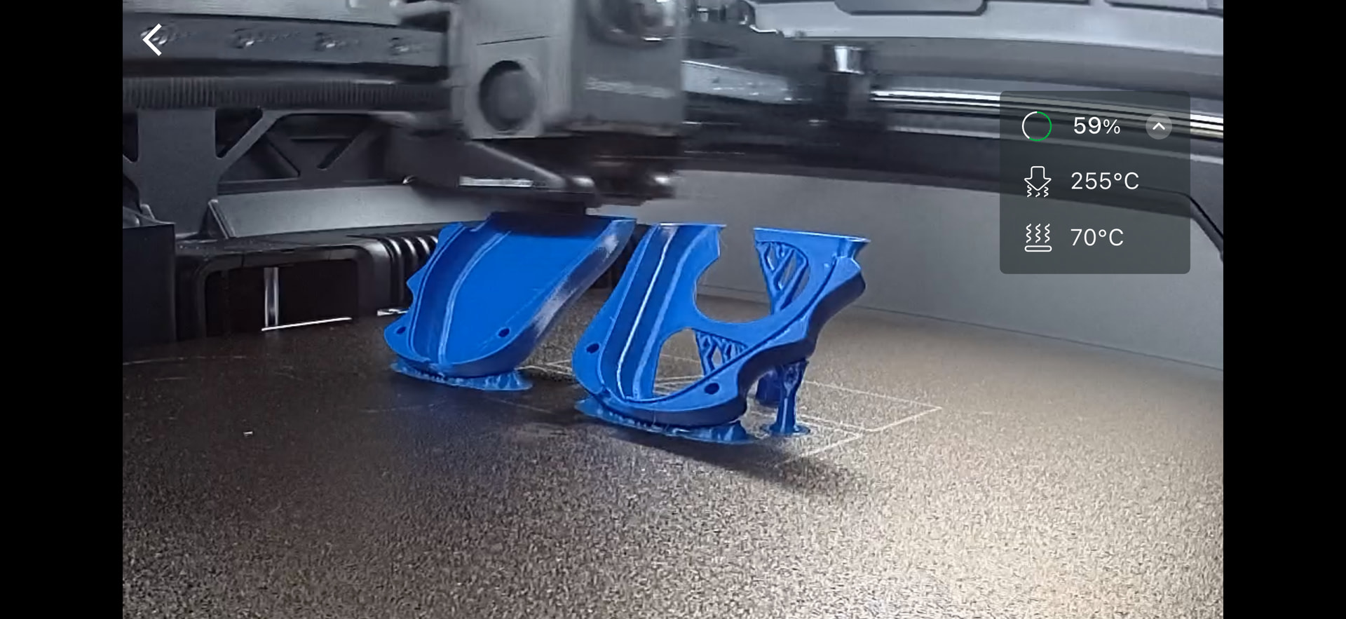

Best one I’ve done so far was printing both halves at a 45° angle off the bed but the supports gave it kind of a gross surface finish where they were. Going to see if I can improve that.

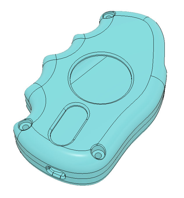

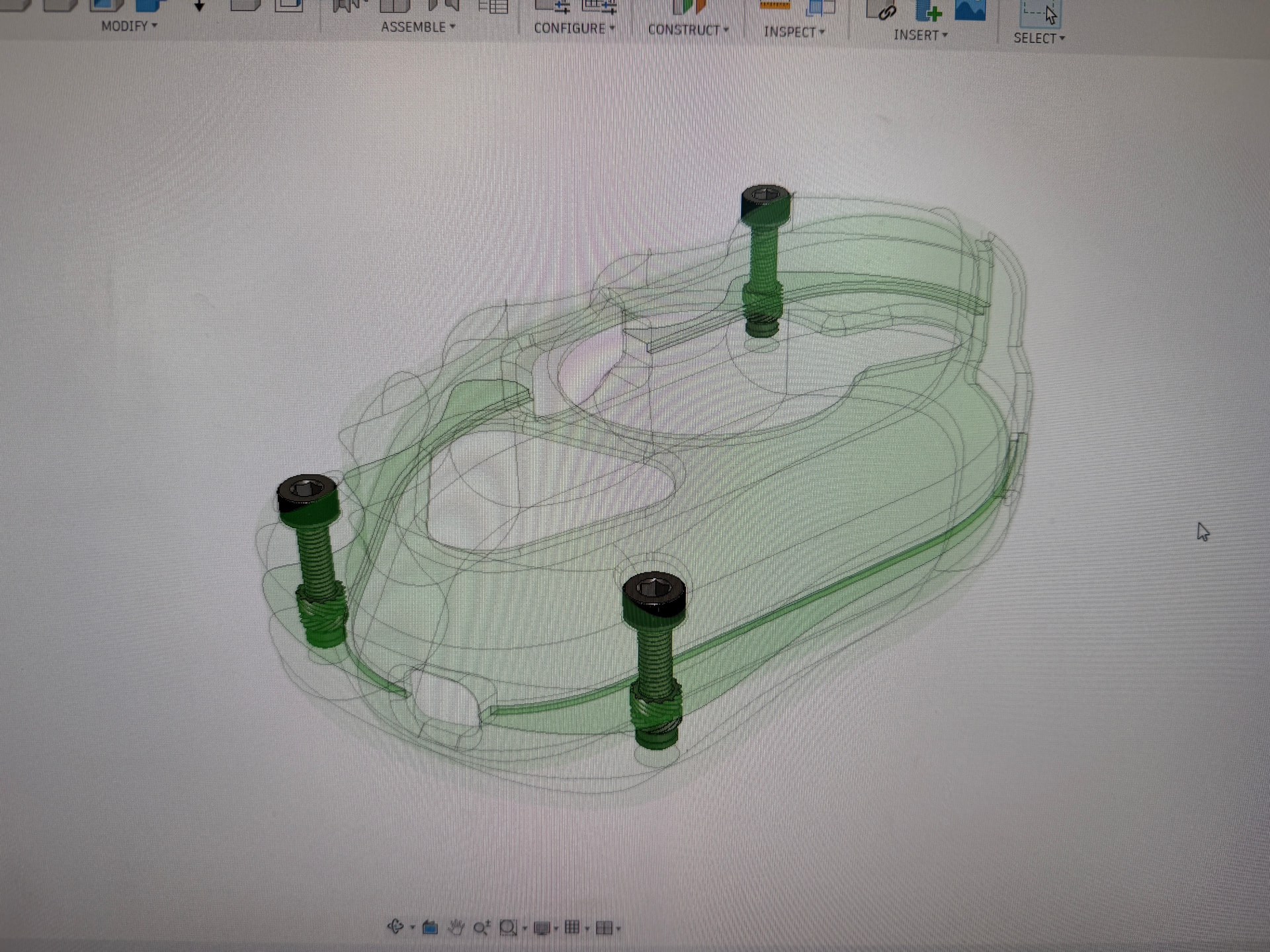

TLDR, Do you have the step files posted? I’d love to try turn that fillet into a chamfer
Yes there are step files on my Printables link on the first post. Definitely have at it!

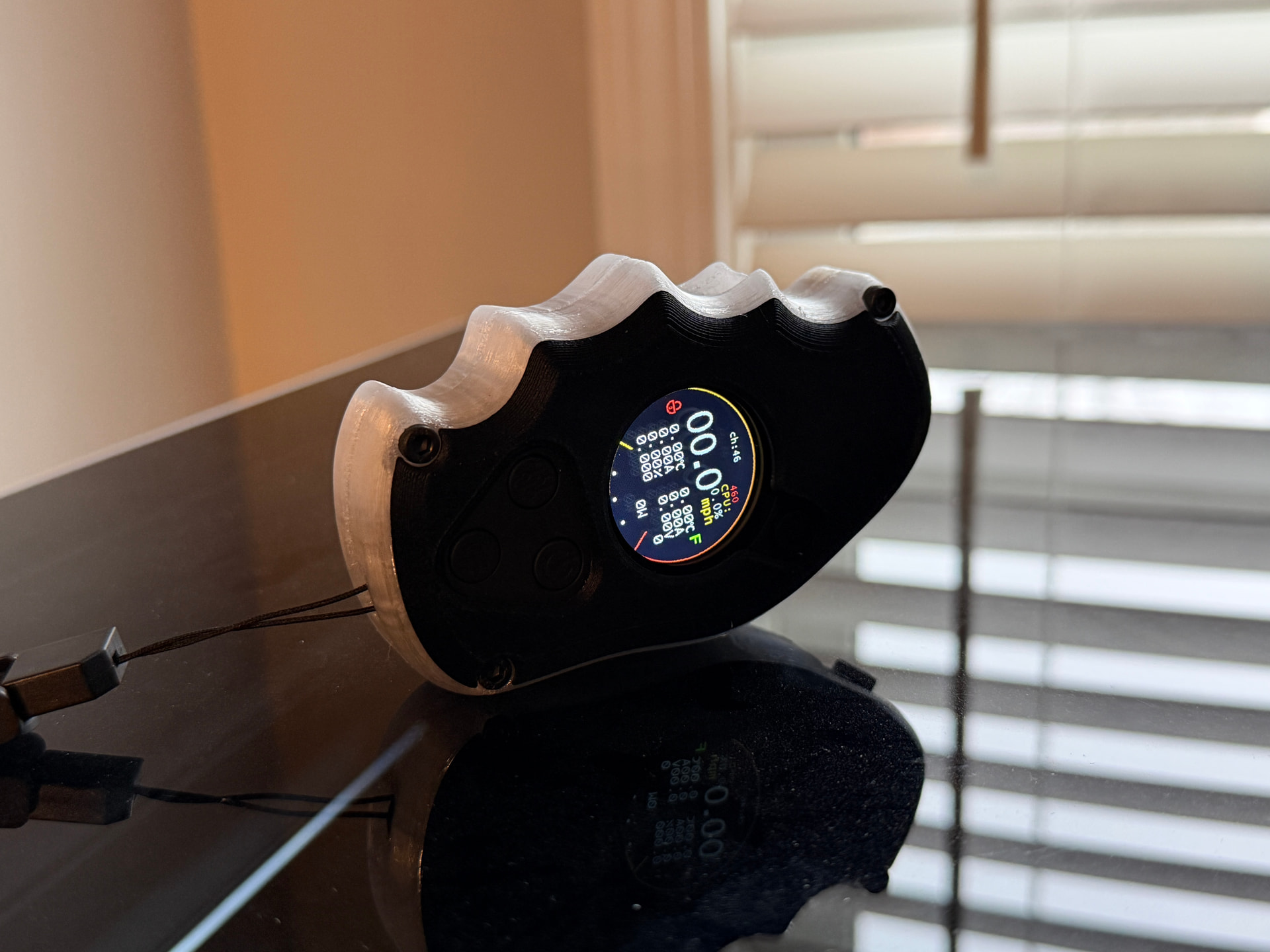

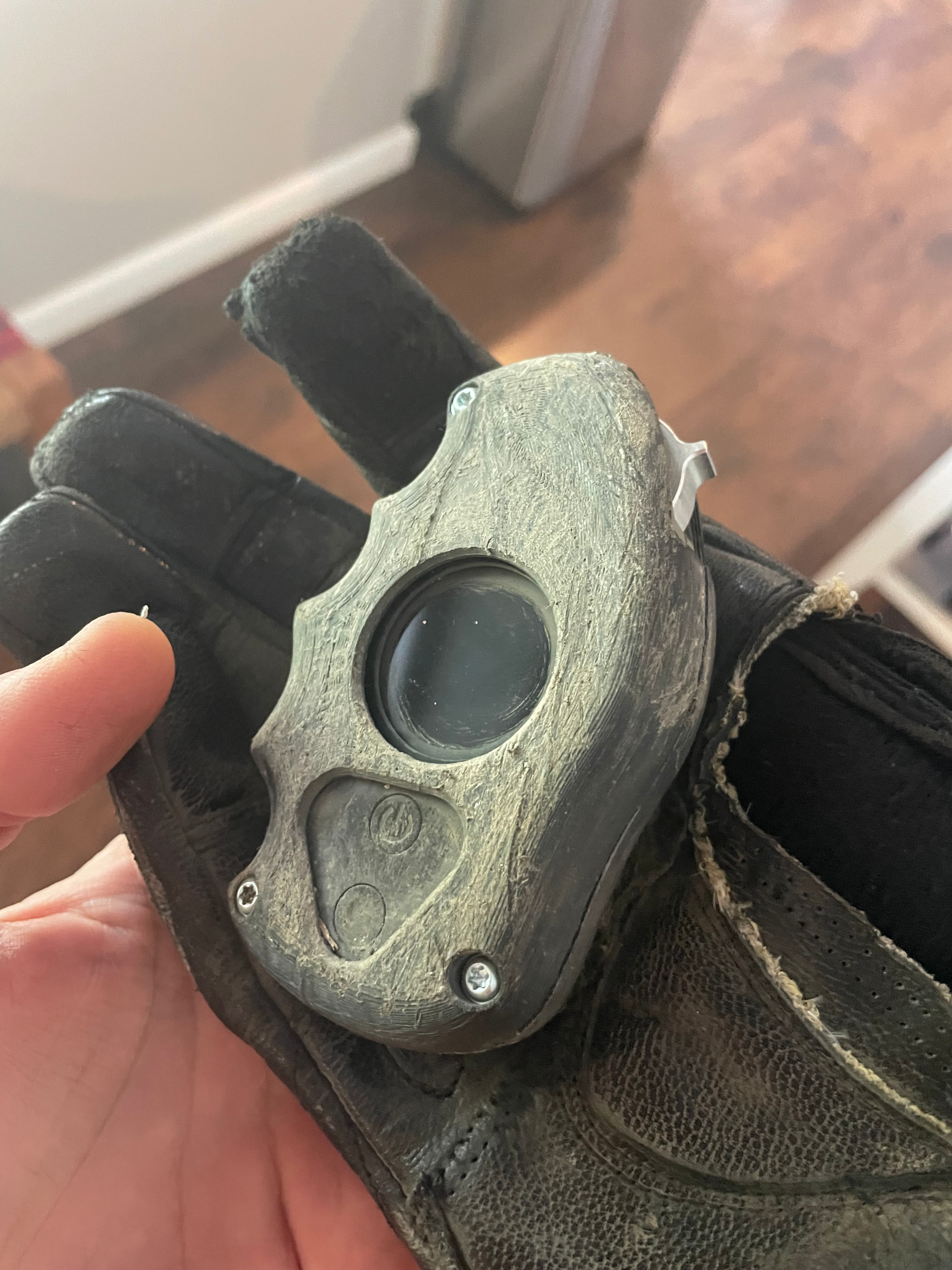

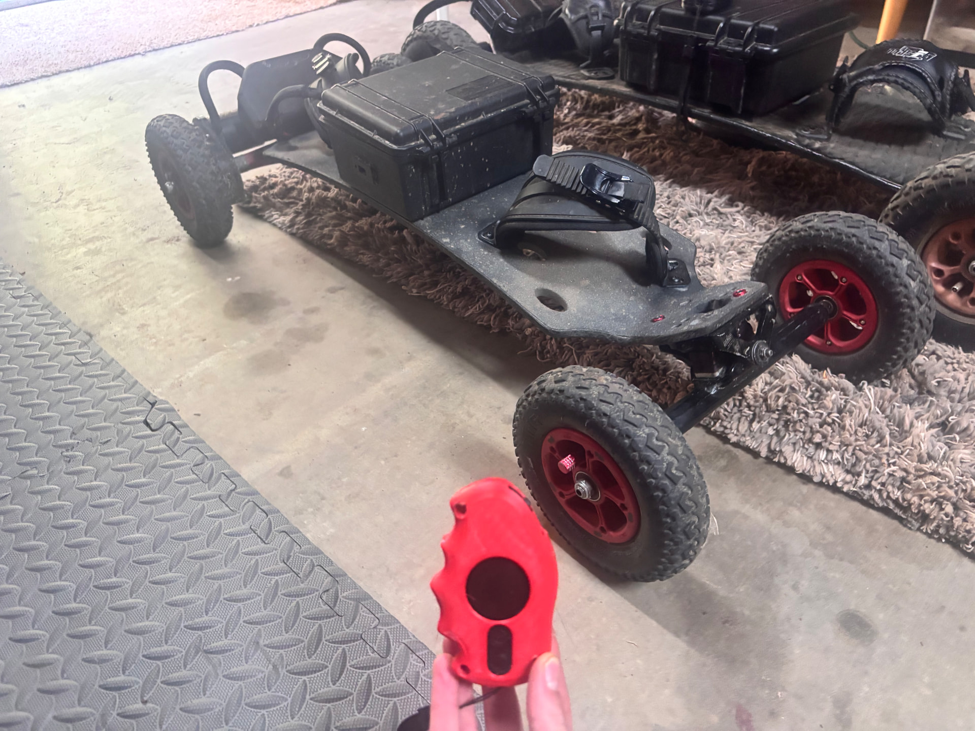

Thanks for the file! Feels awesome and looks awesome :call_me_hand:
Mark that up as one saved remote so far. First stack with the new case. Plastic screen that protects lcd shattered but have extra one I can steal from other dead unit.
Glad to see it’s able to withstand a bit of abuse!

Not yet, been meaning to but just been super busy. I’m going to try at a 45° like that again but flip them around so the outsides of the case are facing upwards
