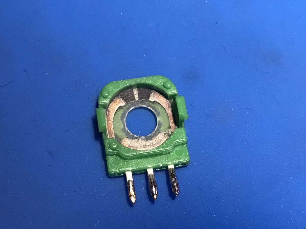

Okay, inside the potentiometer:
There’s clearly some deposits there…
Also a ride after resoldering receiver:
Power hesitations still exactly there. I pushed the throttle to a fixed position and it spiked up after every single time

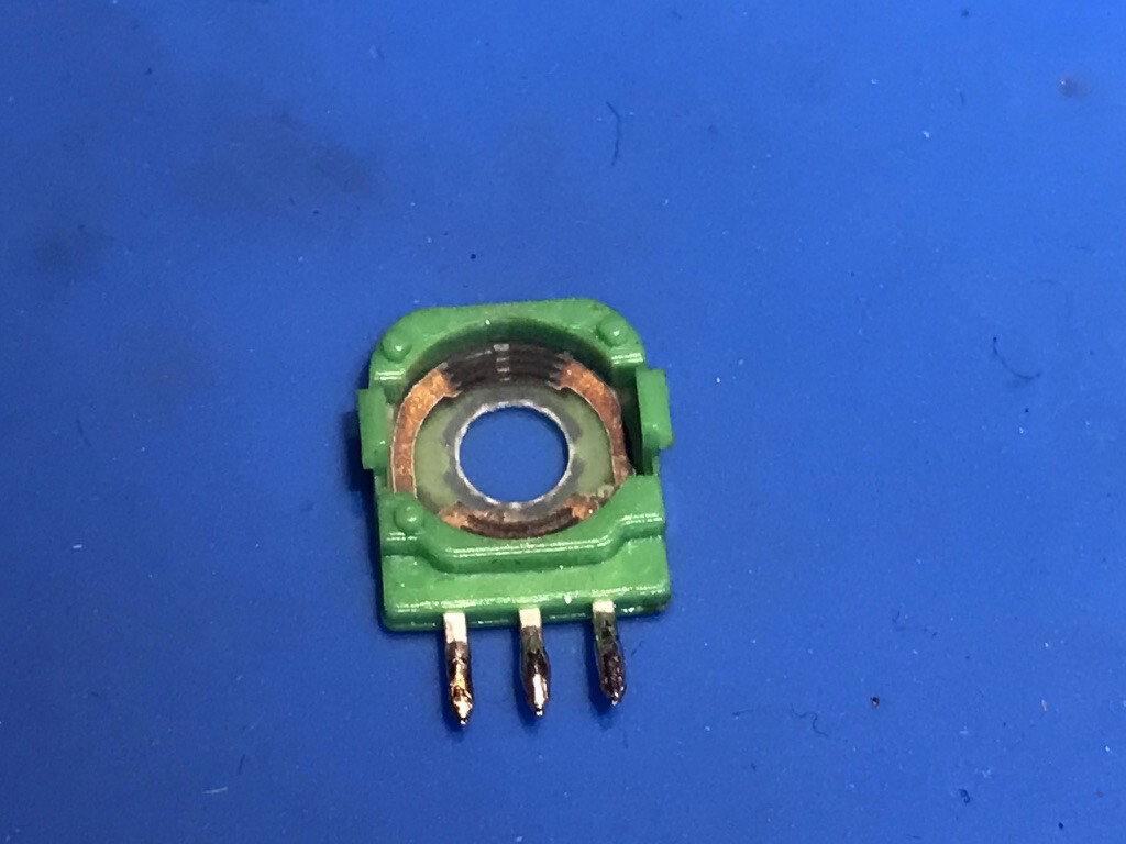

Fixed!
A bath in wd40 spray on the green thing, dry paper (the good shit not the kind that leaves flakes), everything put back together and hesitations are gone.

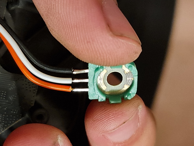

I just fixed 2 remotes with problems.
they wires hadn’t failed but I repaired them anyway.
they had the dirty pots though:
that dinky little potentiometer kinda scares me now that I looked at it up close.

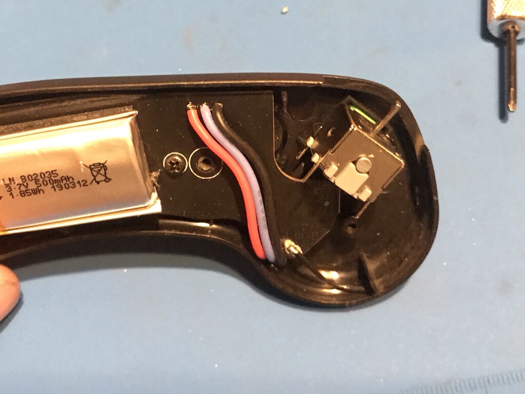

one of them:

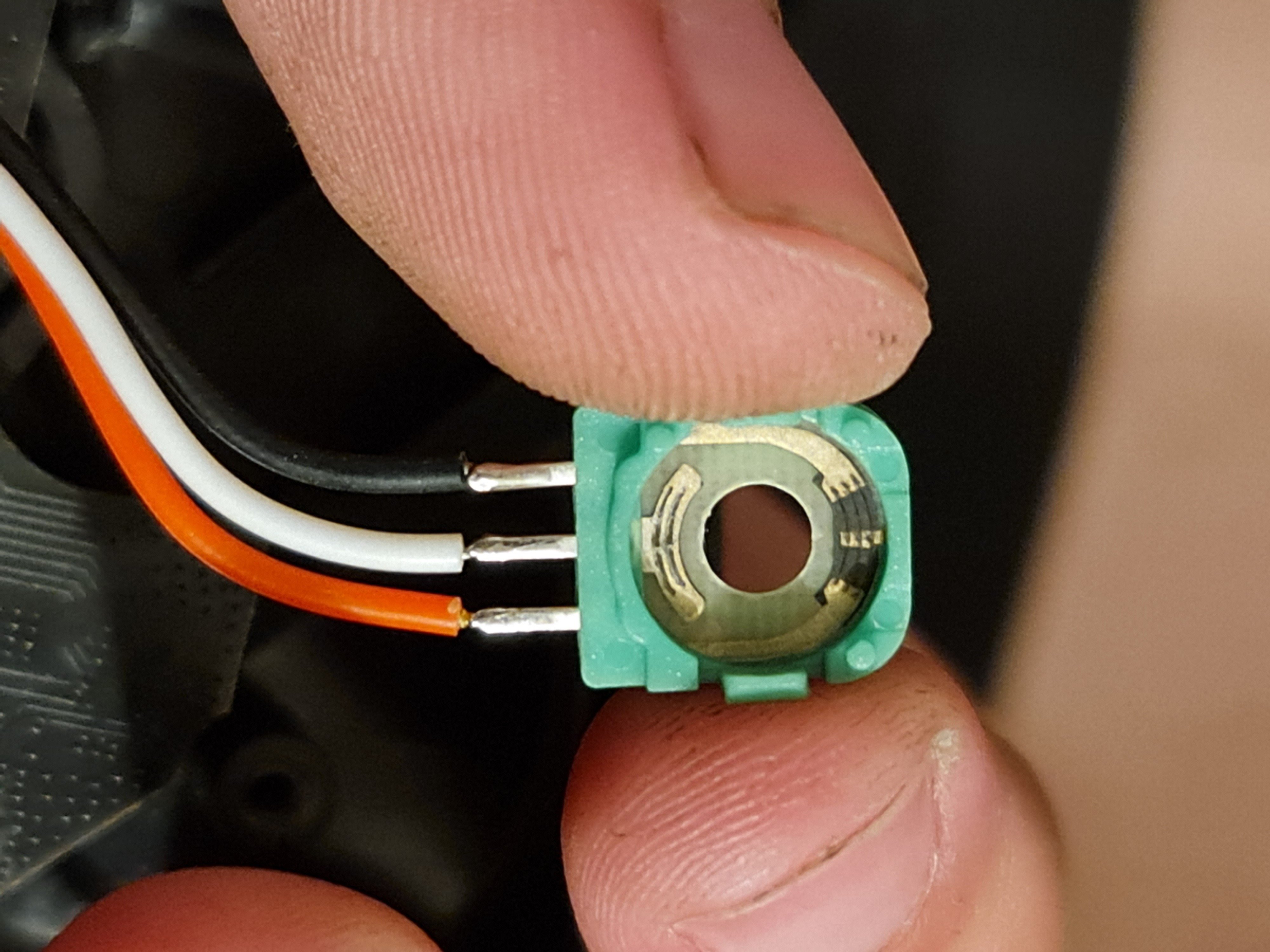

before
after
not really sure this is worth doing. probably worth buying new remotes or pots.
