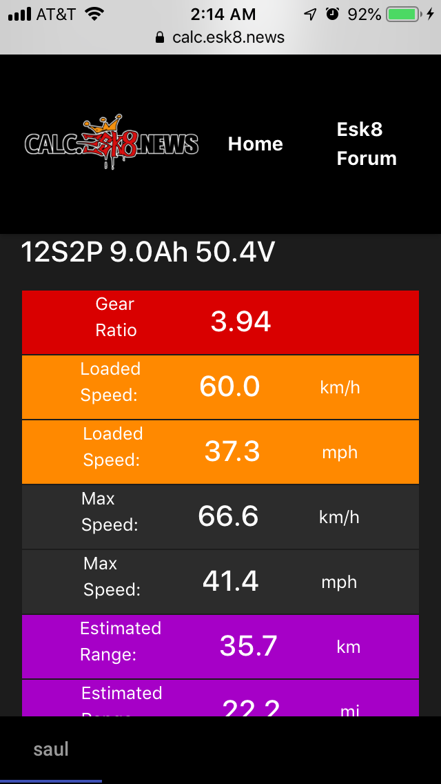

I just bought a dual mini to replace my bad 6.6 simply.
Running lipos. 4x 4.5mah 25-50c rigged 12s2p
Maytech 6374 190kv x2.
What settings should I start with? I just took it out for the first time and she’s fast AF! Breaks are way too sensitive and the throttle needs to be eased out a bit.
The simple solution is to turn down the amperage of both acceleration and braking.
Other than that, messing with throttle curves could achieve it but is more of a pain to deal with imo.
