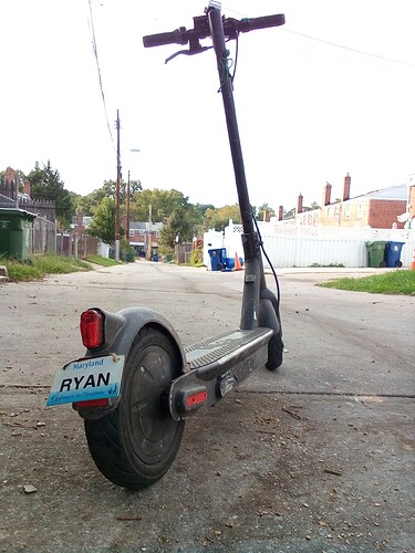

Cool tag though! Ive been tinkering with ESP32s and addressable LEDs for mine. This is a super easy to install and use app for ws1218b type LEDS its called WLED https://kno.wled.ge/… can be used for SOOO much.

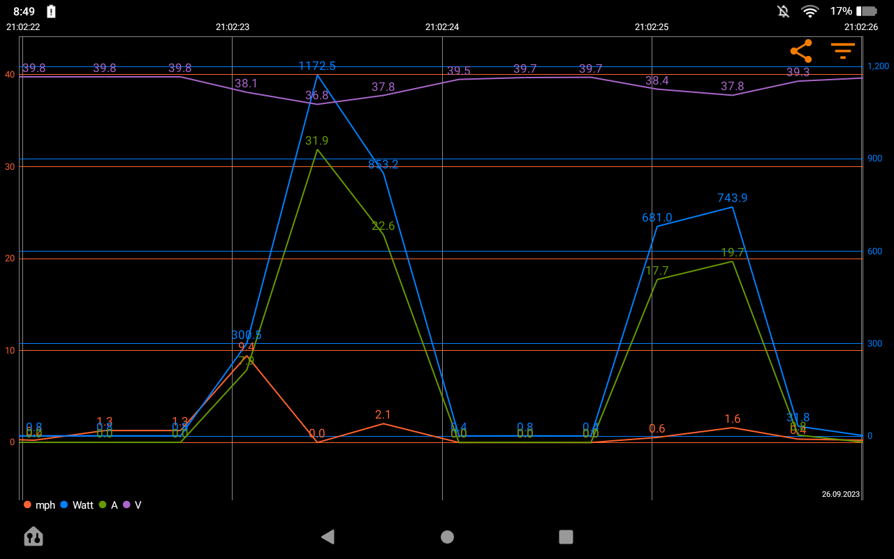

I’m getting even better results now. 20s 55mph flatland, no wind, no drafting tractor trailers, no holding bumpers. Lol!

Are you still using the OG 75/100? What voltage, what cells, how many cells in parallel, how are the cells condition(IR)…

hall sensors aren’t necessary since the hub motors have such a strong BEMF signal. I actually now just set openloop ERPM at 25. Sounds crazy because I guess I could technically use open loop all the way down to 0 but whatever, 25 works great… I also increases VSS voltage to around 35-40…
Other setting are MANY compared to what I get right after FOC Wizard. Ill have to screen shot you them in DM. One potential issue the though your motor is very similar to mine I don’t think things will transfer directly over, but probably get you in the right direction. Cant say this for sure because Ive only tried 13s with both the NB max and the B3. Same exact battery, and controller, just swapped from on scooter to another. What ran great on the Bird ran like crap on the NBmax. Only diff was the motor. Stator on NB motor had a 5mm larger diam but 5mm less height (or laminations stack) than the B3 motor. I also am fairly certain that the B3 motor has more copper per turn…Basically, it can carry more current without as much resistance / heating. But still, depending on yiur voltage right now I feel much more power is possible for you.
Don’t feel bad. It took me a long freaking time to finally get my motor working as well as it is now. Id consider myself well-versed with BLDC motors and controllers, lithium batteries, etc. My electrical and mechanical skills are probably much better than average as well but still, it took me a crapload of persistence and motivation to get things running as they are now. VESC info is out there but it’s hard to find some key settings specifically for scooter hub motors. I had no prob getting VESC to run better than even the best FW mod with stock controllers. For many they probably would have been happy with VESC setting after a tune using the FOC wizard but I had a feeling there was much more potential possible than I was getting. For a while, I was stuck right around where you are right now, 1500W and 25-33mph but little by little improvements were made, sometimes I found a tweak that made a huge difference but they all seemed to happen very recently.
Even though the motor is running unbelievably. Powerful, Insane acceleration with unbelievably smooth, totally silent commutation. Puts a smile on my face every time. But… as incredible as the performance is I think I could get even more performance with some tweaks.
