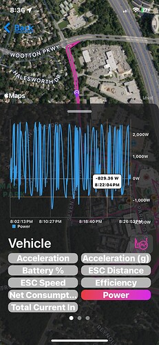

On a more serious note, here’s last night’s ride. I’m back in Wilmington NC. Totally flat here. No hills.
Notice the arrow symbol next to the top speed and total distance… This means it’s measured with GPS vs using wheel diameter for speed calculations.

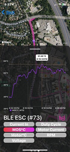

Dunning with 16s6p right now. For the first time I’m satisfied. Running perfectly smooth with no cogging, desyncs, or ABS overcurrent.
I’ve only experienced thermal throttle once after 6 miles of full throttle during a hot 95F weather.
Shows the MOSFET temp rise to the point of thermal throttling.
During installation I did not try to place the controller anywhere where cooling could happen more efficiently.
The controller is basically in a dead space with no airflow. Unlike previous controllers I did not thermal epoxy its heatsink against the scooters aluminum body in an attempt to create an even bigger heatsink. Even though I’m not going to ride WOT on 95F days I might still try to do the same with the 75/100 pro.
