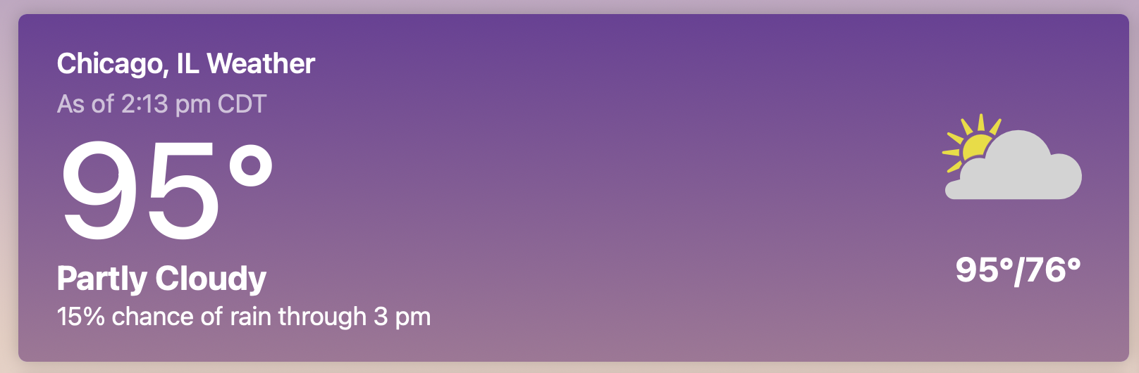

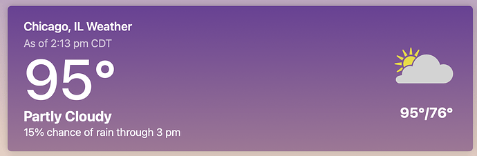

Well, at least it’s a good day to test these motors out lol
So that heat somehow turned into a thunderstorm and the ride was cancelled but I did go out before the rain started and ripped pretty hard for about 1.5 miles (constant braking, full throttle acceleration).
