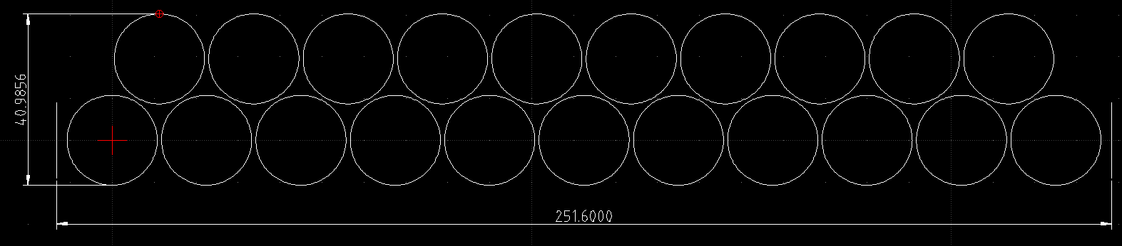

i’ll draw the outline for the pack structure, as it adds a little bit. The corners might be too tight.
EDIT: here’s pack’s mechanical outline

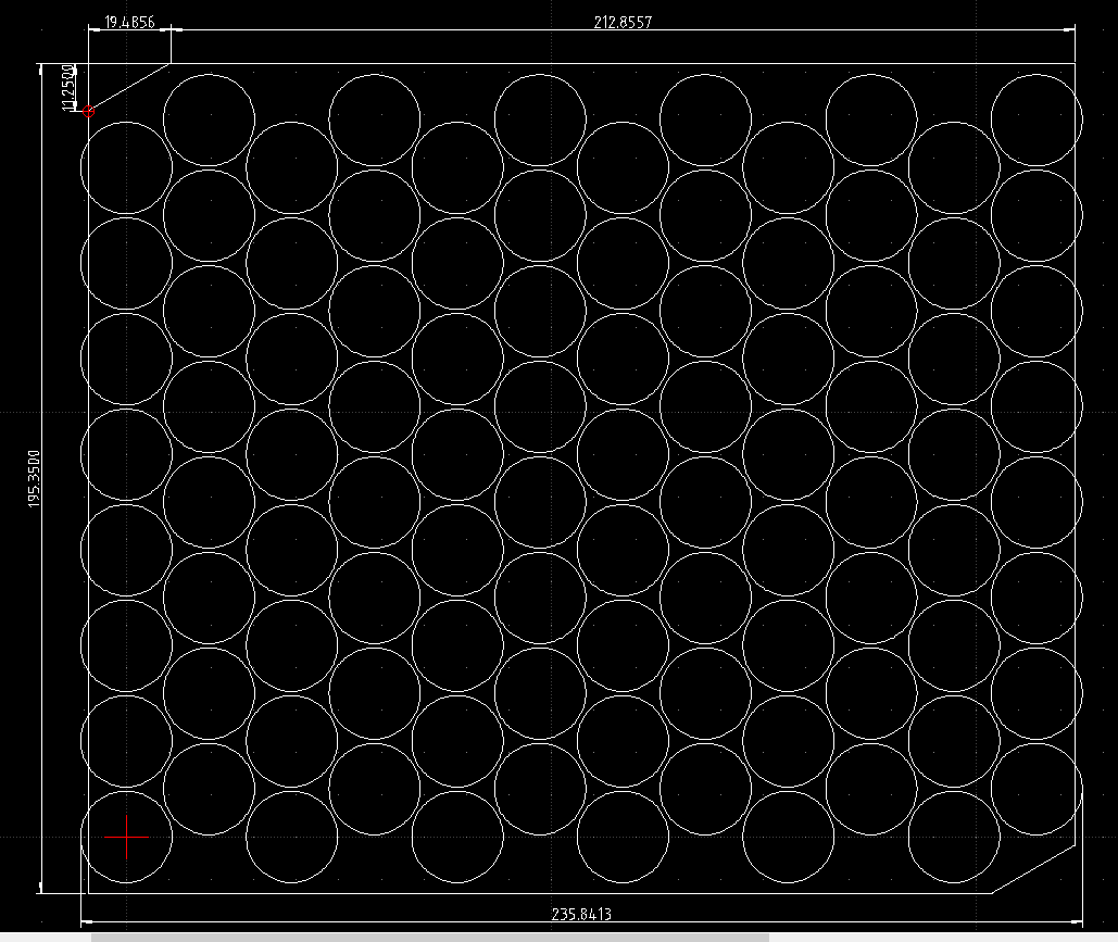

I’m building a 16s4p brick pack already so I am not sure if I would see the point in 16s5p haha - lemme know if 6p can’t fit
You have the case. I have marked the outmost outline from the pack and the cells. Check if the corners are gonna be too tight.
I’ll overlay it onto my CAD in a bit to check 236 x 196 with corners cut

Did you check if the 16S6P would fit?

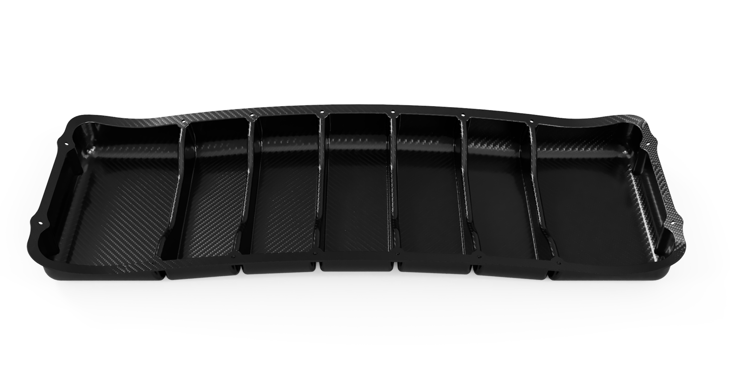

If I’m not too late to the party, I’d be interested in the development of an underslung pack, staggered. The 5 middle compartments are designed to take a 3s7p (21700) each. They should have the extra room needed for your design.

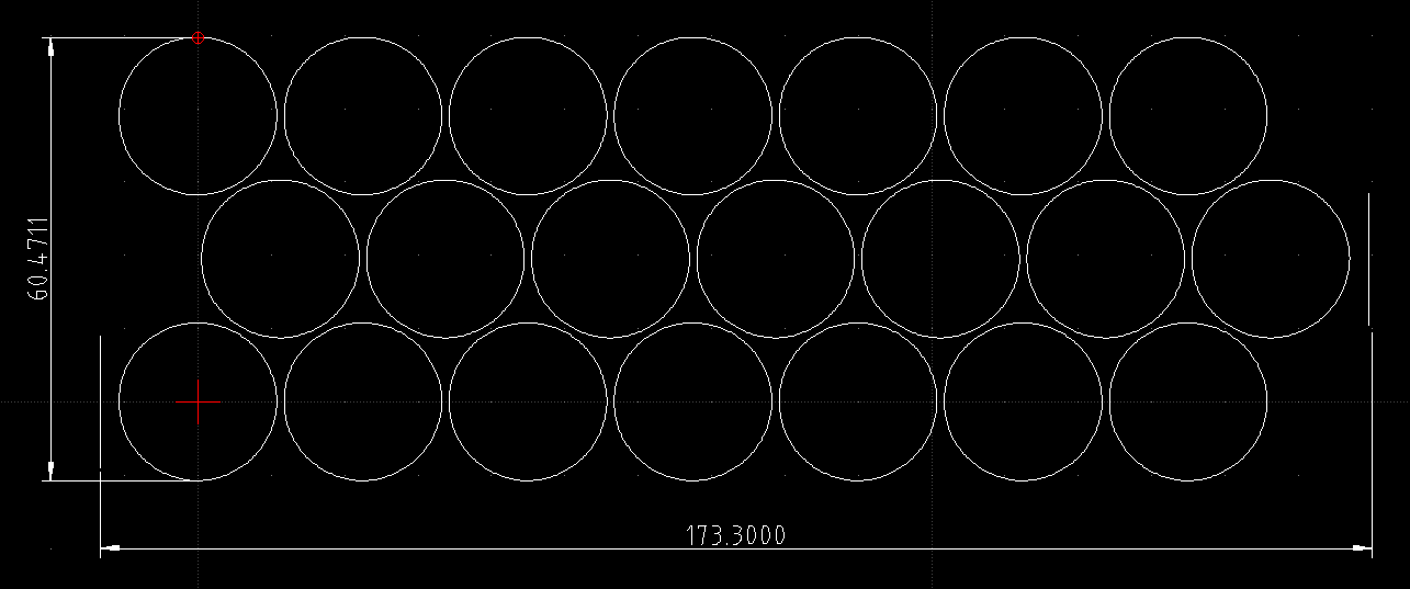

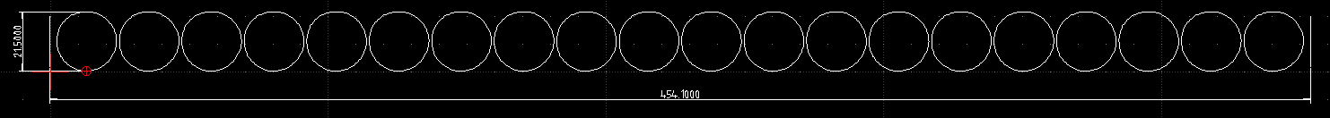

3S7P (21 cells), staggered in 2 layers like so? Outermost dimensions marked.
or in 3 layers?
In two layers, the longer layer being at the top,

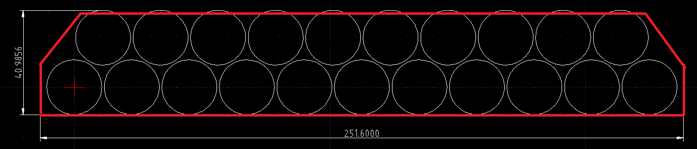

Are those the exact dimensions you require?
The enclosure has a 60degree angle,
Yes. But the end well also be wedged on the PCB, so it might still fit.
Probably not. It’s, marketed as a single stack enclosure with enough room to for 21700s and some padding. With some fancy gasketry I may be able to get a staggered stack in there but I’d want someone else to chine in on doing that with a switchblade enclosure.
With fasteners around the lip, plus some other magic that shouldn’t interfere with the internals. But as I stated, some space may be able to be created to give the enclosure more depth.

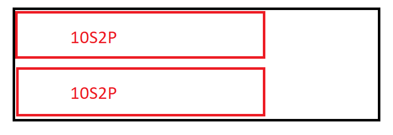

Sorry for the delay! Busy weekend. I was able to confirm that it will fit in my pack :slight_smile:
2 segments of 10S2P connected in series for the 20S total should fit.
