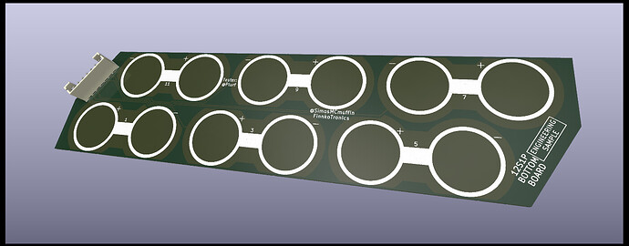

There is a JST-PH ready place on the PCBs to just plug in a balance wire harness.
Although that being said, due to your pack being in a single file there isn’t any place/gap/corner where I could sneak the connector into and also running the traces to connect to the correct S-groups (at least for these initial 2-layer test PCBs).
In your pack’s case I would solder the balance wires directly to the PCBs themselves.
40A is no problem, and the 60A burst should be fine as long as it’s <10s
I see this, and I’m wondering if the JST could be right angle to make the plugs not stick out at much? Or have the JST face into the cells so it doesn’t stick out of the module? Or maybe I’m seeing it wrong.
One 1 balance wire would be needed per 2 cells. Would a discreet solder tab be able to be made so I don’t need to solder where the cells need to sit?

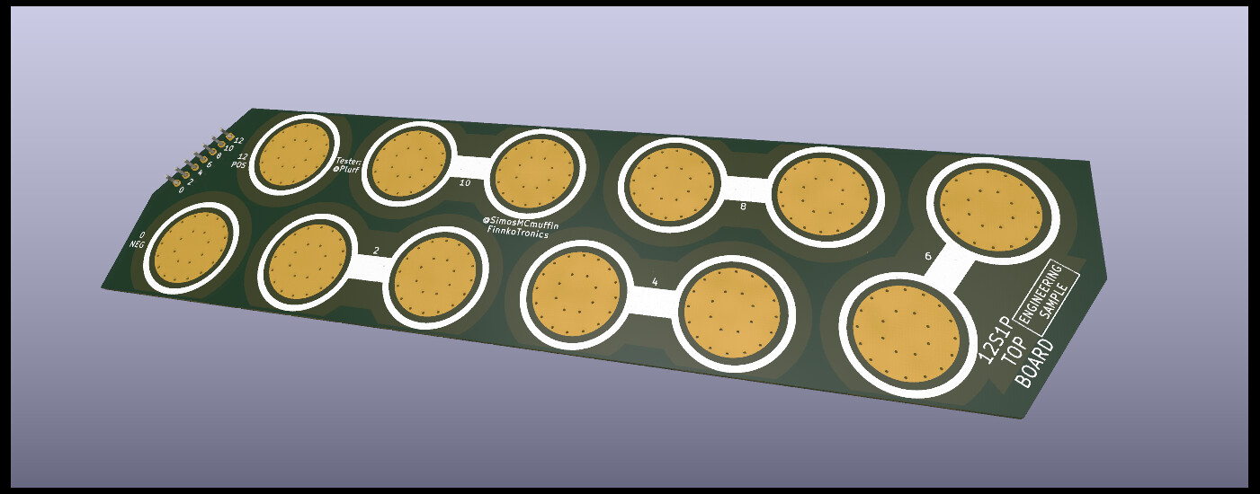

And for arrangement, so you think I could fit this using 2x PCB mount sets for 2x 10s2p modules, then series the modules for 20s2p? Obviously balance wires set appropriately.
I believe that’s the case. Would be pretty silly otherwise
Yes it does
The JST-PH connector are pointing “inwards” towards each other when the pack is assembled. Of course the end user has the ultimate decision on how they want to mount them.
There are discreet solder terminals available at every cell’s terminals.

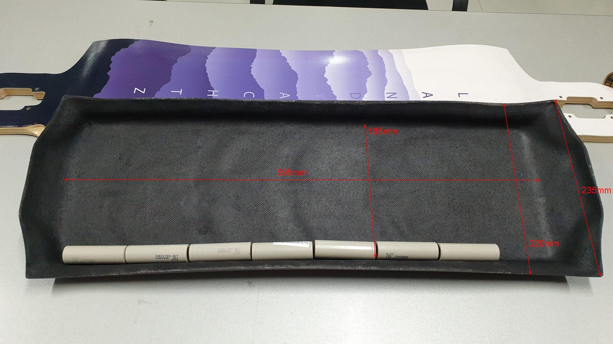

Based on this picture, the provided measurement and the 7 cells at the bottom.
The 7 cells back-to-back as shown is at minimum 7*70mm = 490mm in length. The single 10S2P straight pack is ~454mm long, so it’s less than what the 7 cells in the image use, so that direction should be okay.
The marked width of the enclosure is 185mm, the packs are 76mm in length (in cell’s length direction), so with a 10mm free space between the 2 long segments should need 2*76mm + 10mm = 162mm, which should also fit no problem and leave good space for wiring and vibration damping material.
Everything should fit ok. You want to move forward with this design?

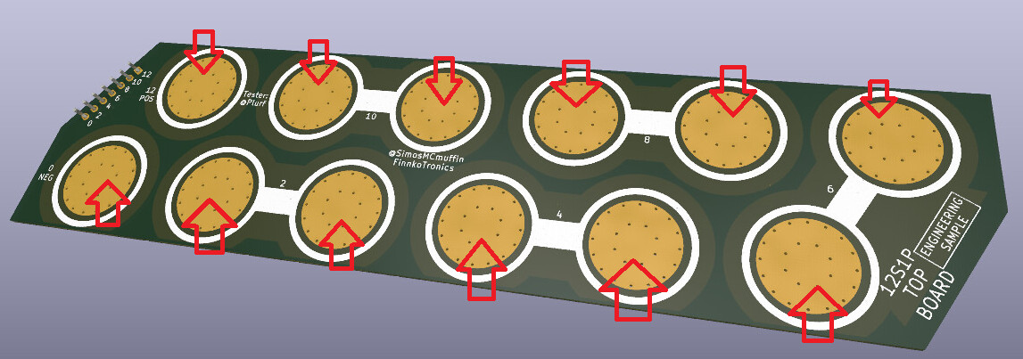

Update.
Based on feedback from @rusins and @Plurf field testing, the current design, doesn’t work adequately with shorter cells, which they are using (Molicel P42As, around ~70.0mm from terminal to terminal) and is getting too tight with longers cells like when I tested with Samsung 50Es, which are about ~70.6mm in length.
They have reported arcing, meaning that under higher vibration use, the cells are able to bounce around too much and break the contact with the PCB side contact, which causes an arc. And this then slowly causes the contact quality to degrade over time as more arcs occurs.
I’m working on new iteration of the design and I’m in contact with a chinese fab to get a fully custom spring contact made for this use. I’ve designed the spring contact myself and it’s meant to solve many of the issues I have found along with the feedback from the testers. I’m keeping the finer details for now, but the contact will be made with/in a progressive stamping and the starting costs to get the tooling made will be 1.5kUsd, which I’m willing to invest, as I believe the design will work reliably once I get these problems solved.
I have offered to send free replacements with the new design to the testers, if they’re interested, once and if I get it passed through my own testing first.
I’m gonna keep cooking, as the current state is still a bit raw, so I can’t with good consciousness start selling this to customers.
