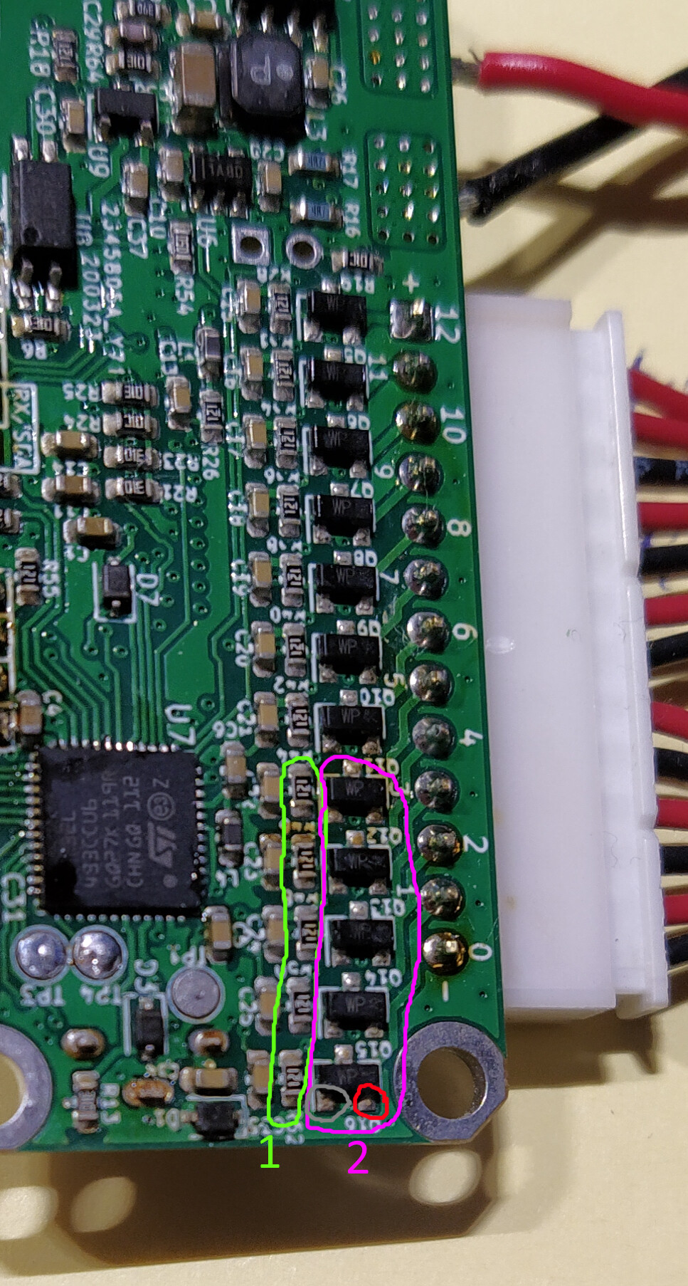

While the BMS is connected to the pack and the balance connector is also connected. Measure the voltage over the lower end bleed resistors, they should read 0V.
Un-plug the BMS (terminal & balance) and measure the resistance of the Top side 47R and the 120R resistor on the low end cell connections. Measure the resistance on the 120Rs on the bottom side of the PCB for the low end cells, on a diode voltage/testing setting measure the voltage on the bleed Fets having + probe on the edge side and the - probe on the middle side of the board should be around 2.1V.
Bleed resistors are at 0v, except 5th from the bottom, this one sits a 0.03v.
Resistors are all at their rated specs, 47 and 120 Ohm respectively.
The Fets all have 0v across the bottom 2 pins (like you have drawn) except bottom 2 ones which are currently at 0,06v and rising.
You did measure these in the diode testing mode (assuming your multimeter has it) and not in voltage measuring mode? They should show something else than 0V in diode testing mode.
I would assume that the higher cell Fets are fine, so you can use them for reference values and you can test them generally in either direction (switch probes around), but the point is that all of them should show roughly the same voltages when measured in the same direction, the voltage may change some amount when the measurement polarity is switched.
My multimeter shows ~2,1V in the aforementioned pictures orientation and ~2,6V in the reverse direction. but different multimeters may show somewhat different values, but you should use the top cell Fets for “good” reference values and then compare the bottom Fets against them.
