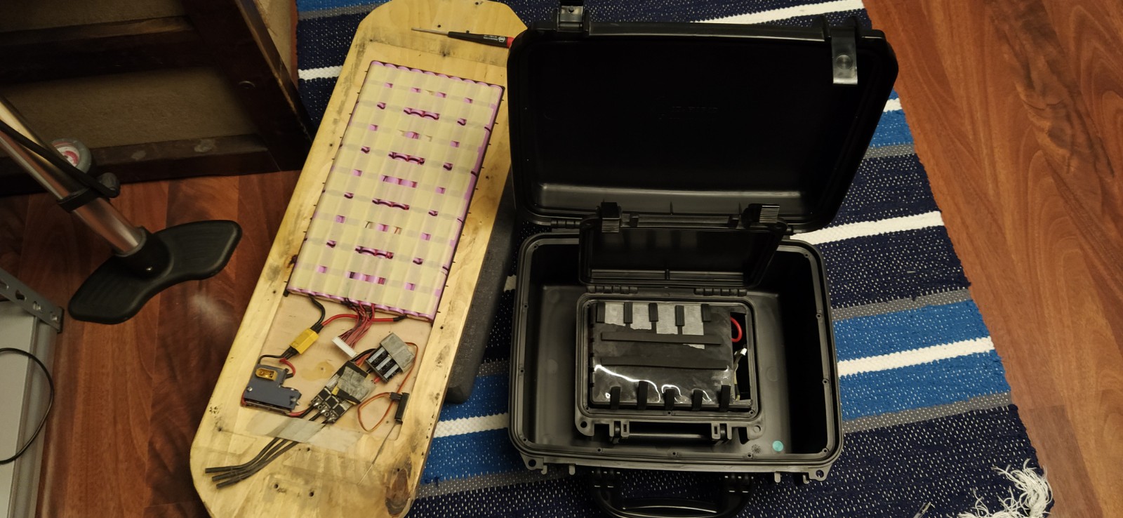

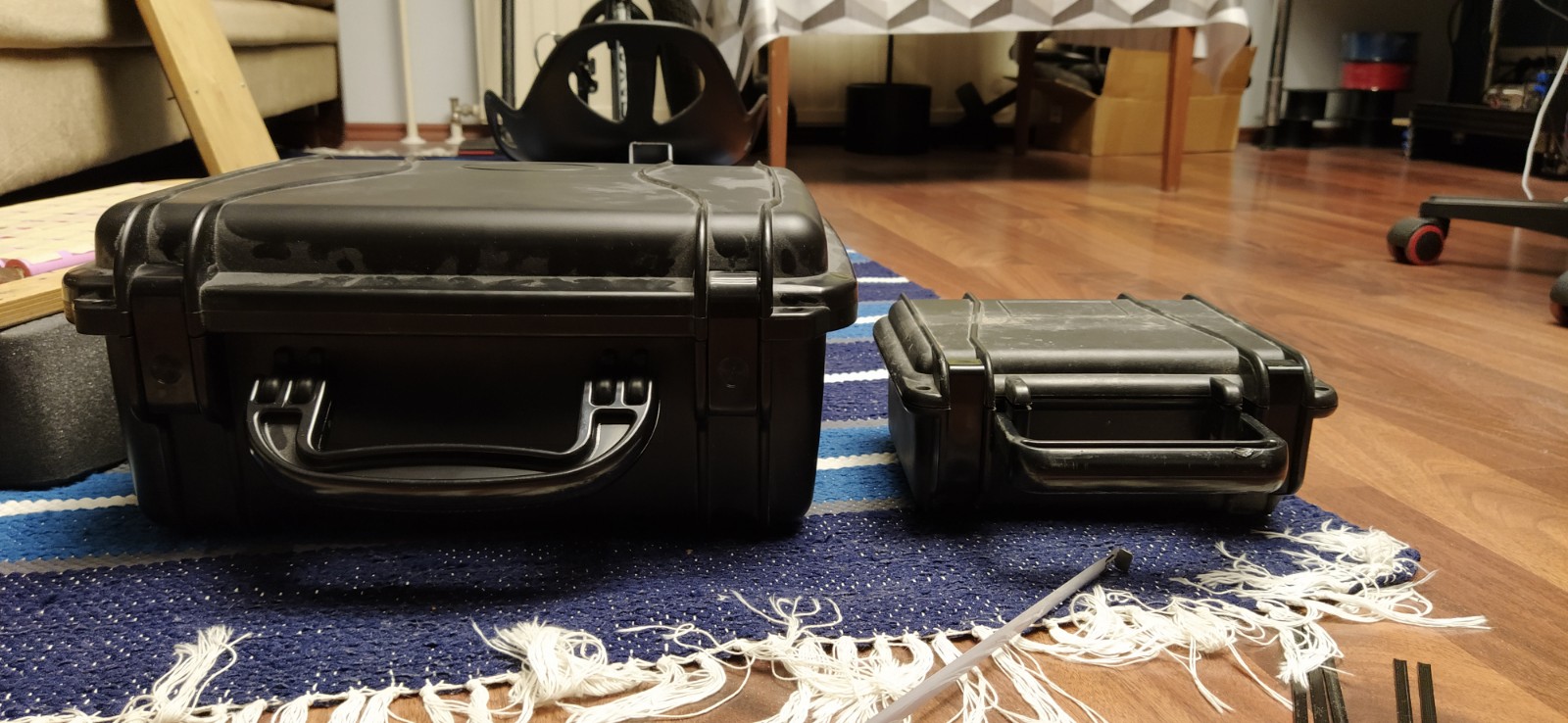

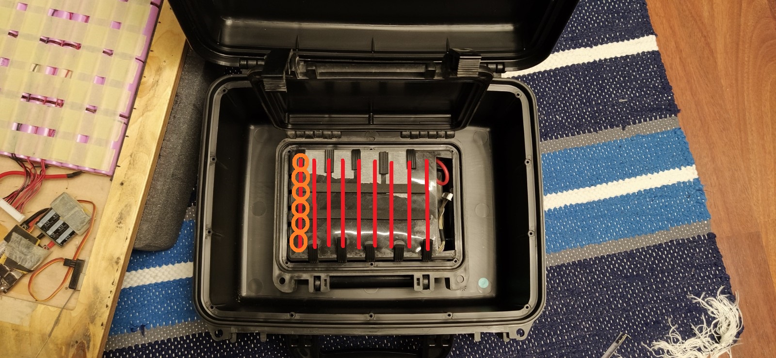

So here’s the plan in the method for the madness. Below you see my old pack, new pack enclosure and one of my old unused decks with it’s pack that I will be recovering the cells from this weekend (not necessarily for this new pack build).
My current pack is a 60 cell 10S6P of 35Es.

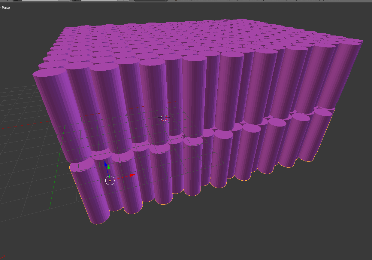

Here’s some 2D-CAD drawings that I made to figure out how many cells I can get into the new box. The bottom picture shows 18650 cells in a nice 6 identical sets of 36 parallel cells each. Above picture is for 21700 cells and it doesn’t really divide nicely into series and parallels.
Now you might wonder: “6 sets of 36 cells is just 216 cells? You were talking about over 400 cells”. Ah you see, you can fit 2 of these 216 packs in the vertical direction in the new pack. So I can make 2 identical 6S36P packs and then series them up to 12S36P for 432 cells :sunglasses: :sunglasses: :sunglasses:

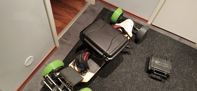

The new pack’s gonna be a bit chunky on the board, but it should fit between my legs without it interfering though. I then also use the top of it to tie down some cargo.
