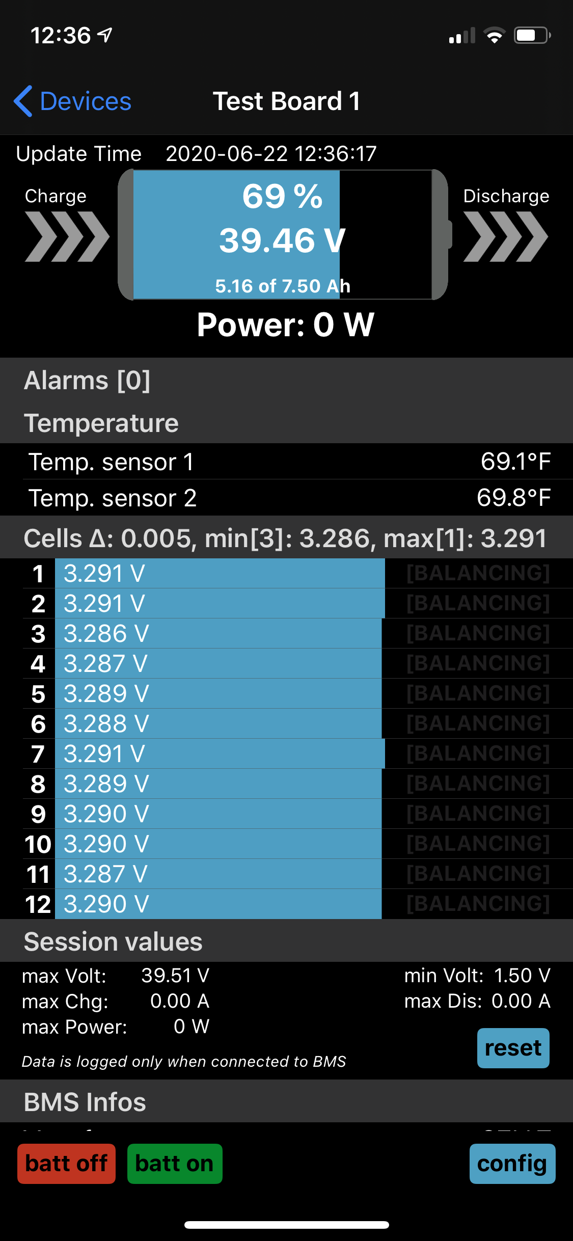

Smart BMS
We choose to use a charge only smart bms that 108mm x 65mm x 10mm thick. They are very thin and you can stack the esc’s on top of the bms.
The nice feature is you can see every cell’s voltage right on your smart phone. Also, with 2 temp sensors, you can see the temperature of the battery in 2 different places. You can see how many amps it’s charging at and which cells are being balanced, so you can see that your bms is actually doing what it should be doing, instead of operating your bms blindly.

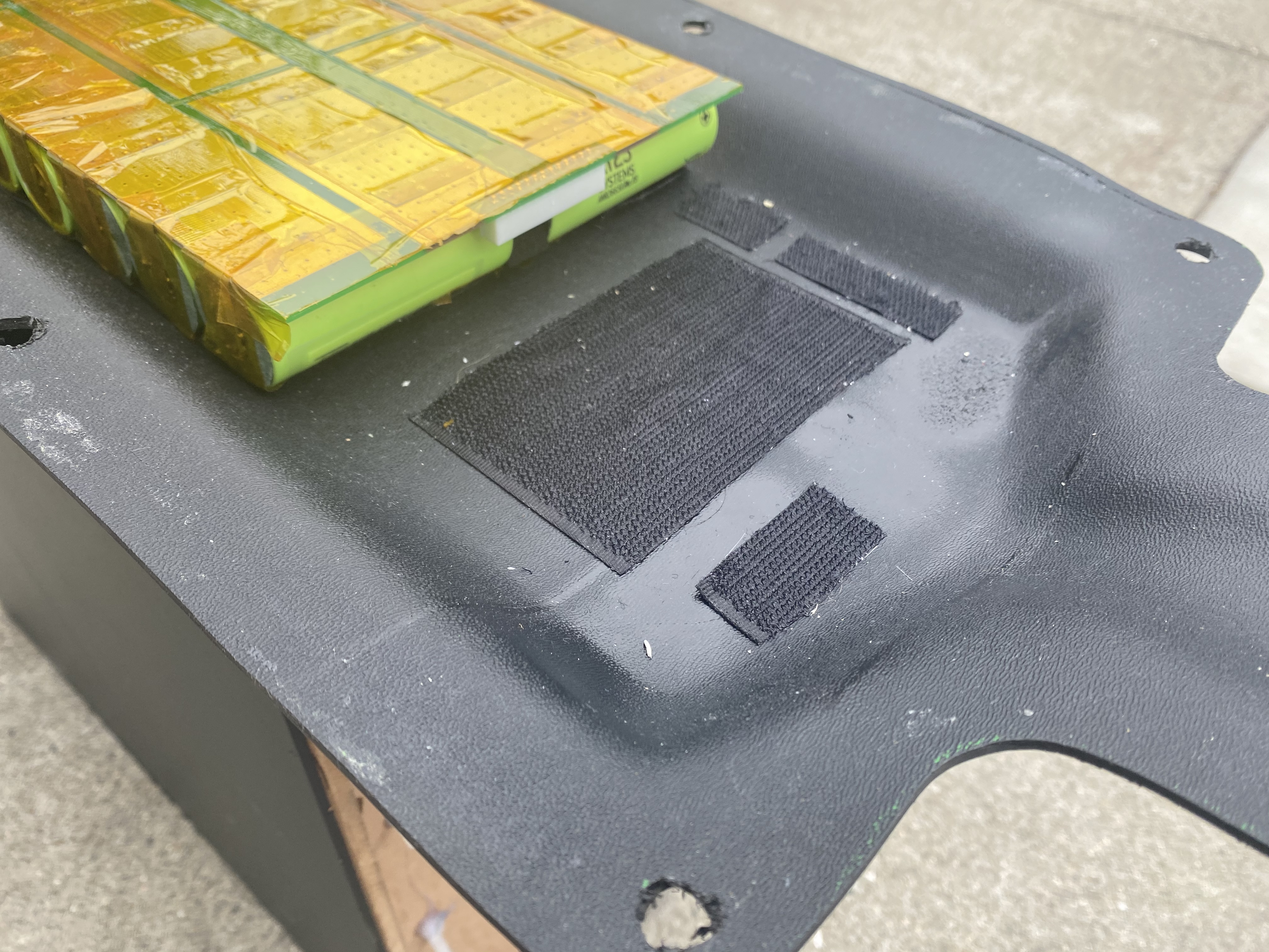

Not a whole lot of room for vescs in that enclosure huh? :sweat_smile:
I guess they could sit on the bms I’ve done that before
Yea the bms fits on top of vesc6s snuggly.
I’m in love with that @evoheyax enclosure. One of a kind. Very organic and modular with beautiful lines, not boxy like others, just the right shape and size for the @hummieee deck. Those big thick countersunk washers and hex screws are a nice touch.
Yes, the design was t have them sit on top of the bms. Official VESC 6’s are the end goal. You can fit some other esc’s, as long as they are under 20mm thick.
