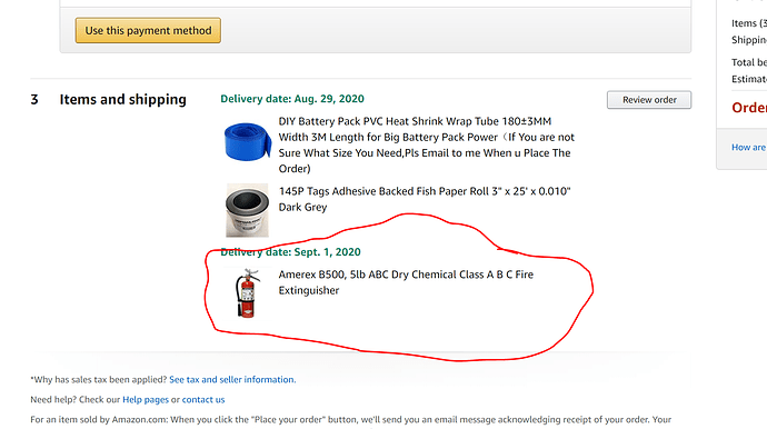

First time using spot welder, could use feedback / advice
Batteries are dangerous, if you fuck up and start a fire you are in for a bad time. You can have 10 thousand good welds and still burn down your house on the next one…
Your groupings are very hard to see but they seem okayish for the positive side so I doubt you are in immanent danger of welding the shoulder, you at least have insulator rings but I seriously hope you will have a layer to protect the positive network from shorting out on the can. Also do some more practice welds, they look you are not applying enough pressure, you can tell by how small the weld point is yet the entire area is baked. And 100% round the corners
In general you are on the right track though, but just be careful
Also don’t mind kook right now, I think it’s just one of those days
can you please describe what you mean by this? I plan to apply regular shrink wrap to completely cover the parallel groups before i string them together. do i need something besides the insulator rings before i weld the nickel?
the nickel that overhangs everywhere could get bent down and short a cell out.
The entire body of each cell excluding the positive button, is electrically connected to the negative electrode.
That means any contact between the positive-side nickel and the cell body is equivalent to a direct positive-negative short circuit, AKA a Very Bad Thing.
Anywhere you have a conductor that isn’t connected to the negative, anywhere near, touching, almost-touching or could-touch, you need something to insulate between them and prevent shorts.
The cell wrapper and “regular heat shrink” aren’t heat- or abrasion-resistant enough for that job alone.
You need either fish paper, or polyimide sheet, or some other tough, heat and abrasion resistant material.

My plan for the nickel that overhangs is to first wrap the groups, then bend that down intentionally to use as a place to solder on string conductors. But it seems like that’s not a good idea. How am i supposed to string the groups in series?
Dig through the previously-linked battery threads. Tons of examples of very clean, safe, proven methods.
I cannot stress enough: Read lots. Then, read more. Ask questions, and when the answer is to go read read X thread or post or tutorial, go read it. There’s a lot of information available here on the forum for first-time builders, but the onus is on you, to go seek it out and digest it.
There is no one best way, it all depends on your pack geometry and space constraints, among many other things.
It’s not the worst, but it definitely requires caution and forethought in the construction process.
At the very least, ensure that at no point along the nickel there should be no less than one (1) layer of fishpaper or equivalent, and one (1) layer of cell wrapper between it and the cell body.

This is a bad idea; the cells are already wrapped in shrink wrap anyway.
Do this, but with fishpaper. You can purcahse it at 145ptags.com if you are in the USA.
