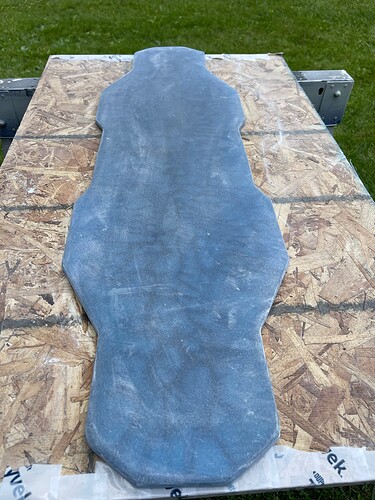

First time Build - Started today with my core
Looks sweet! Lotta weight for sure, impact resistance may be iffy. If you make sure to use peel ply on the top surface I think you’ll have an easier time making sure the glass is smooth and clear enough to see the marbled epoxy underneath :+1:
Could you add some ribs on the underside that run the length of the board?

Okay so today the core was taken out of the form. The pour turned out really nice only one little bubble. Sanding began and I’m going to shape it up by softening the edges and putting a little concave (as was recommended to me by y’all). I also completed the enclosure design and began making it out of Polycarbonate - Carbon Fiber. My battery spot welder was woefully insufficient for my .2mm pure nickel sheets so I ordered a new 12kw one and am waiting on it to show up to work on the battery more.

Okay, today I’ve been continuing to sand and shape the deck. I have the spot welding done for one side of my battery (except my BMS tabs) and then I’ll be ready to add tape, insulation, etc.

I got the first layer of CF down. I should have gotten it more wet on the edges so I’ll have to clean that up but otherwise I am pretty happy with how it turned out. It’s still pretty flexible too which is nice because I know some people had mentioned it would be way to unforgiving so that’s a happy surprise.
Alright I’m almost done with the home made deck / enclosure. Today I mated the enclosure up to the deck and made a charging port on the enclosure. Gotta add some threaded inserts to the enclosure and then make a proper lid. Then it’s cleanup and make it presentable and I’ll be ready to start installing my electronics! I suspended the board between my sawhorse and sat my fat ass up there and it didn’t snap so that’s a good start haha. Little bit of flex to it so that might become an issue I will have to contend with. I left about 10mm of space between the deck and battery so hopefully not!
