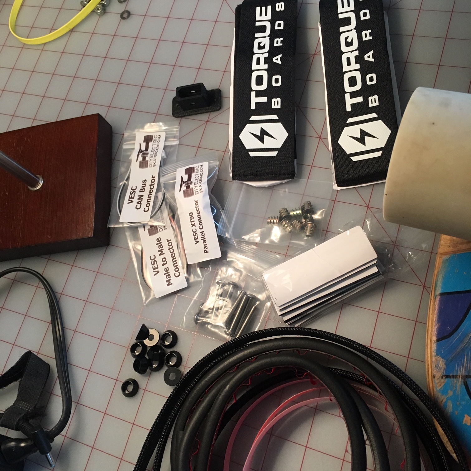

Ok, transferring this build over to this forum from the darkside! Landyachtz Osteon 38" (compliments @Skunk), TB218 + v5 mount, TB 6355/190kv dual motors, TB 12s4p + enclosure, TB 4.12 dual VESC, currently mounting 85mm caguamas with 16T motor pulleys and 36T wheel pulleys (not sure what proper ratio that is) but I’m waiting on @moon pulleys for 78mm Mach 1’s, which I will swap out when they are ready. Will be running 12mm belts for those but 15mm for the current setup with the cags. What other little things do I need to work out?? I’m a first timer so any suggestions would be lovely! TB battery is all set-up with anti-spark but considering doing a loop key. Still researching about whether I can do that for a battery that’s already set-up with anti-spark (can I do that???). Will the 12s4p work with these motors? That’s another thing I’m still researching; is that too much current for those little motors? I hope not because I already bought all the shit :joy::joy:. What else am I forgetting? I have a lot of random parts collecting already from some awesome folks on these forums, so there’s some stuff I don’t even know what it is. Like the photo of that rubber tubing with some sort of adhesive strip running along the side! Also, there are a couple concerns I’m noticing so far that I could use some input on. First, there is a bit of excess wire from the motors to the vescs in the enclosure, I’m wondering if I should just tweak the way the motors are mounted or what? Also, the mounts are like 1mm shy of touching the deck and that V5 mount eliminates the possibility of adjusting the angle (unless I’m missing something); is that potentially a problem? The battery is also very snug in that enclosure and there isn’t any padding in there yet or anything, and also the quality of the enclosure is suboptimal. Wondering if I should go a different enclosure route. Ummmm IDK, I think that’s it so far. PLEASE HELP THANK YOU I LOVE YOU ALL :black_heart::black_heart::black_heart:
What’s this rubber tubing used for?
Gasket for between enclosure and deck.
