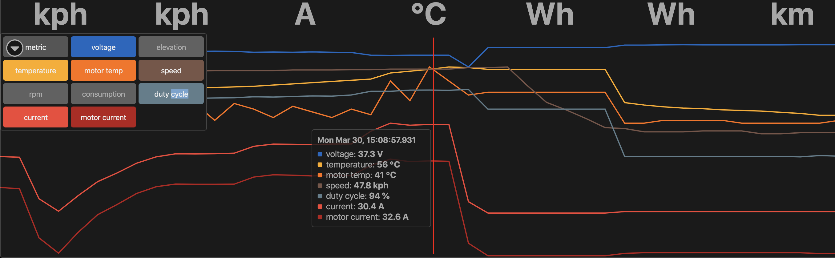

Hey guys, I was cruising today and spun out due to a little cut out TGAT threw me off the board at full speed. Had the throttle fully depressed when it happened. I managed to locate the moment it happened on my metr data below:
My board is dual maytech 6374 190KV, TB Vesc 4.12 & TB 12s4p battery. Here the build thread if anyone wants the info FIRST BUUILDD | Thing 1 |
No faults in the metr log. Anyone got any idea what the cut out is from? Happened again later when the throttle was fully depressed but it didn’t buck me off the board.

You say you had the throttle fully engaged but the metr says only 67% duty cycle
Did you forget to map/adjust you ppm remote?
Ohh shit, it’s possible that’s the issue. I swapped remotes to test a different remote and then swapped back, but did not run input set-up wizard again after pairing back to the other remote. That could be the issue.

Just before the event:
94% duty cycle
then motor and battery current drop.
then next data point duty cycle drops to 67%
then every thing but speed seems to flatline in the graph suggesting no update to the data.
then duty cycle drops to 0% and temps begin updating again.
maybe the vesc rebooted. or could just be metr disconnect causing the flatline.
though speed data point was updated in that interval. do you have metr app configured to prefer gps?
if it did reboot, then you would have lost any fault code. :frowning:
Bms could have hit its limit
