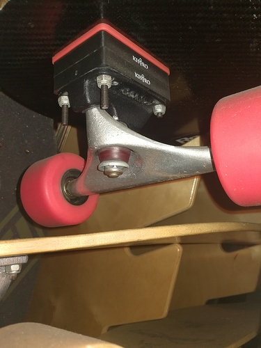

YESSSSSS!!! One of my LDP’s front truck:
Love it love it love it. But, maybe not for eskate.
