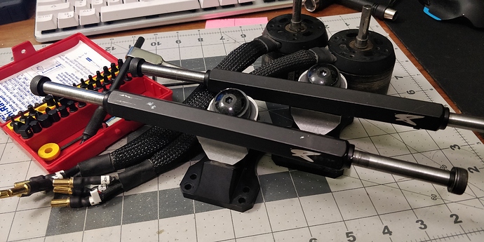

I’ve got a set of SR 177mm TKP set and mounts and dual TB 6355 190kvs that I don’t mind shipping out to the UK

What mounts do you have? And the big question… how much?

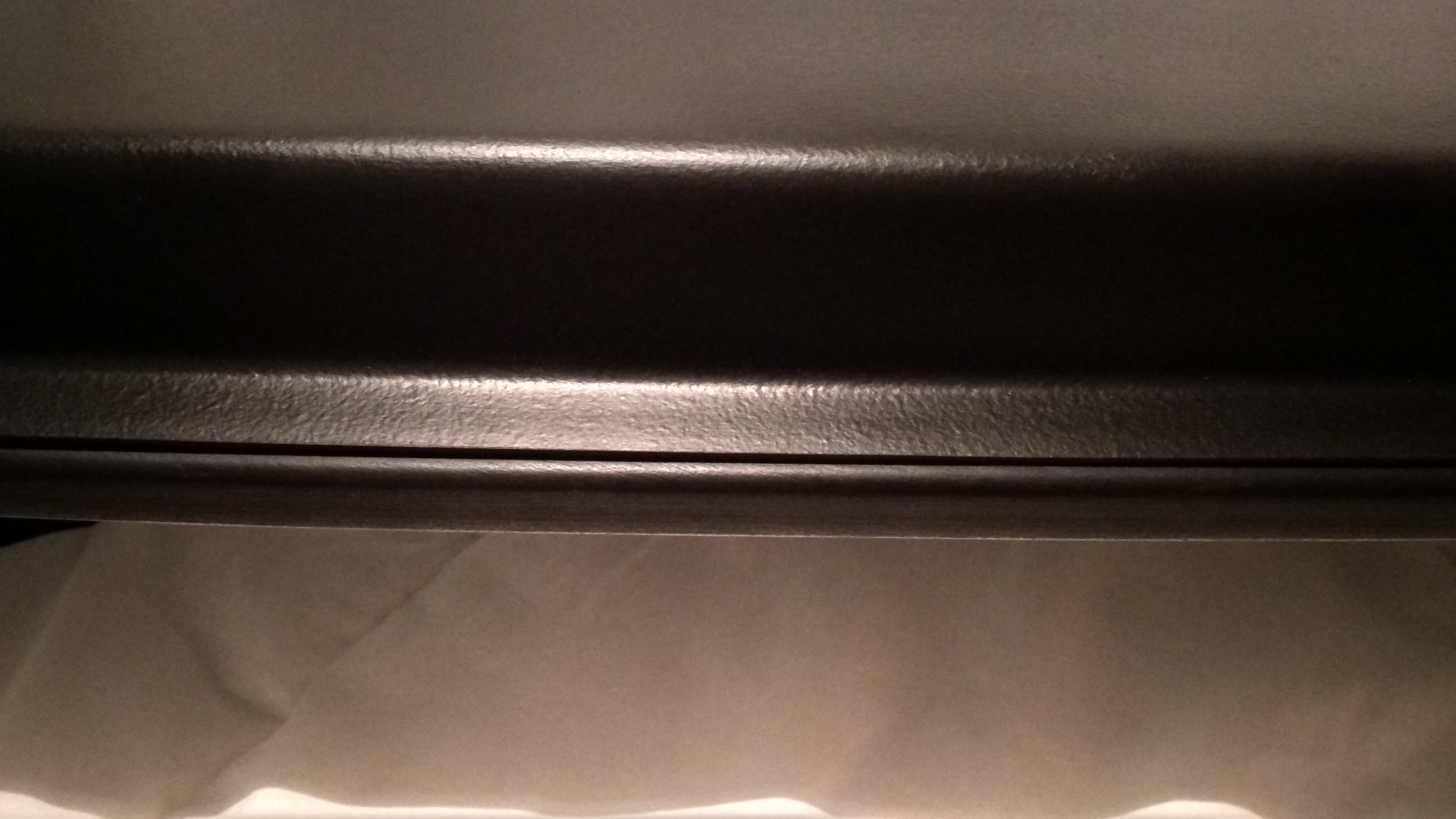

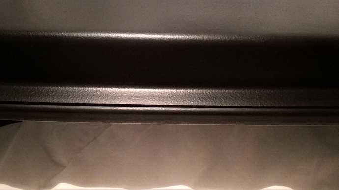

@BigBen is an enclosure master, not too pricey, based in Weymouth and is currently working on a vanguard option. I’d say thats your best bet right now!

I’ve got Psychotillers mounts (definitely scratched up a little bit) and these Whoosh mounts (brand new) that are actually quite nice.
I’m not sure how much shipping is to the UK from CA, but did you want the whole lot? Or just the trucks and mounts?

Got motor mounts for them too

Please get a @BigBen piece of art. Beautiful and enclosure too :kissing_heart:

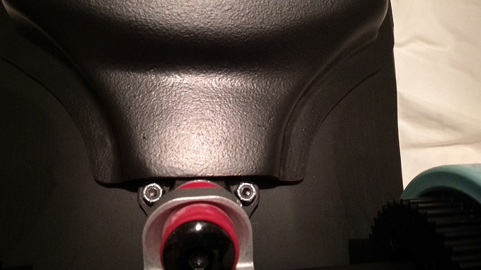

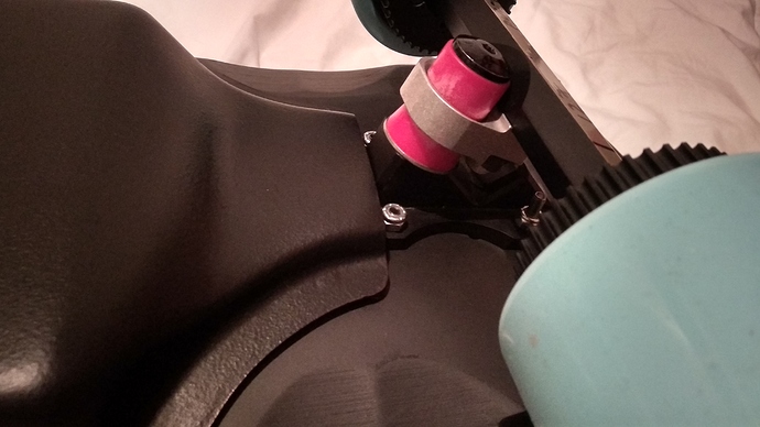

Just look at dis fit, it’s not even bolted down and just sits on the deck like a tight :dress: on a fine lady
I saw his enclosures in person the other day, I was too shy to compliment them. They look really good
Oh jeez this is the spud/tayto box?
And yes, tayto/spud
