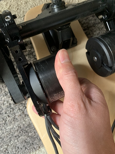

So… My first problem has surfaced. Today while I was riding, one of my motors started to make an unusual noise. My right motor is spinning freely. I can grab onto the wheel and spin the motor. Not sure what this means or how to fix. Any suggestions folks?
All the wires are connected properly?

Is your motor pulley still turning in step with the wheel?
Yes it is. I have a keyway on it and checked to make sure everything is still tight
Can you post a vid showing the difference?

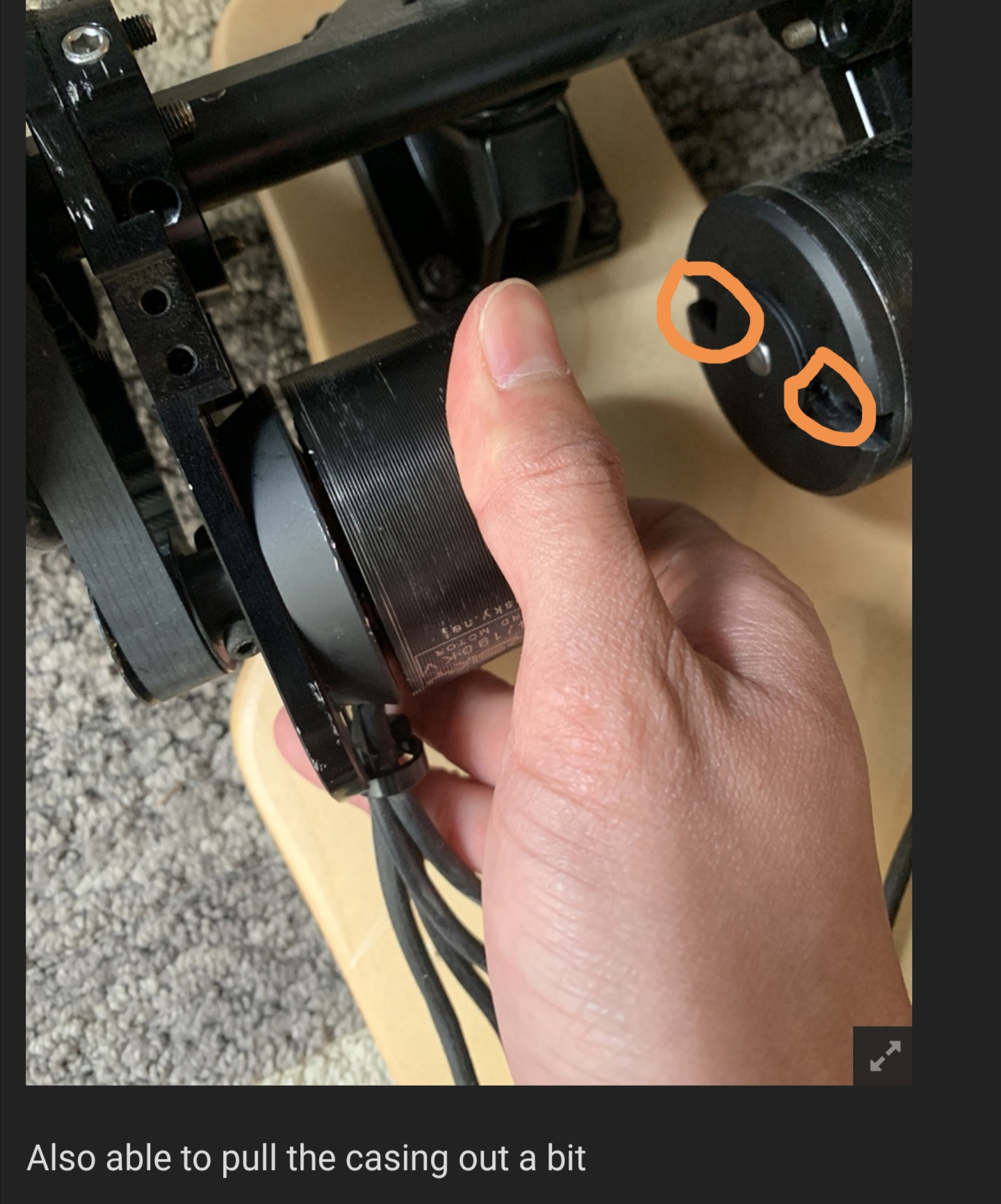

Also able to pull the casing out a bit
The shaft is loose. And i can pull it out
Try the two shaft retention fasteners located here on the bad motor.
Spot on mate. Gonna have to get some red thread locker

red thread locker
24 hour cure minimum. Ask me how I know.
