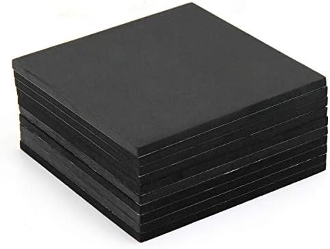

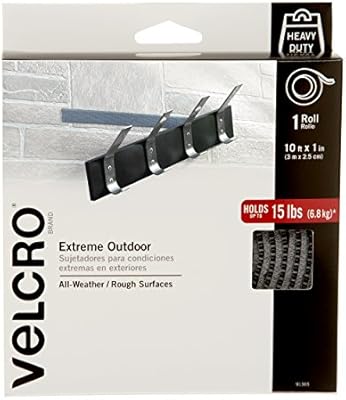

what’s the best way to mount your battery, how much padding, what parts need to be protected…etc. I’ve read a lot and everything basically points to preference rather than a rock solid way of doing it.
Personally I just use industrial velcro. Heavy duty stuff and velcro to the deck. Pad the enclosure with unsealed foam gasket material.
It’s treaded me well.

i think i damaged my battery pulling it off the deck this velcro is sooo strong.
Industrial Velcro to the deck and the bottom of the battery pack. It is secure and also pads against vibrations. Put foam sheet inside the enclosure to protect from road side debris.
wow…lol.lmbo, ok I’m already using that velcro and the padding from another thread i read of yours. I just had some damaged to my battery and the only thing i can think of is when i pulled it off the deck to reposition it…it flexed quit a bit a couple of times.
