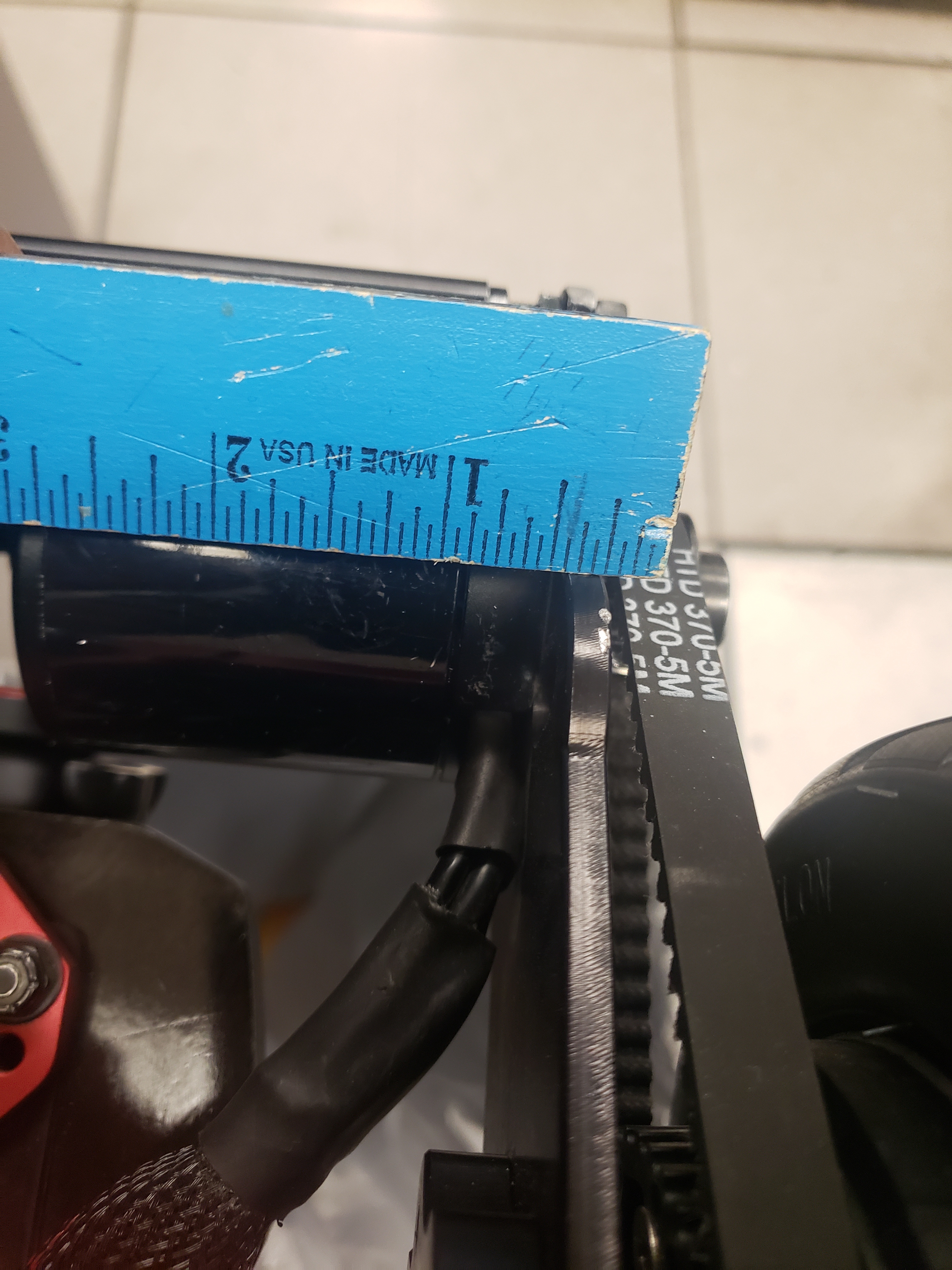

thx. I got the slack out the reason it keeps returning is because these motor plates flex like crazy. you can see them flex just by testing belt tension with your finger. I’m using the cross bars to help with that.
That is not good. How thick are these plates?
I’m looking for better ones.
That looks like a little less than 3/16".
Yes. I purchased these when I did not know what to look for in a good motor plate.
