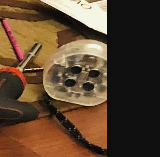

First build | Bustin Sportster | TB DD XL 75kv | 12s4p P42a | Unity
The original plan was to do a deck swap for my Ownboard bamboo AT. But as I waited for the enclosure/battery, I had second thoughts on the build and decided to make this a thane board.
After PM’ing many of you in this forum, I was able to put this together.
I did have some experience with DIY as my Ownboard has a FSESC6.6 mini and I put together the Flux board. Also had experience playing with my Lacroix Nazare and Prototipo.
Parts list:
-Bustin Sportster deck
-Torqueboards direct drive XL 75kv
-TB110 72a
-12s4p P42a battery from @A13XR3
-Enclosure from @eBoosted
-Fatboy x plate from @3DServisas
-Focbox Unity
-Hoyt Puck from @JJHoyt

That’s a really cool shell for puck, clean just like the rest of the build :+1:

Do you have any other photos of the insides?
It does flex but not much.
