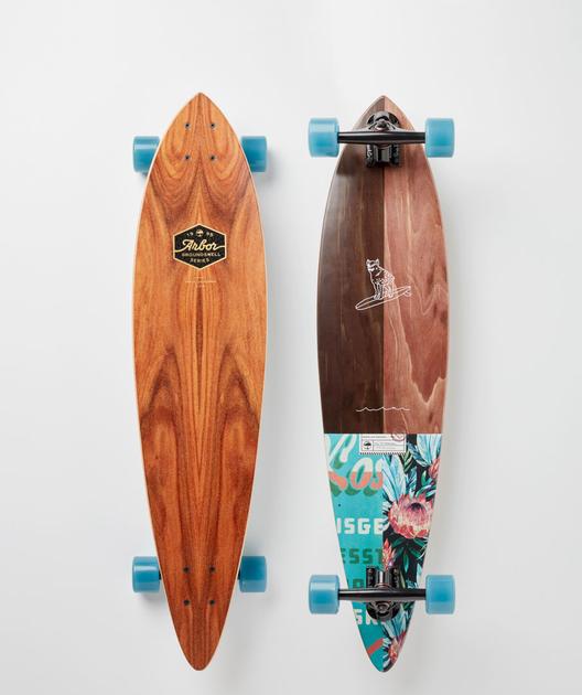

I finally ordered my deck. I guess in about a week I will be able to measure the proper dimensions and then select or design (for 3d-printing) a enclosure that fits.

Can you link the Deck you choose?

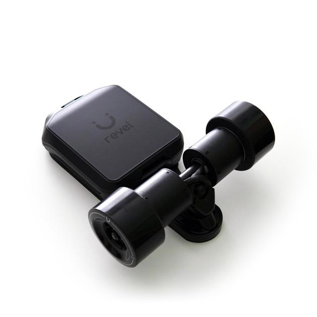

There is also the Revel Direct Drive kit, which is kind of similar to the Mellow Drive with the difference being a DD kit. It’s also highly regarded and worth looking into.
Revel at the "brand" new competitor in the direct drive Esk8 race!

As I can see on the Wepbage, The Revel-Kit offers a all-inclusive package (with battery, esc, etc. for about 700$
While on the Torqueboards I still need to buy a battery and ESC in addition to those 700$…
So the question is: How much better is the Torqueboards kit?
And how well will the Reve-Kit do when climbing a 20% hill?
Deck: I ordered the Fish Groundswell from Arbor Collective:
A screenshot on the Reve-Webpage show the Kit on a Pintial from Arbor… so it could work…

The Torqueboards DD are much more powerful motors, the included trucks, wheels bushings are all high quality. For example the Revel standard wheels are just generic wheels which aren’t bad, but just not the level of the 110’s.
The TBDD with VESC based ESC gives you freedom of configuration and you can get the most out of your given setup. You can repurpose the parts and replace broken stuff easier then with a closed system like the Revel.
The Revel kit on the other hand has nicely built in safety features and is easy to install.
Hmm… it’s a hard decision.
The simplicity, form factor and price are better with the Revel…
Does anybody know about warranty and repairability? Do you get a base warranty with rebel?
How easy is it to repair the kit after the warranty runs out (e.g. you burn the esc, can you replace it by yourself)?

So I pulled the trigger on the Rebel Kit :slight_smile:

I own both TBDD(on DIY build) and Revel kit.
I am very satisfied with the performance of TBDD, but I think the Revel kit is a great way to get started with ESK8.
Replaceable battery systems such as the Revel kit offer both advantages and disadvantages.
Pros: Add battery pack when range runs out. You can ride more.
Cons: You need to carry an extra battery pack. Battery packs are expensive.
