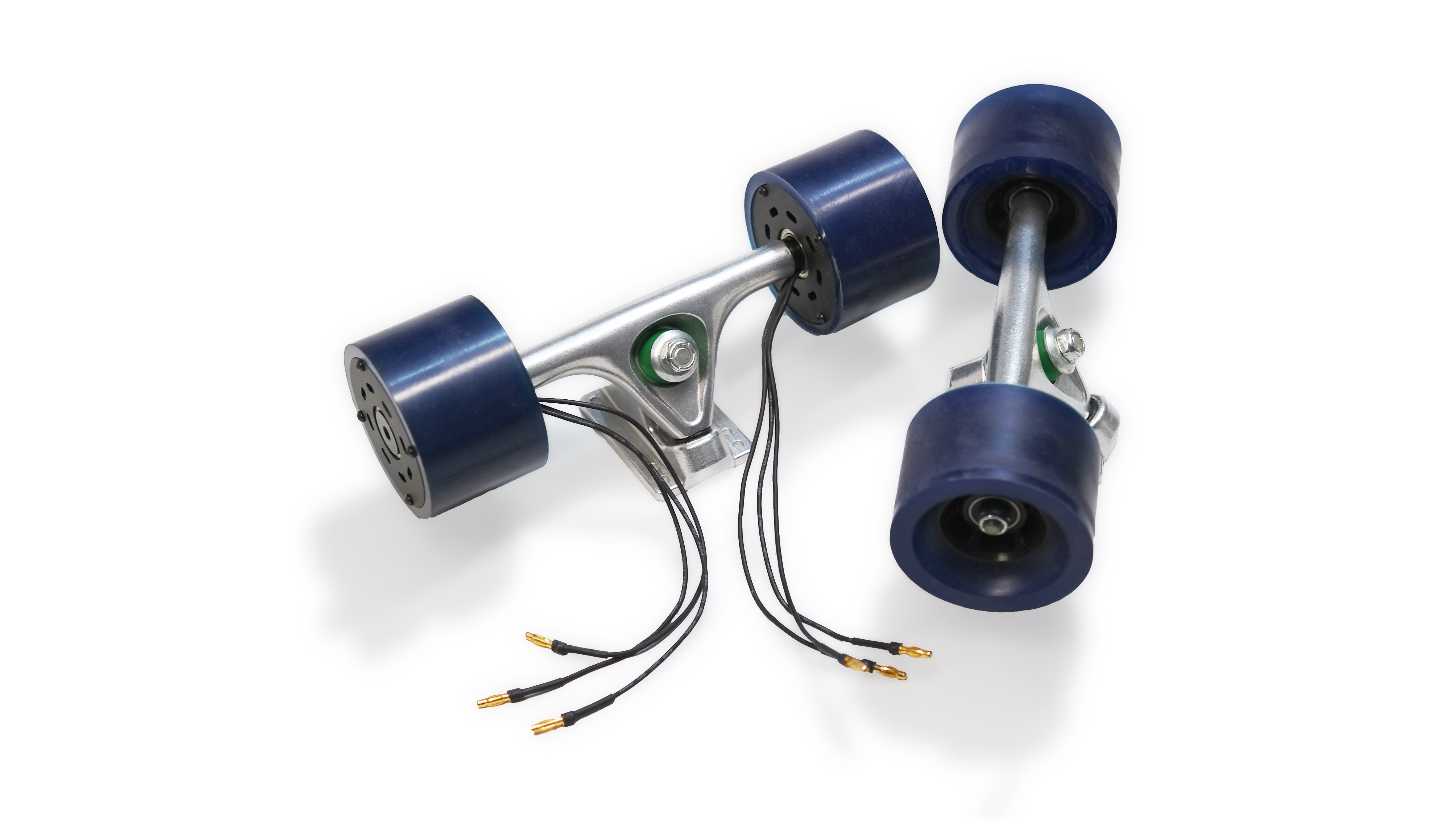

I really feel the urge to finally build myself an electric skateboard. I have already built drones – but to construct a vehicle you can actually ride is definitely new for me. So I need your help.
For a newcomer to this hobby, the marked is a bit overwhelming. I could find some components, but I am quite sure that they don’t all match together. Plus, the build like I “designed” it is still a bit too expensive for me. So please, let me know what you think and what I can improve.
The goal is to have an electric skateboard with hub motors (and replaceable wheels), capable of going at least 35 kmh (20 mah) and 30km (20m) of range. It should be able to drive uphill – let’s say 20°. This while I’m on it with my (drone-)backpack – total 90kg.
This is what I have come up by now. I don’t plan to build this – I only post this to give you an idea of my lack of knowledge in this hobby…
Wheels:
shop.elektro-skateboard.de
BLDC Hubmotor Longboard Set
Motor 8350 KV: 67 Leistung 2000W Max AMP: 50 ESC: 100A Max Volt 12S No Load Current: 0.4 A Größe: 83x50 Inhalt: Hinterachse komplett mit zwei…

Scrap those hubs. Any reason why you want hubs in particular? Hubs just aren’t good.
Thanks, I will check out @eBoosted and @BigBen as soon as possible.
I chose Hubs because they are more stealth, less prone to damage and give the ability to push the board if the battery dies one day.
Are belt drives so much better?
Hubs are more prone to damage. Thin layer of urethane between the magnets & stator where as belts are far off the ground with thick layer of urethane absorbing the vibrations.
Parts are also easier and cheaper to replace for a belt system whereas with a hub you’re fucked.

thats do-able with hubs, but they’ll heat up much quicker than belt counterparts.

Maybe direct drives are an option? They are not as stealth as the hub motors but have less heat problems and you can use full urethane compared to those thin sleeves.
I’ve never seen those Hubs from Kais store used anywhere so I have no idea what they’re capable of. I got some hummie hubs fortunately and I love them. I had only one opportunity to ride a belt drive board but I preferred my hummies by far.
I’m currently waiting for the neoHubs which I’ll use for a lightweight street deck build, hopefully they’ll be good but noone had the opportunity to test them yet.
The Hubmotors you linked are similar to Maytech Hubmotors, those were my first motors to get me into DIY, I would not recommend them. The motors sold by Meepo are cheaper and better if you want to go the cheap Hubmotor route.
Hubmotors paired with Vesc based ESC’S will get you up a 20° hill, the biggest downside is comfort, with Hubmotors you feel all the vibrations of the road.
