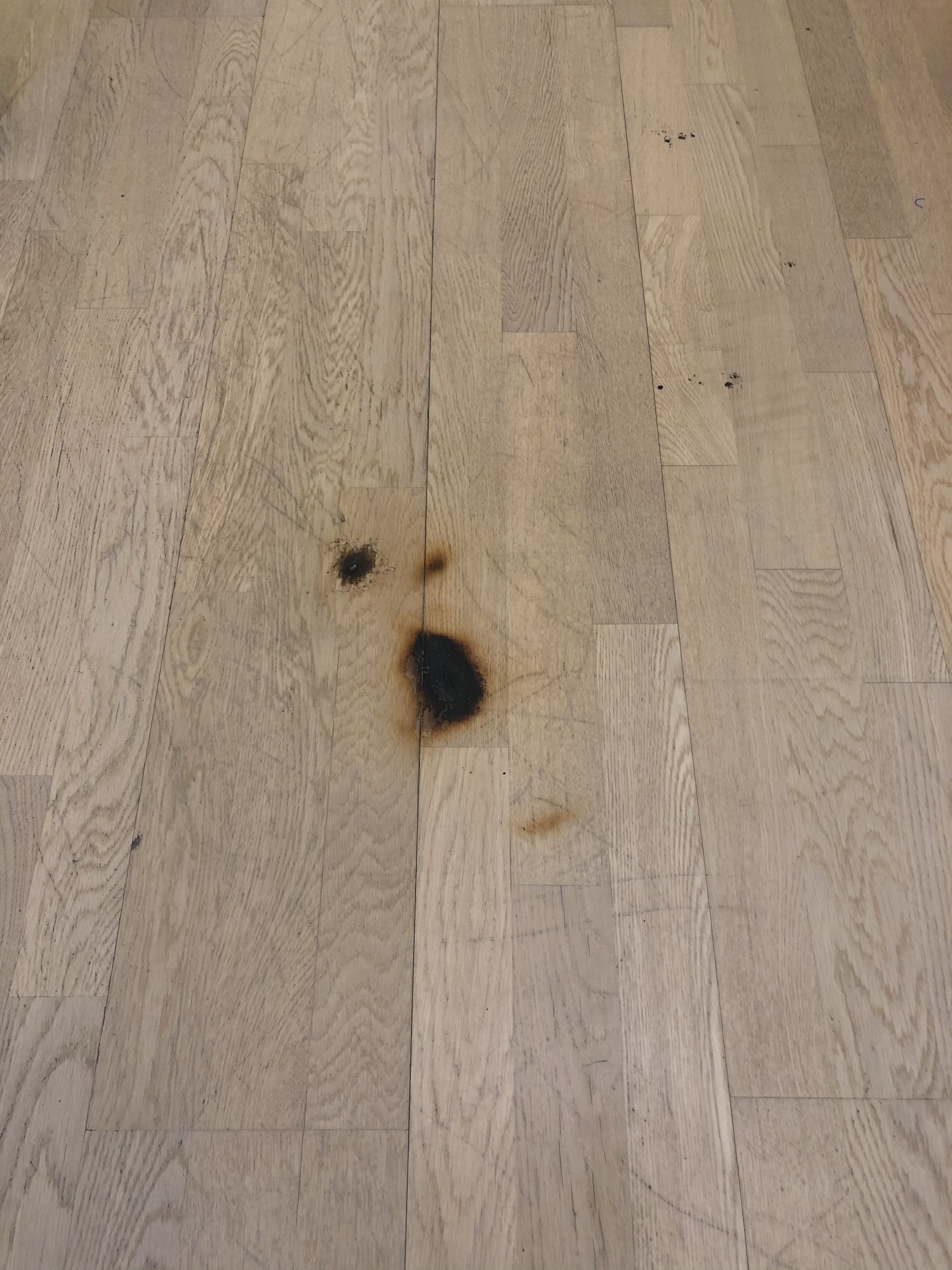

I did short a fully charged 11s4p pack because I was young and stupid and not concentrated after work…
First thing I would say to take care of is never work on batteries or your board wiring in general if you do not have enough time. The I can fast try this and that mentality just leads to unnecessary faults.
Second thing I would recommend is to be prepared for the worst always.
I think in your case it was the same. From the first sparking noice till the fire is in full action there is not much time. So for all who think they can just through a pack on fire out of the window, you won’t do that.
I was more or less lucky, the board was laying with the deck first on an ikea carpet. The trampa deck took away already a lot of the flames and I don’t know what kind of material the carpet was, but it just melded and didn’t got on fire.
I first threw a fire blanket on top, than used a fire extinguisher and in the end poured 5L of salt water on it.
I could get the flames a bit under control with the fire extinguisher, but it wasn’t enough to fully put out the fire. It just started to burn again and again.
If to look back I was kind a stupid to run back inside the flat again and again to put out the fire. The smoke was so strong that I couldn’t breath and once was close to fall down.
I managed to put the fire out before the fire fighters arrived thou.
Best is really to have a place where a pack on fire could burn out without to put anything around on fire.
Even better would be to have it in a room where the door is closed. The dust from the burning cells just goes everywhere.
We did a complete flat cleaning including walls etc. twice or three times and still there was black dust the next time we cleaned.
I think it tool 3 month till the smell totally went out of the flat. Good that it was summer and we could let the windows open and good that directly after that we had a 3 weeks vacation where the windows have been open all the time.
In the end we went away with „just“ this
And some melt rubber on the walls here and there. :pray:
Also during the fire some cells exploded from time to time and hurled some meld rubber through the room. Very happy that nothing of that hit me while trying to put the fire out.
So ja, a save place to just let it burn out or as minimum fire blankets and gallons of salt water. I think a big bag of sand will help too, but you need a not of it. Not just 5kg. That will just be blown away within some seconds.
Sounds like a scary experience dude. Glad you got off relatively easy in the end.
Could have been a lot worse.
