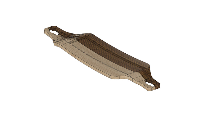

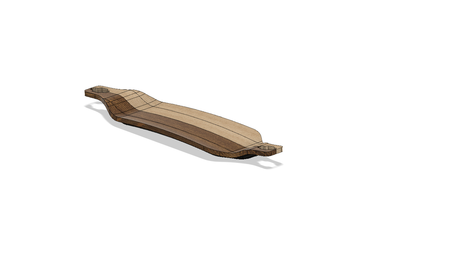

Thanks for your opinion! When I started to design this deck it was ment for me. And I ride pneumatics range from 150-200mm… Therefor my thought was a narrower front would have less wheel bite. And I like to have more space to move my right foot on the rear. .
If you guys want it the other way around I understand that! Let me know and I change it.

If you were to make the truck mounts the same the buyer could use whichever direction they wanted. And use angled risers for desired position.
Me too.
Actually I would like my Evo to be a little wider front and rear.
Okay no problem. I could make it 10rear 11"-11.5" front…?
The channels will be to the rear only i think because od strenght. So if you like you motors on rear it has to be one or the other
Also there’s a slight angle difference on the split angel nose/rear.
Century 40 from subsonic is a beautiful evo inspired board as well with a less aggressive taper to the rear.
Definitely looks nicer than a evo but has less concave which Is the only downside Imo.
If you can get something that checks all those boxes you’ll have one of the sickest esk8 decks on the market.
Ooo and urethane bumpers to save your board from curbs but that’s kinda over the top.
Looking awesome nonetheless!

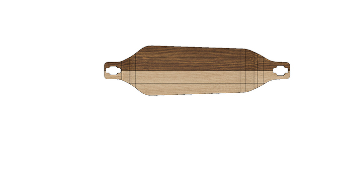

Update.
11.5" front
10" rear
42.5" long

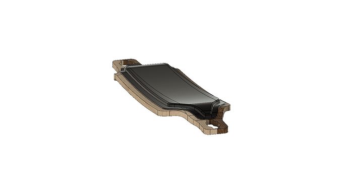

Cut out 610mm L * 140mm W 12mm D
Channel 6mm D 30mm W.
Should have som molds going in a week or so.
Still searching for a good deal on canadian hard maple…
Is that for single or dual layer?
Do you mean double or single stack enclosure? It will be single for now
