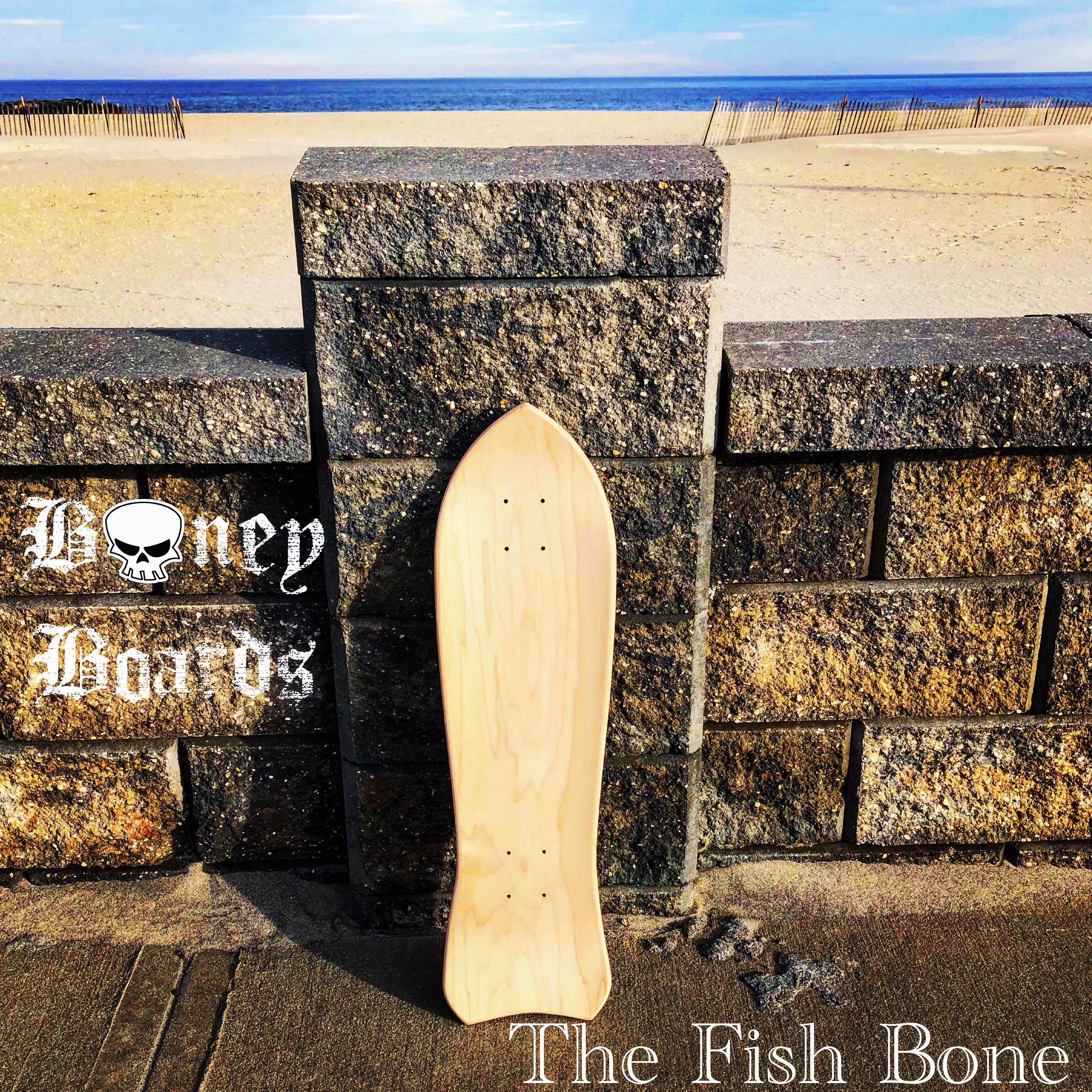

This became the Blue One
That is how that one is but it is 8 by 28.

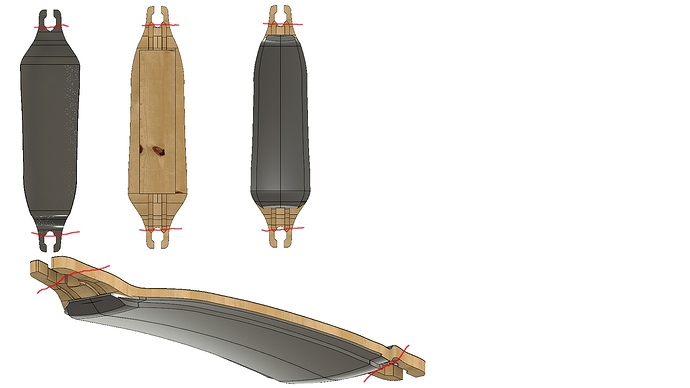

This is a good idea. I don’t know how many people are going to be dropping through a dropped board.
Having this as an option would allow people that want to the ability to do so, but even my flat drop-through deck, I just run top mounted, not even using the drop through cut-outs. With a dropped deck, i’ll probably be using risers.
This is all to say that cutting the drop-through removes a lot of the decks strength right here:
Seen too many drop through decks crack right there when people were running their drop-through decks top mounted like a lot of people do.
