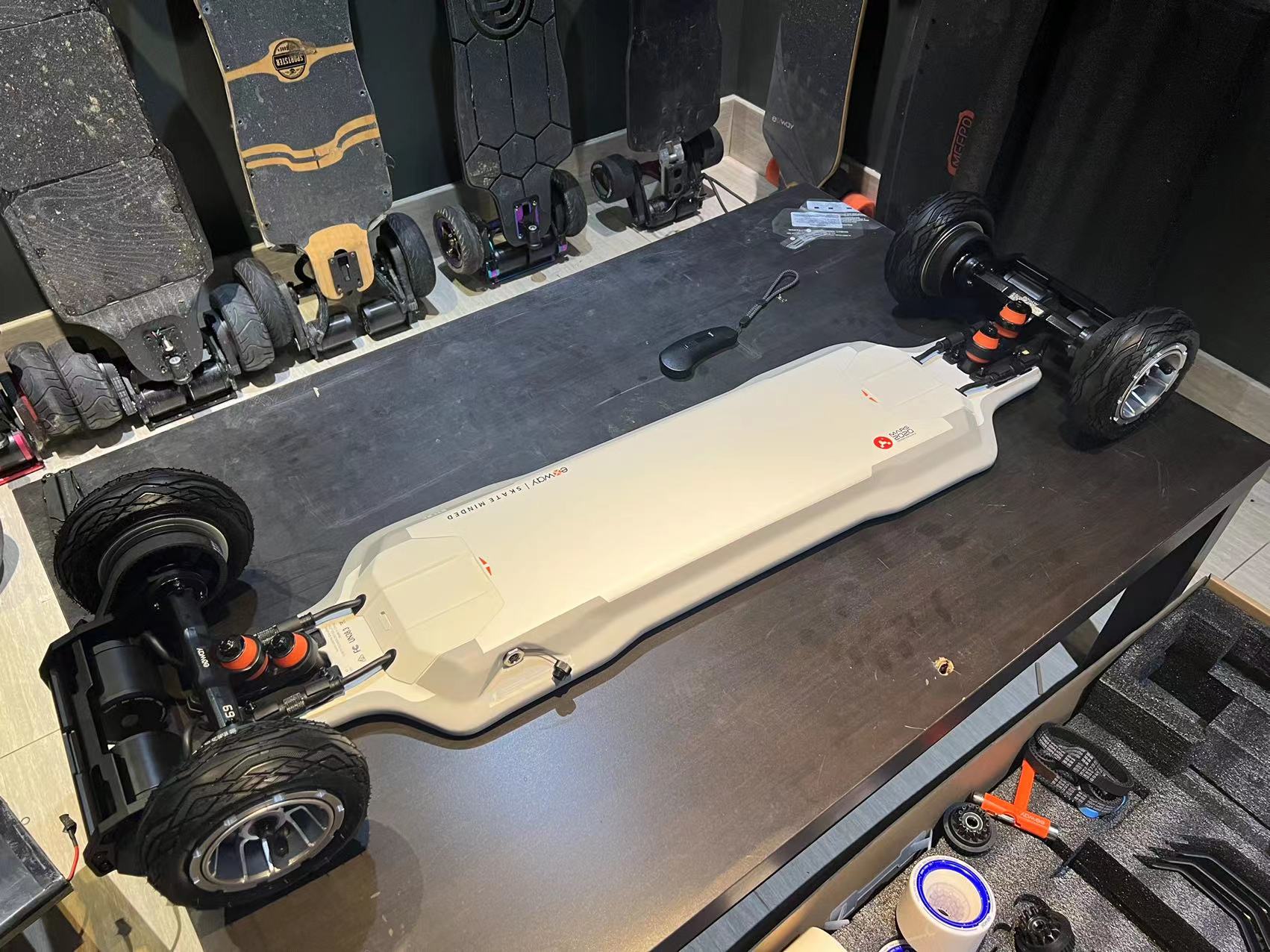

Just got the board, first in the world xD
Looks clean asf rn, but I have a feeling this will get dirty after just the first ride. I’m really contemplating between testing the true power of this board or savour it, it looks too damn clean to be ridden the same way I ride all my other boards…
A lot of cool features baked onto the remote, including motor detection. Not sure if it will support other motors so that’s something in the list of things to check.
Will report back on the ride feel tmr, gonna film it too.
