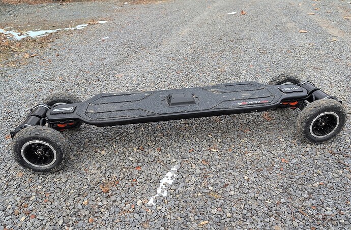

Added a new ride to the fleet:
I’ve had an older Atlas 4WD belt drive for a few years and the only things I didn’t like about it were snow and mud getting jammed up in the belt drives, sometimes causing the belts to snap, and I also wanted more low end torque. This solves both issues with the gear drives and larger motors, though I may eventually buy an even higher ratio gear set for them, but I’m still playing with settings.
Out of the box it was definitely faster than my old Atlas but didn’t feel quite right. I messed with the app and made it worse somehow, (not a fan of the app setup), but eventually noticed that the motor and wheel gear counts were both set to 20. Set them to 18 and 68 using the remote and it really woke the board up. (Had to go through the setup twice as the first time it only applied to the rear motor, not sure why doing the exact same thing again made them both work but it did). Also out of the box the board went backwards from what I expected when looking at the forward arrow on the front truck with the remote switch in the forward position but was also able to switch that in the remote setup. Braking is insane, I’m on level 2 right now, 3 will lock them up, and I think it goes to 10.

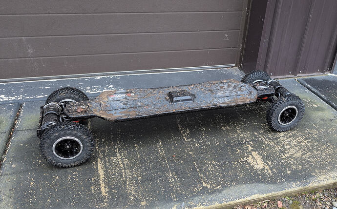

This is why I needed gear drives:
Board would keep going if I could stay on it :grimacing: Better tires would help, probably will upgrade to the same Trampa Mudpluggers I used on my other Atlas.

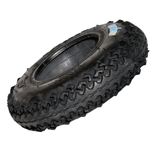

Seems like with shipping, VAT, and tariffs the Trampa’s aren’t a great deal anymore. Looks like the next best thing in an 8” x 2” off road tire is the MBS? Any better, more aggressive options?

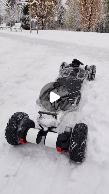

Did you ever get to test those tires out in the snow?
I tried a similar one’s. Didn’t work so well.
Board survived :laughing:
Not real snow, just a dusting, but I’ve used Mudpluggers on my other Atlas and they were good until the belt drives loaded up with snow and jammed.

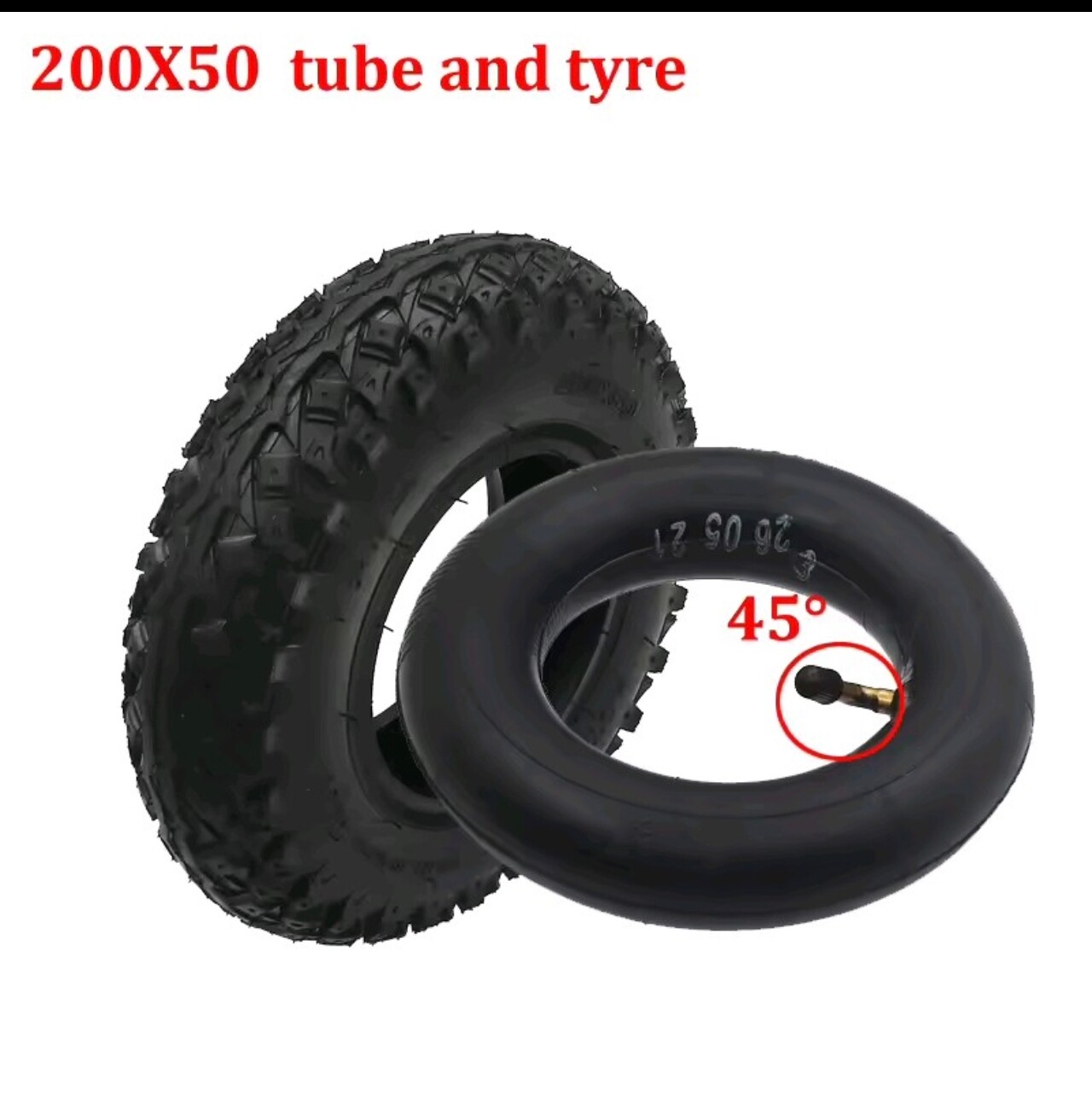

Those look more like my stock tires, not nearly as aggressive as the Mudpluggers.
You are right. It was these ones
