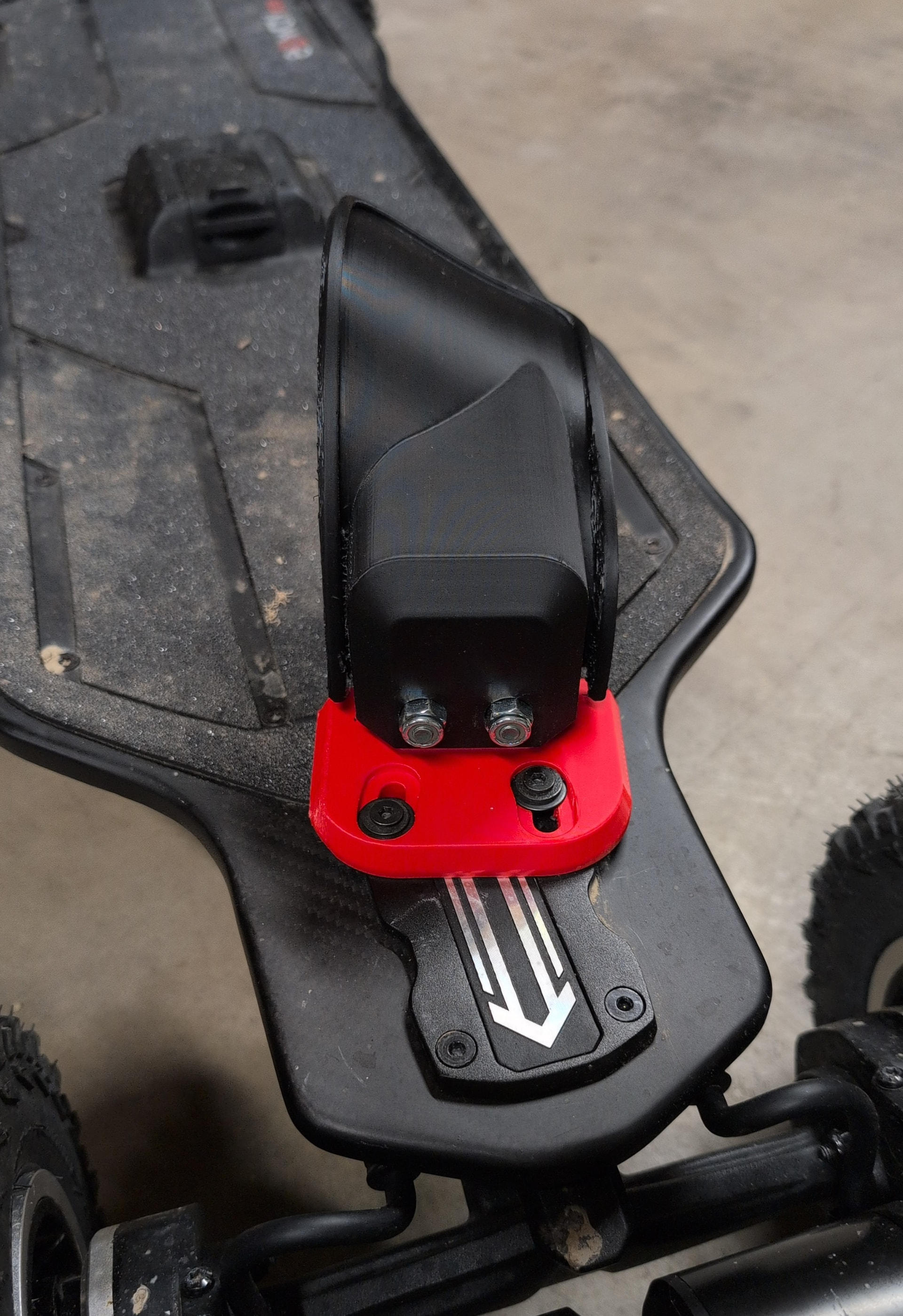

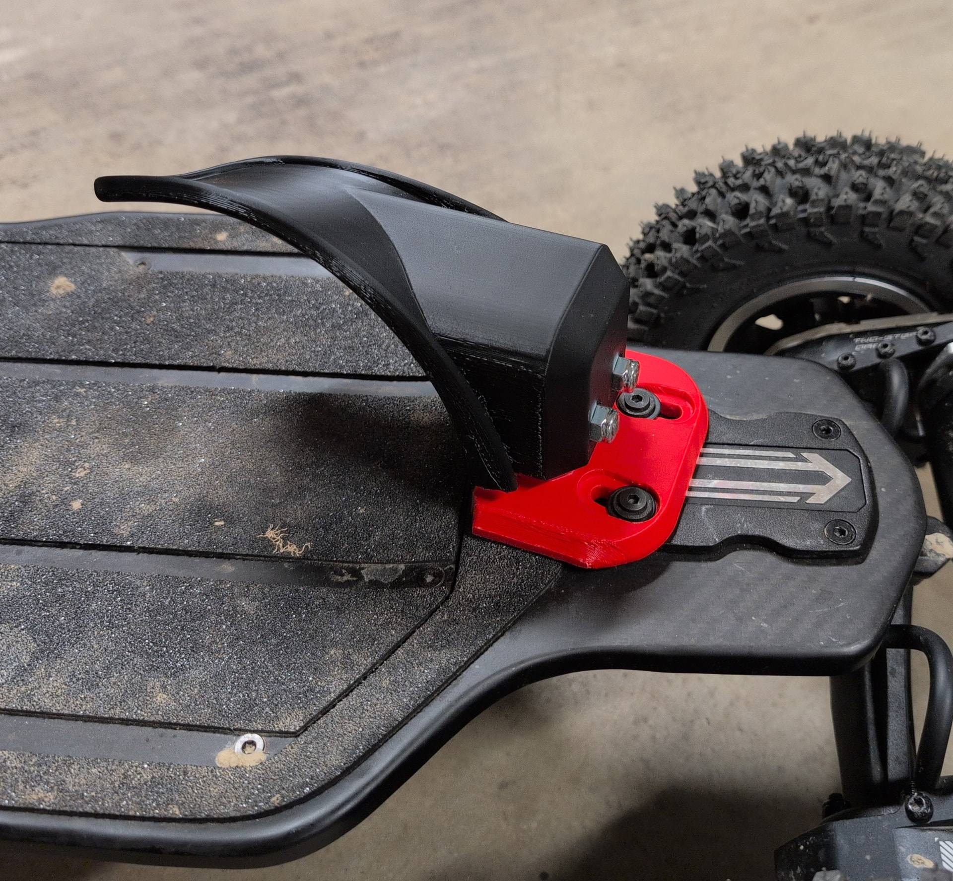

I just printed one out. Reoriented the base 90 degrees so the print lines would be stronger to the main force, used 100% infill for the base and I think 30% for the hook. 2 colors because I wasn’t sure I had enough black. Didn’t have any T Nuts so used regular. Gave it a test ride in the woods and it seems good, though I don’t seem to have enough clamping force to keep the hook from sliding to the top range of the adjustment under load. Might need to slide some thin rubber in there for better grip when tightening the bolts. Or maybe I need to print the hook at 100% infill for more rigidity.
This is an oldie but a goodie. I didn’t really do much testing on this one before I moved on to the ratcheting design on my website. Your idea to put a thin strip of rubber in there would probably solve the problem with it slipping.
I was searching for a printable toe hook and this was the best design I found :+1:

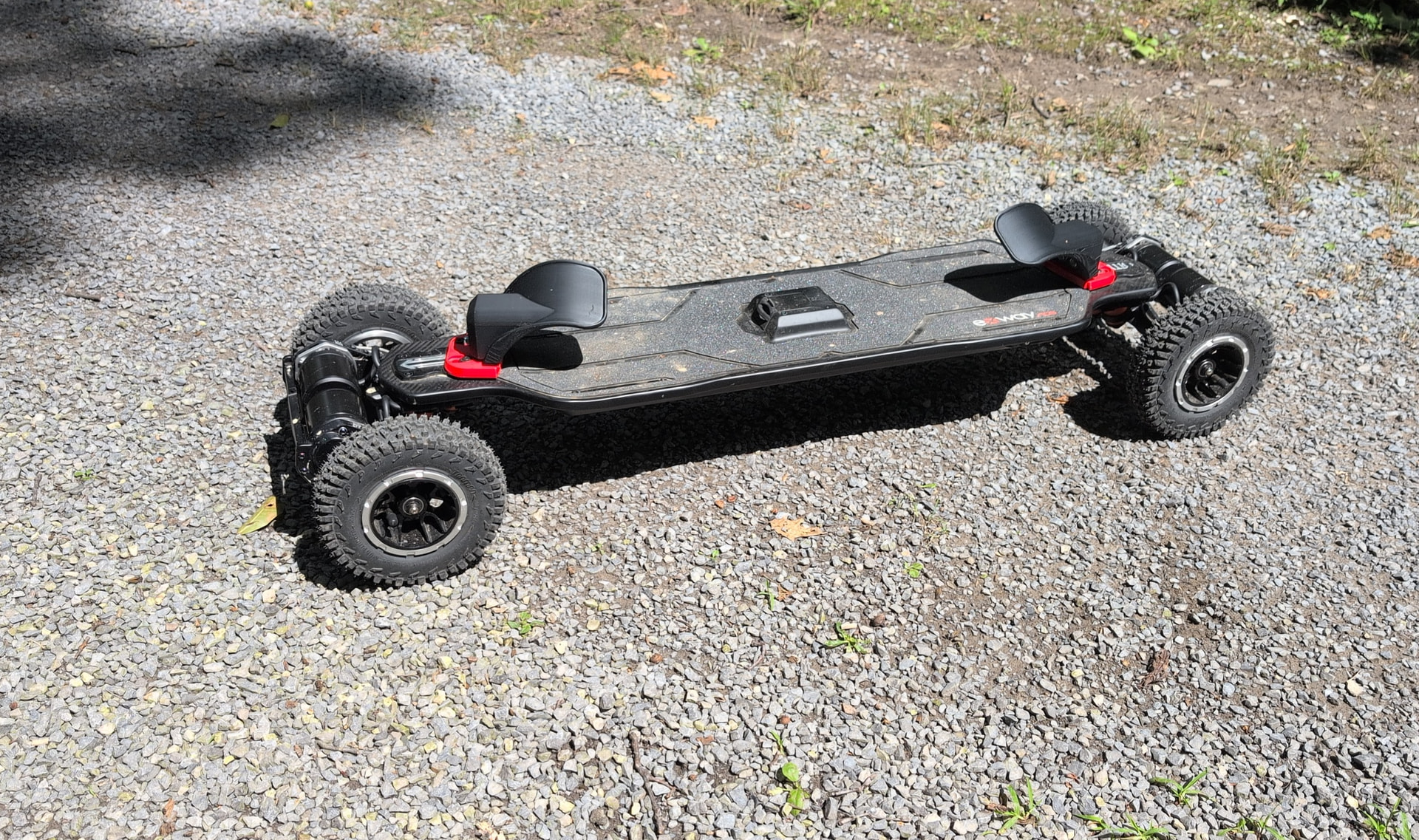

Turns out I hadn’t cut out the supports in the relief slots so the tab couldn’t flex enough to make good contact. Printed another one mirrored for the back foot
They really fit that board nicely. I’m happy you’re getting good use out of that model.
