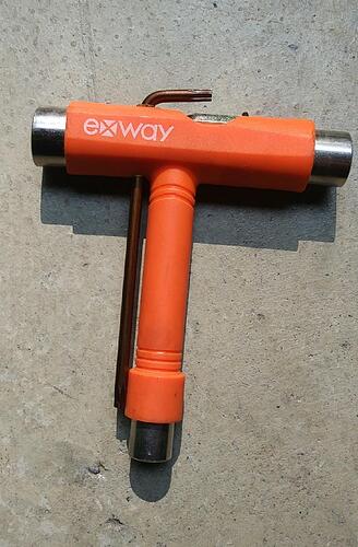

I wanted to carry the torx driver in my skate tool so I drilled a hole in the handle, slightly oversized 3/4 of the way through then friction fit for the last 1/4.
