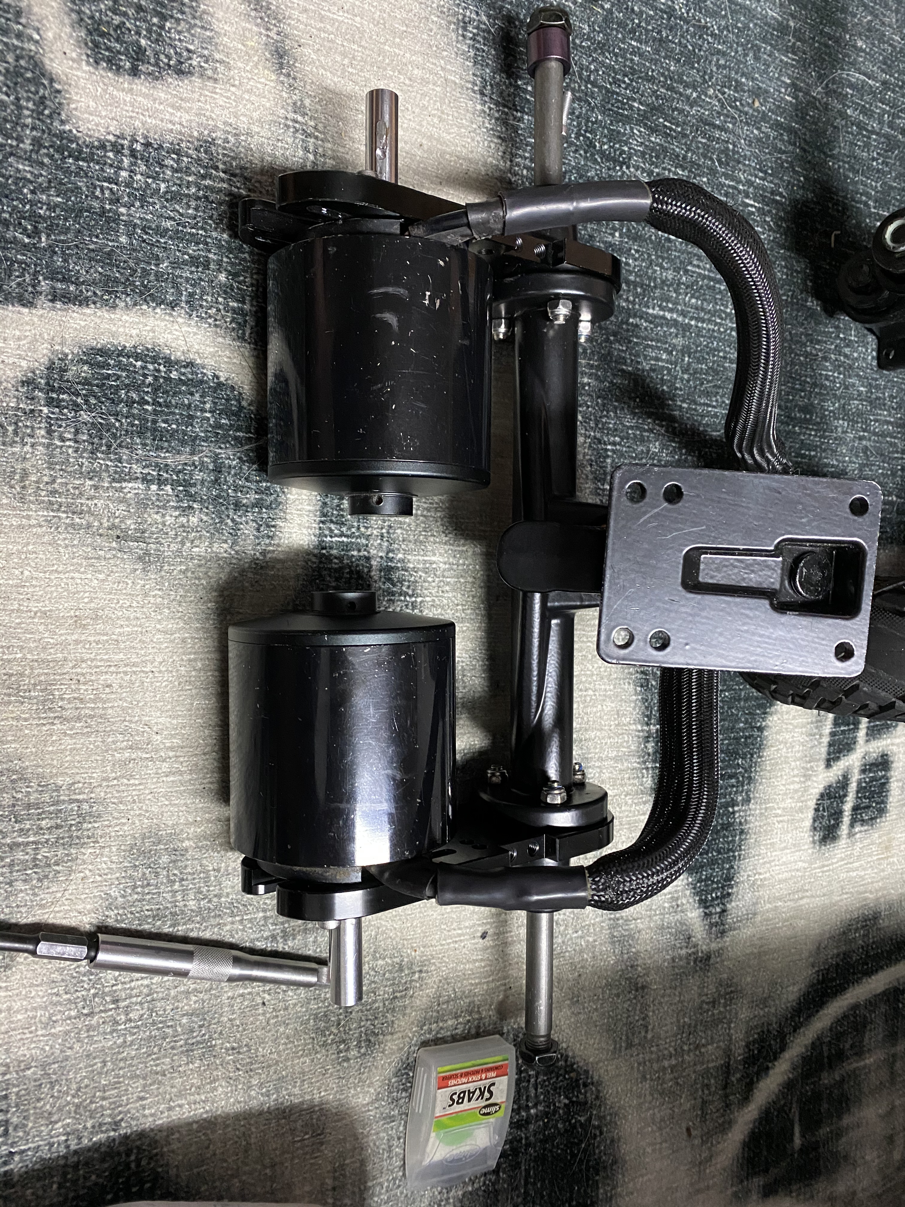

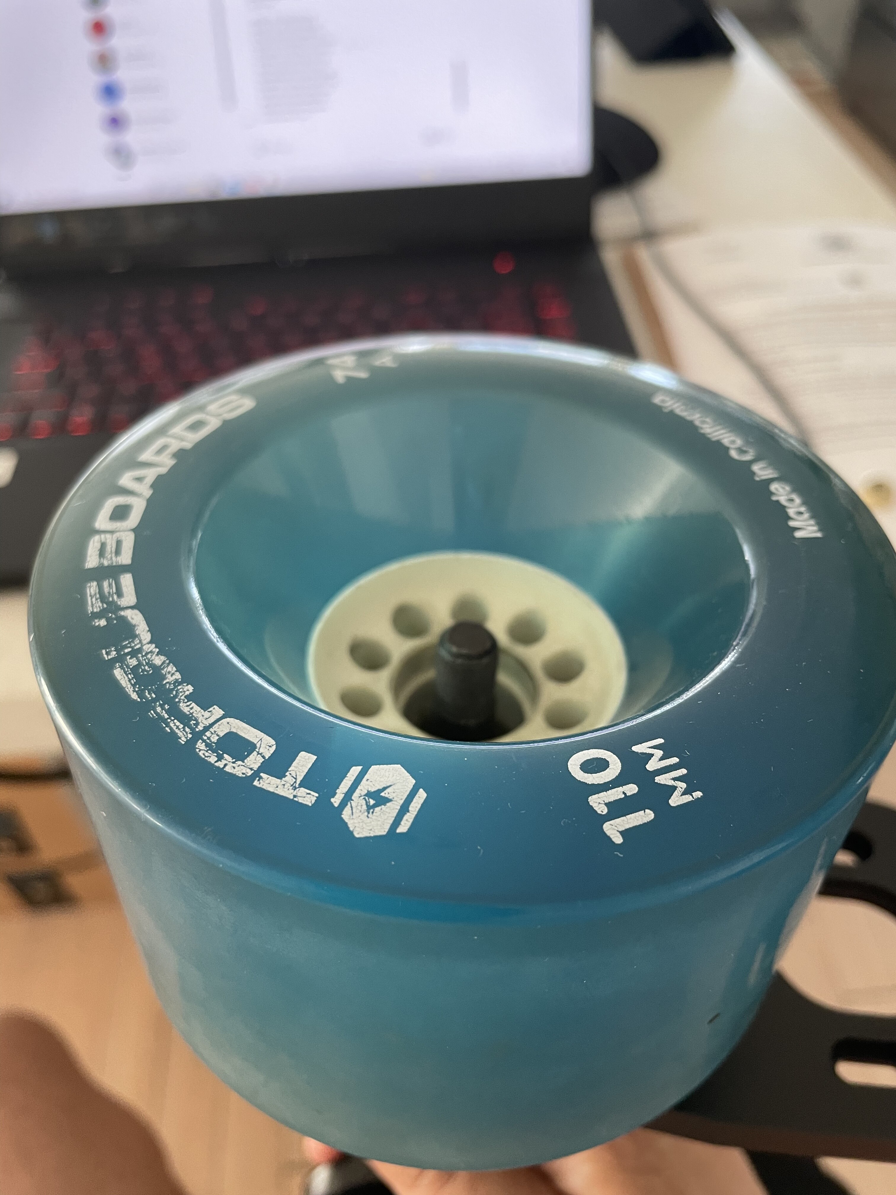

Evolvenstein with Flipsky 15.2" DPK trucks
Casting is a bit sloppy. And the evolve hanger is forged too, making it a bit stronger.

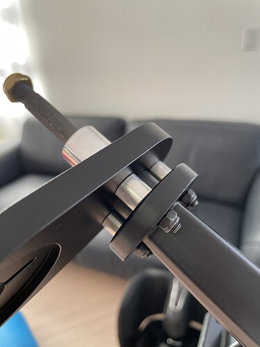

Used a lathe, to remove enough to position pulley alignment. Use one washer on backside. There are pulleys with a large bearing, that fit as is. With AT wheels. It is almost all of it.
The bushings are likely soft as they are the same ones as 12 inch.
I also have to use a die, 3/8 24 to extend the thread further, to get rid of four washers. Didnt have to redrill to change angle of mounts. Thought about doing so, if motors can go on inside well. But likely dangerous to motors.
Give us the formula for bushings. I will talk to riptide about it soon. Havent finished board yet, so dont feel confident in ordering custom yet.

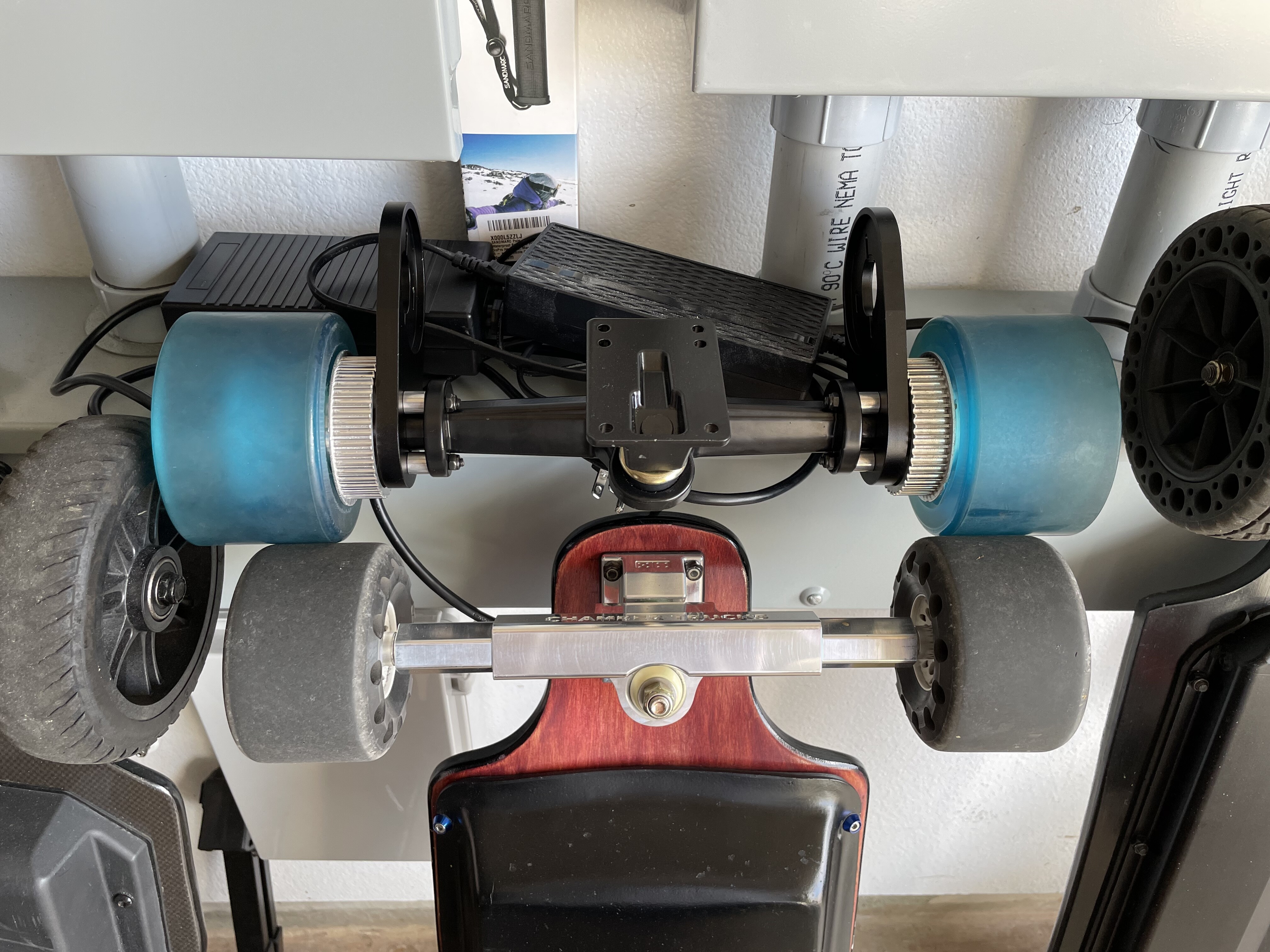

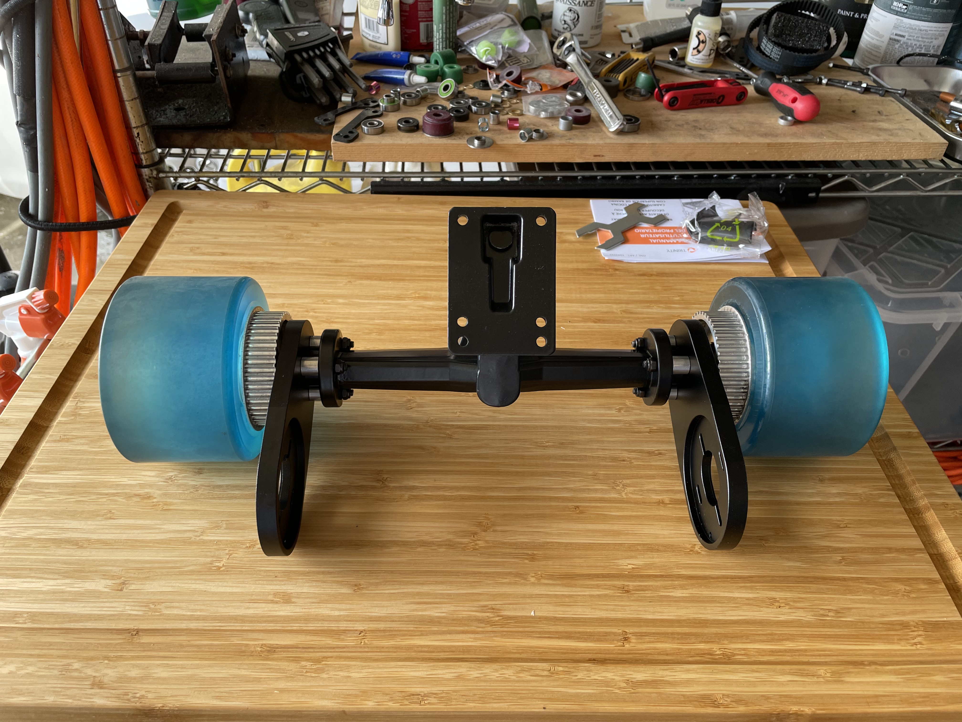

Moving drivetrain off my evolve for something different and decided to take a crack at these mounts again.

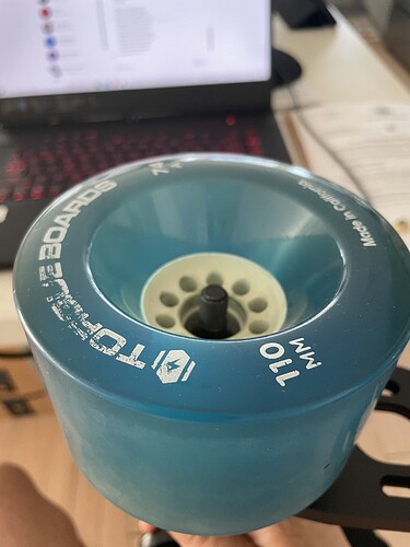

95ā€™s closer to the deck and 92ā€™s closer to the ground. Iā€™m about 78kg.
Works for me, suitably stable at speed and still carvy.
Is it just a sleeve around the axle the silver part ?
Here is what the 15.2ā€ trucks looks like with 10mm spacers. This allows them to work with Boardnamics pulleys. The new version of the trucks has a 10mm aluminum built in spacer instead of the 20mm one in the original version.
