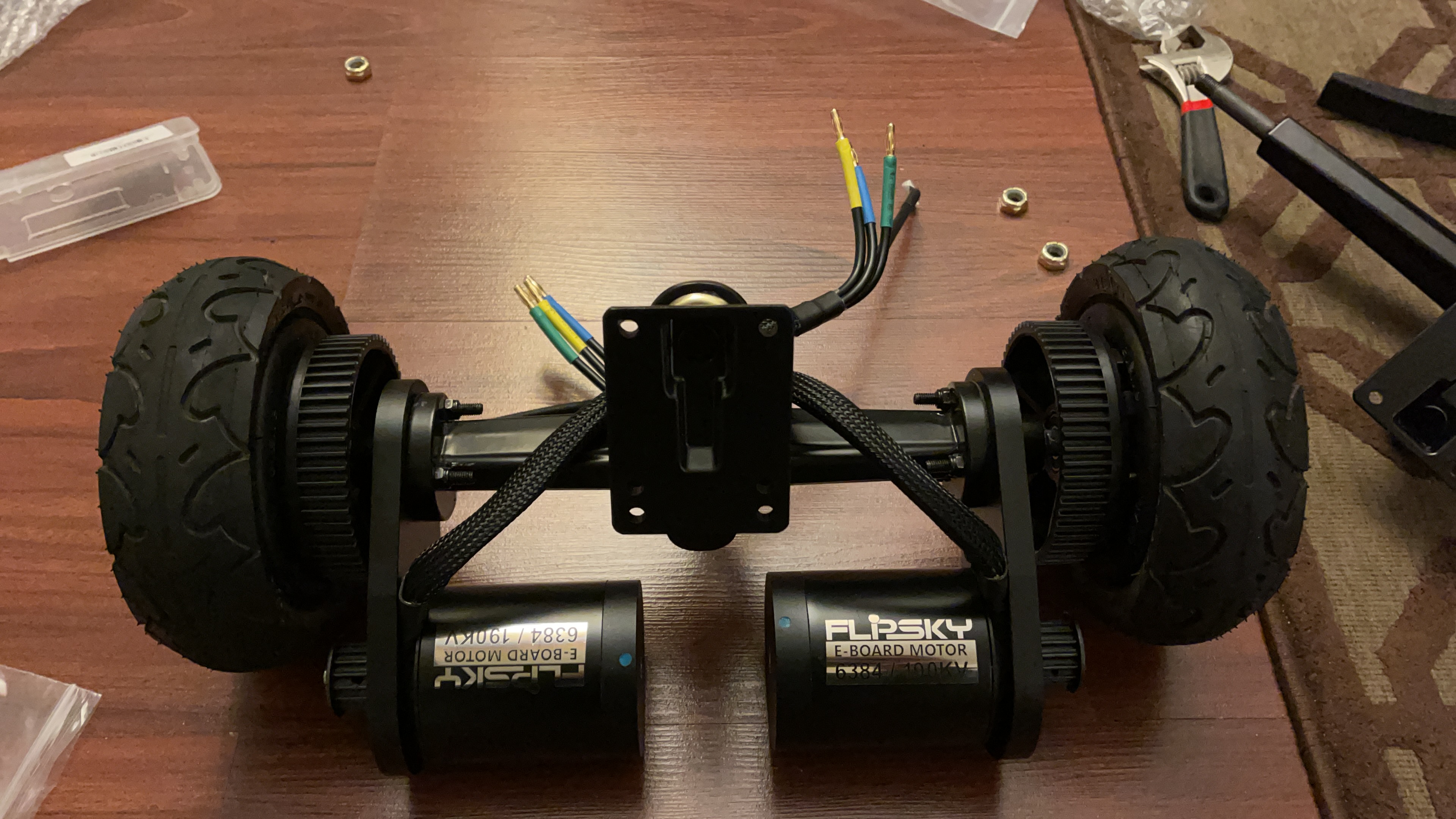

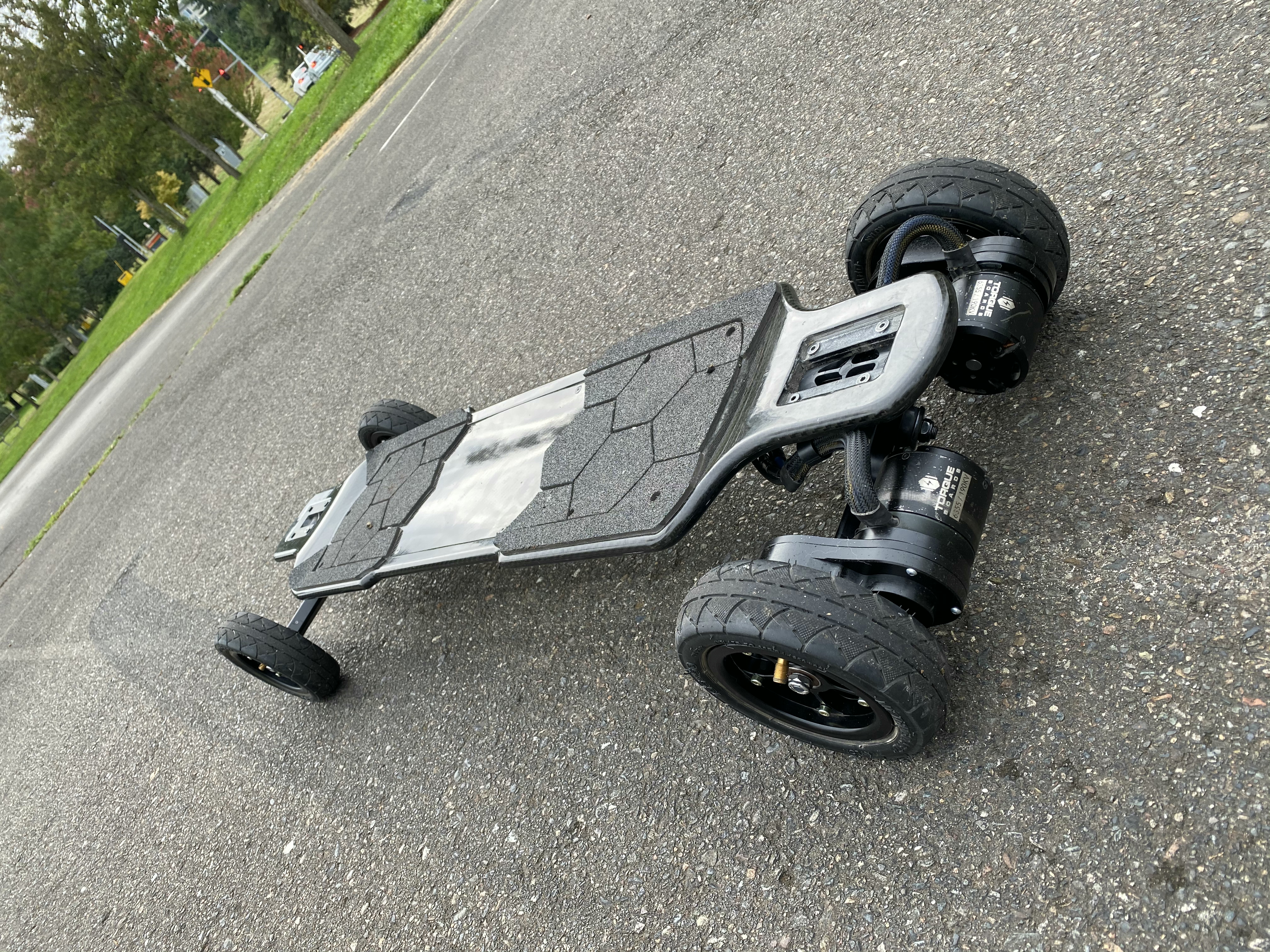

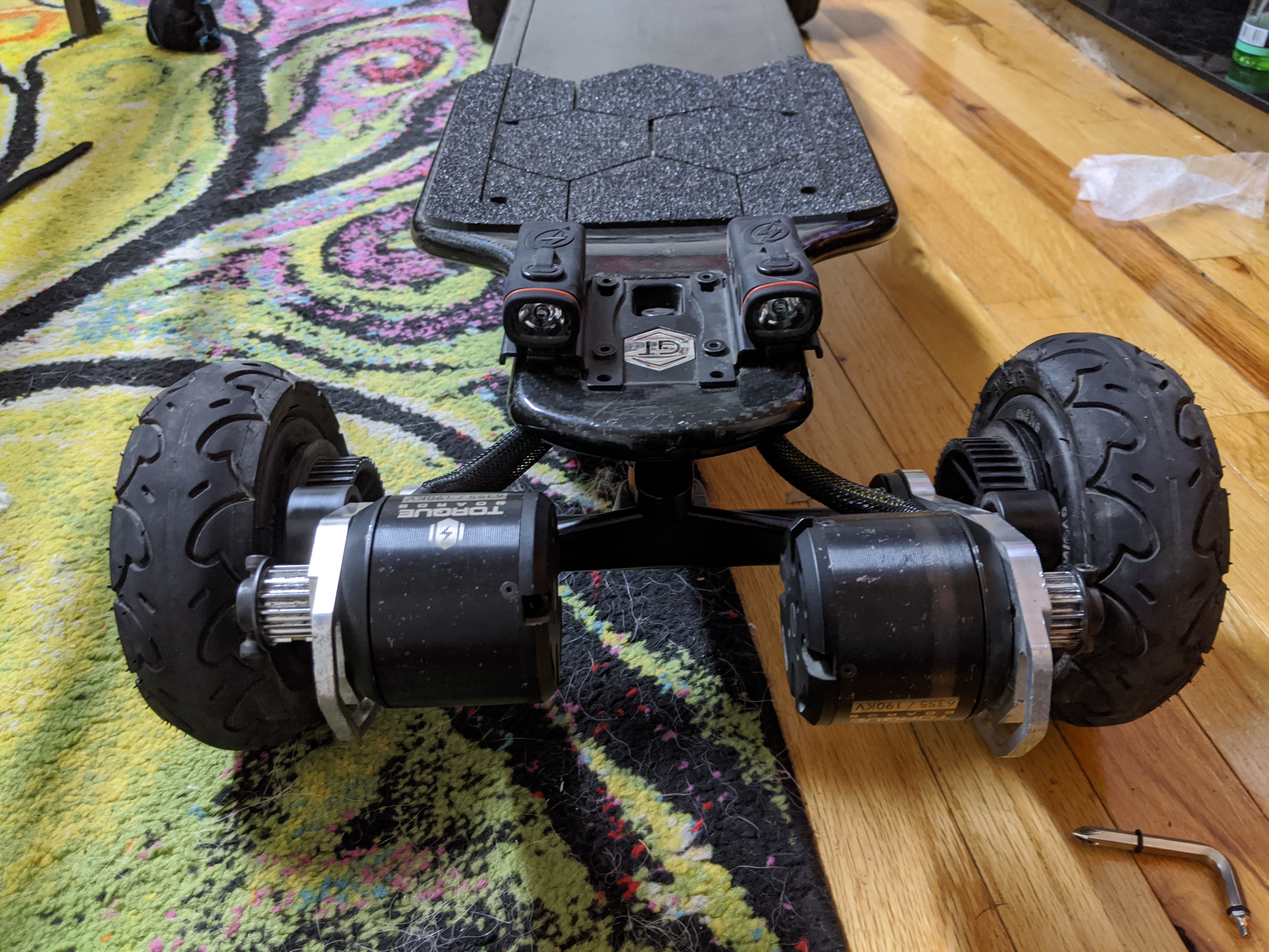

Managed to finally get hold of these trucks and fitted them on my Evolvenstein Carbon Gen1!
Had to machine the truck to fit the pulley and Trampa hubs and drill holes in the hangars to change the motor angle. I’ve also replaced every screw and bushings because they were…sh#t.

Went full gear drives instead with fatboy 260 hangers

i have them as well but it doesn’t fit my evolve hubs/pulleys. I assume you took some of the “silver” part off to expose more axle length?
Can you post a pic? I think that pic has bolt on pulleys so nothing on the truck at all.
With evolve hubs and my ideaTB mounts pulleys were too far apart.
Fitment looks better with bolt on pulleys. I do t have any evolve mounts to test but I just slapped my superstars with 62t on it and it looks better to me.
I took all of it. After that, it’s a straightforward fit (bearings used are 10x28x7 if memory does not fail me)
do you have any pictures? taking all of it seems excessive it seems.
Was able to use a Dremel and removed the silver part. Evolve 6” kit with 6384.

how’s the 15.2" compare to the 12" DKP? wanted to get your feedback on these. thanks!
Not as nicely buit, but very robust it seems, they come with very soft bushings. Imho the evolve trucks are better. They seem a little more refined.
However the extra width in between the axles is very nice for long motors ofcourse.
I bought a steering damper to help with the wobbles in the back a bit more.
Get other bushings on and you’ll notice a marked improvement on your ride, especially at higher speeds.
Much more stable and still very carvy, well recommended!
Not sure why you say it’s not as nicely built? Yes, I had to take the “silver” metal bit and replace bushings, but the trucks themselves seem ok…
Certainly the easiest way to fit DKP trucks with dual motors setup and larger than 6.5" tires on my deck without having wheel bite.
