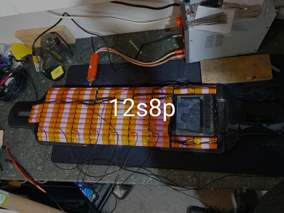

There’s no way the lid closes all the way in the front of that enclosure unless there are two different Gen 3 Carbon GT deck styles
Correct
Not mine, local group page. Apparently 12s12p.
I think maybe we need a definition for “fit.” lol
:joy: it does look ridiculous.
There is no way this lid closes all the way in the front.
At best, water can get inside. At worst, you are standing on the cells as they are vibrating inside an electrically-conductive box – just a matter of time before abrasion takes its toll.
The lid closes a couple of mm below the deck so adding some padding actually equalizes the deck and the lid and leaves room for a decent battery.
Not mine…
There is a pic with the lid on?
Looks like a rolling time bomb to me.
This looks like an CGT in a fat suit lol…
water gets inside before the mod too… The 8 bolts has too much space between them for a good seal unless you take measures to prevent it.
As for worst case, I’ve put thousands and thousands of miles on it with no sign of even abrasion wear on the heatshrink. I run bits of double sided foam tape to keep the pack from moving the slightest bit, the only thing is the pressure of standing on them, which as far as I can tell they do not care about it at all either. No dents on the cells or whatnot, functions perfectly normal.
I think the concerns are justified but exaggerated if proper measures are done to keep the pack safe…

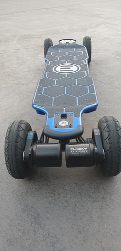

Thank you, yes this is a gen2 carbon series, but minr came with a single motor, still gen2. I takd it this has been modded for dual motors?
Mine
@Dbell yes, his Gen 2 deck has Gen 3 rear trucks with two motor mounts.
