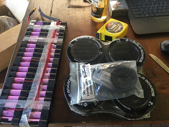

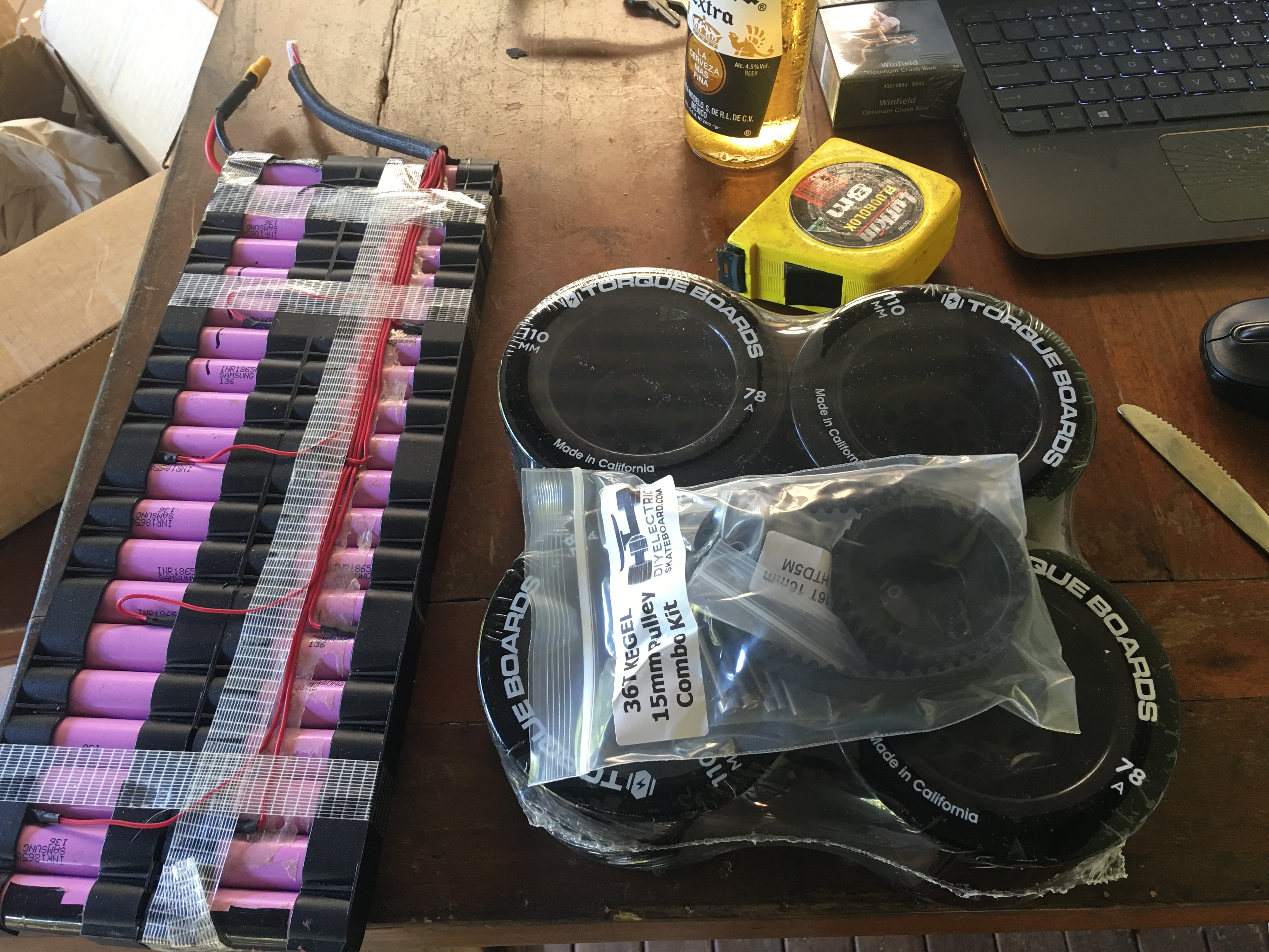

Got a little update on the board. It will shortly be sporting some new shoes courtesy of @torqueboards. When I say courtesy I didn’t mean they were free. Dexter would steal the sugar out of your coffee and come back for the milk. TB110’s are on their way.
:scream:
I got told off last time I entered into a bant sesh with you so clear off. @janpom gave me a right mouthful.:sunglasses:
Got my 110’s. Although I have to say on examination they are only actually 109.5mm. I have brought this massive liberty to @torqueboards attention trust me. :rofl:
They are things of beauty. Big squidgy bouncy lovelies. (Type that into the hub and see what you get)
In my head 13mm was not a great deal so figured just get the kegel 36 pulleys. No. These things dwarf the 97mm as I 'm sure some of you are aware. They look twice the size so back on the website to order the 44. I only actually ordered 1 pulley anyway due to a brain fart so no drama.
Anyone looking for one 36 kegel pulley kit?
Other issues are the idlers.
Dual 608 bearings will hit the new wheels for definite. If I had used my crystal ball when setting out the position then I would not have an issue. Now have to source some 8mm small diameter rollers or move the idler. Don’t you just love building? Hey I’ll buy some great big wheels, easy swap hey? Fuck no. Anyhoo. The thing is benched anyway due to a battery issue(bad cell somewhere which I will find) so time is on my hands.

Quick update. Battery is all sweet and dandy now. Turns out it was me all along. When using the bestech HCX D596 e switch bms you have to turn the switch on to charge even though it powers on automatically when you plug the charger into it. What happened was the bms got its knickers in a twist and almost lost its will to live.
Started balancing already balanced cells and got very hot doing that. Random safe mode shut downs etc etc. Fix was to run the pack down to nominal and then charge to capacity. Fixed. Shout out to @taz for being very patient. Well he wasn’t actually patient at all and was quite rude in fact but everyone loves an I told you so moment. :laughing:
It did say in the instructions how to charge the pack but instructions are for losers.
Anyway battery all back installed and new shoes on now.
