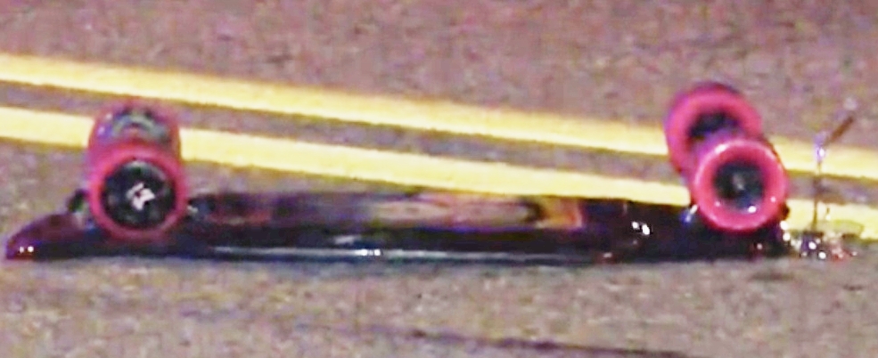

Very sad I have seen the seawolves play the double AA team in Trenton. Doesn’t seem like he was wearing a helmet but this seems more like a board malfunction.
Idk. News say “footage shows he hit a obstacle.” So let’s not rise the pitch fork yet.
Riding at night with no helmet or lights…that’s a very dangerous game. By the sounds of it, he was not going slow either. Sucks to see it happen to what seems to be an amazing guy. Wear them brain buckets people… i’d be devastated if it happened to anyone I know from here…
