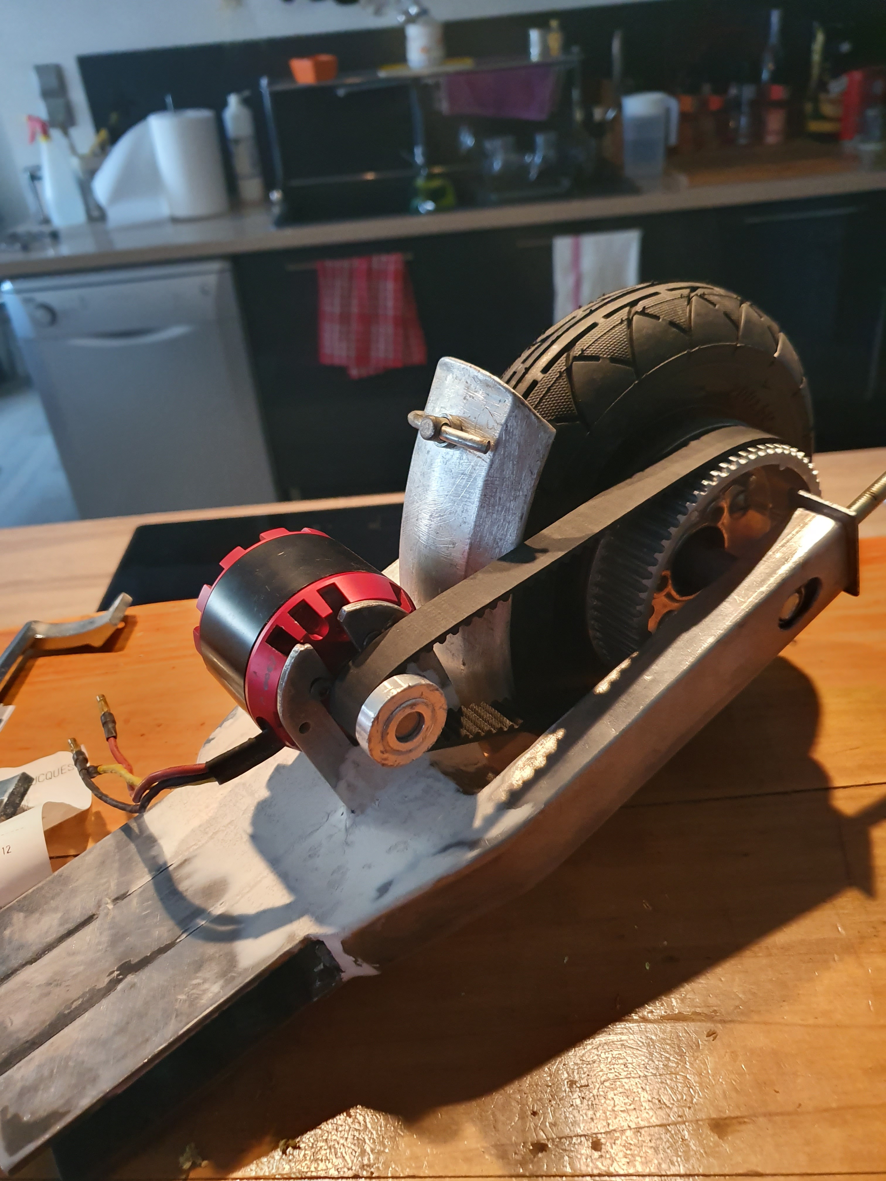

hi my name is greg and here is my next 3 wheel skate
Pour la transmission, 15/66
3200w 130kv alien motor
10s5p

it’s in court. I’m waiting for rockstar pro gold rims as well as a mbs vector truck. the board is drawn, remains to be done. still a little patience.
I made a 3 wheel and loved the stability of it. The turning radius was shit due to use of a flat deck and poor truck choice. This looks like a much better start!
any bearings in the rear bracket/axle?
No,it’s not necessary
You’re going to he able to mount a big ass motor on that thing if you choose to upgrade. I really like my neat and pretty hubmotors, BUT your belt drive design opens up the opportunity for a whole new realm of powerful motors.
Did you use a bike fender?
Yes! it is a bike mudguard. after reflections the reinforcement was cut on the belt side. it’s more aesthetic!
the wheel axle is provisional; a brand new one is on order. mbs vector trucks and rockstart pro gold rims arrive at the end of the week. cool!

creation of wheel tensioners. remains to cut the surplus.
