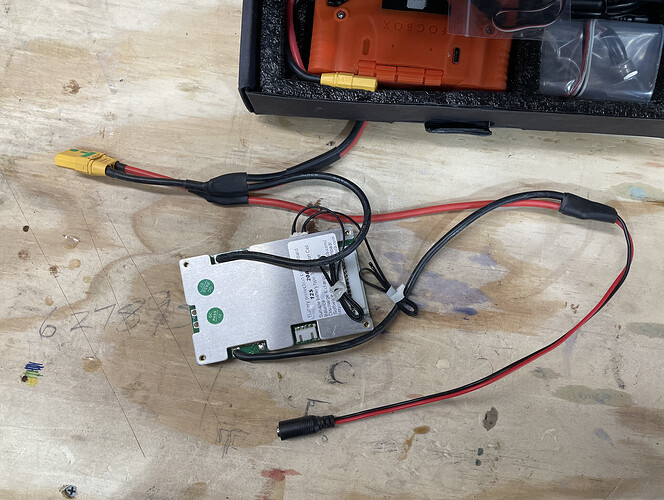

I installed my Xiaoxiang BMS and per the video my volt reader checks out with each progressing by 4 Volts up to 49.4V total on the last negative (black wire). But the Xiaoxiang App is saying my first two cells are near 0 and 2 Volts, for a total of 43V. I have no clue how to set up the App. I “read data” in Configuration and most of the values match other screen shots I’ve seen on this website. Not sure why the App isn’t recognizing the first two cells properly?
Is your website down? I get an error message for esk8life.com
Thanks.
Do you have the B- solder pad on the side of the BMS connected to the B- of the pack?
This might help you.
No. I just have the balanced wires connected.
Is that a three port connection with positive / negative from the battery and the B- from the BMS ?
AKA: Black wire from batt to “B-” on bms!
There is the Xt90 end that goes from Battery to ESC straight line.
Then from that straight line there is a Neg to the BMS and Neg out to charge.
The positive from charge goes back into the straight line.
So the Negative of charge is all that is running through the BMS.
This would be bypassing discharge or a charge only BMS setup. :wink:

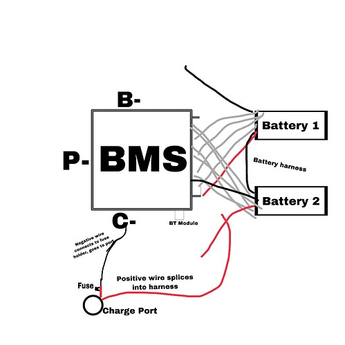

Got an similar BMS. Got two 5s Lipos. Connected them in series so that gives me 10s. Currently working on the balance wires. Drew up a diagram and was wondering if this is right? So I know for battery 1. I connect up to N4, skipping N5. Battery 2, connect the rest. The end the black wire
(Diagram i drew below, the fuse will switch with the negative wire. Connecting to the C-. Going to the negative wire, then going to the charge port)
