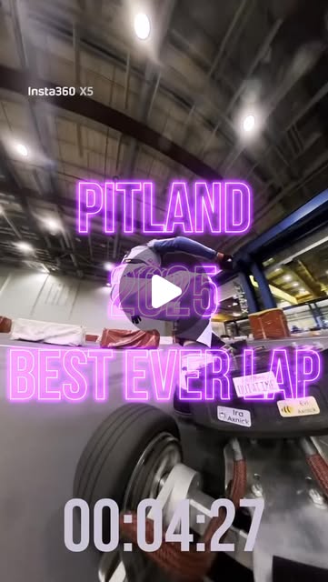

I uploaded some footage of my riding on these tires on Insta.
I improved my personal best lap in Pitland 1.33sec compared to my fastest lap on BRP‘s. This was in the XERACE finals. It is also now the fastest ever lap in Pitland - 32.00sec. I didn’t change anything else on my board.
