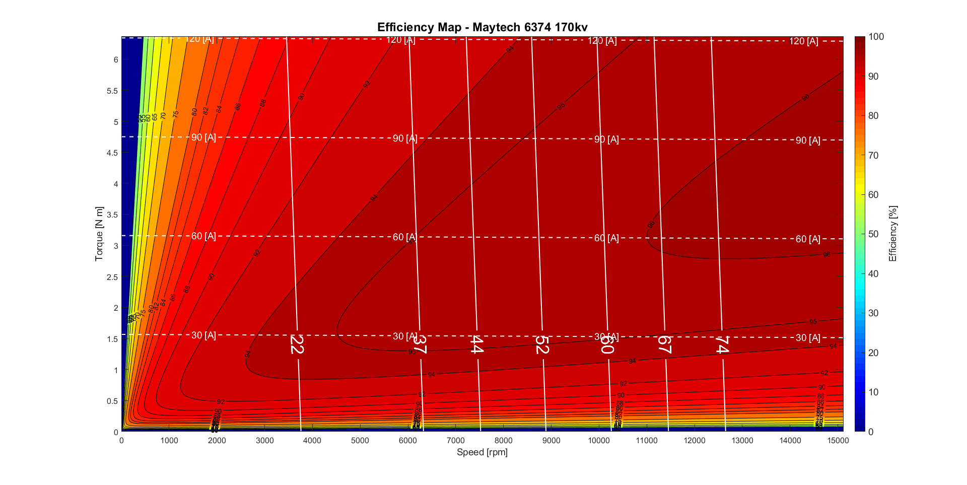

Motor Model: Maytech 6374 170kv
Rated Current: 60A (65A max)
Pole Pairs: 7
Phase Resistance: 16.1 mΩ
Kv: 170 rpm/V
ESC Model and Firmware Version: Stormcore 100D FW 5.3
ERPM@35% Duty Cycle: 17150 Erpm
Phase Current@35% Duty Cycle: 0.65A
ERPM@95% Duty Cycle: 45860 Erpm
Phase Current@95% Duty Cycle: 0.92A
Comments/Observations:
RESULTS
Km = 0.3661 [N.m/√W]
