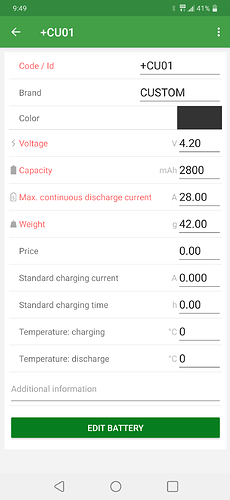

@mmaner would it be a possibility to add a custom battery field? This way, we can enter batteries that aren’t the general public versions. A little something like this (from my battery pack calc app)

That’s one if the features I’m working on. It’s a little difficult. I’m trying to feed battery specs server side so I can add ‘custom’ as an option.
