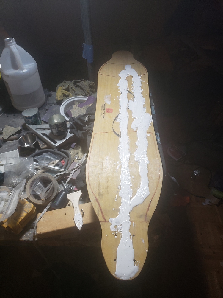

Epoxy on bare wires?

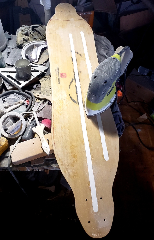

Hey guys~ about to gently route some channels for some copper braid on top of my loaded vanguard which I’ve sanded. Been searching online and run into mixed messages…? Is epoxy ok on bare non-insulated copper?
After that, should I coat the board w some protectant or something before I drop the grip tape on? Sanded the spray frit that came stock on the board to be able to route wires
Yes, it should be fine.
should be fine between the griptape and deck.
id add some eletrical tape on top of the wires before you put the griptape down.
I would leave the tape off, it will create a weak spot where delaminations can happen
I was going to drop some kapton tape on it… what about what to use to seal the board? AgaIn, not much of a wood worker, so, I have a sanded deck and understand something needs to go on top before the grip tape, yeah?
Sorry- to be clear- the kapton was if I don’t epoxy/
kapton tape is what boosted did on their boards. from my understanding if you dont cut the channels too deep epoxy isn’t necessary.
wait how does the tape delaminate the deck?
It can make the griptape able to delaminate easier from the wood. In the end, the griptape is a layer laminated onto the other layers that collectively are referred to as “a deck”
ohhhhh. i thought you meant the deck itself became delaminated.
No kapton tape on mine, hasn’t proven to be an issue yet

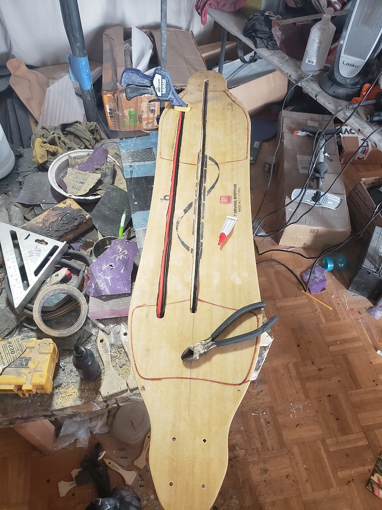

Is that epoxy? Or- what is that white junky?
I SUMMON THE CREATOR OF SEXY DECKS
@Sender
@Sender
@Sender
Can you please answer the above question, mans needs to know what white gunk you spooged into my vanguard. I’ve got no idea.

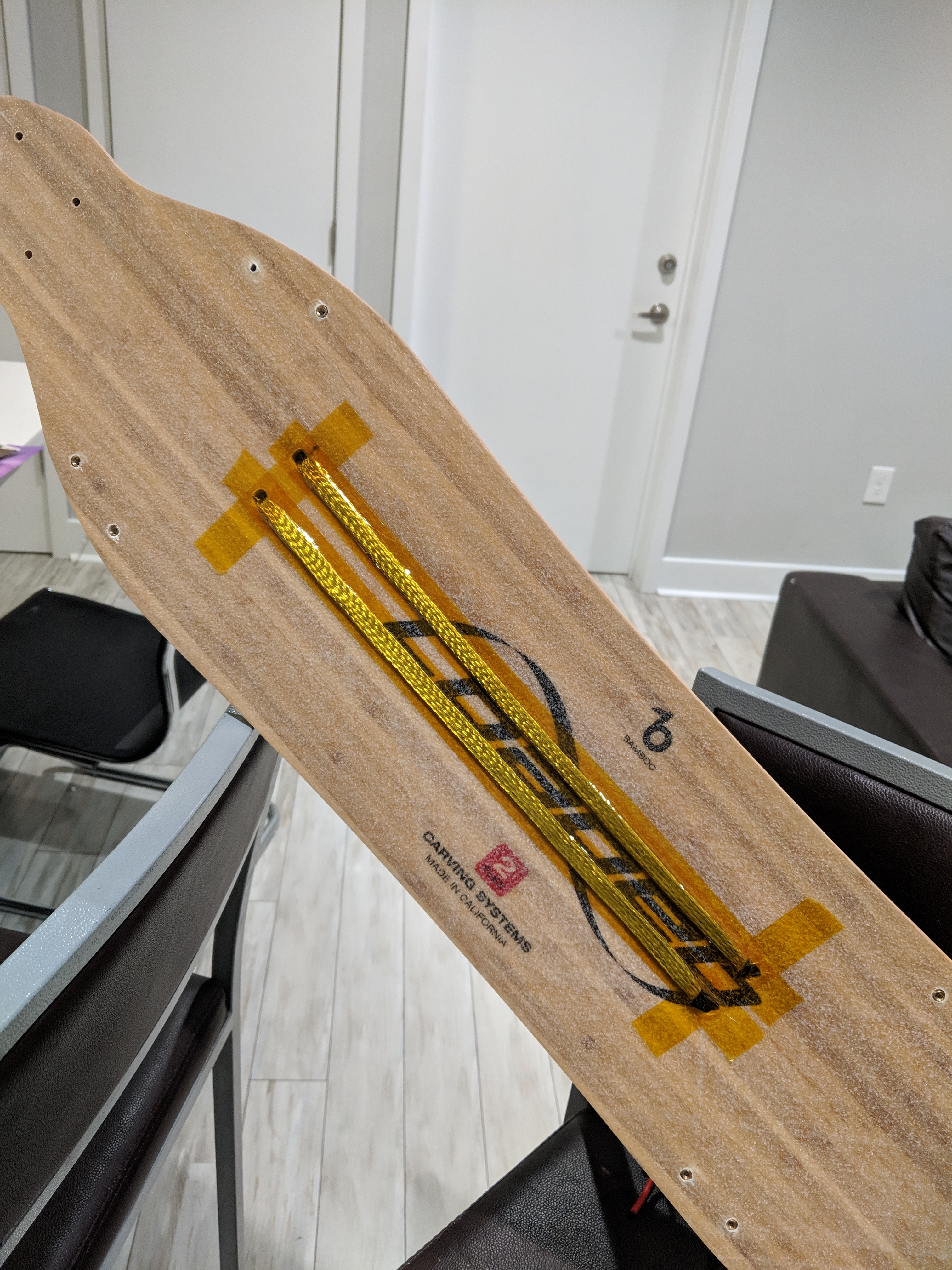

Here is what I did… this was long before I had a dremel. No issues other than a slight bulge on the griptape but I hope to route out some shallow grooves and put some kapton tape over it in the coming months.

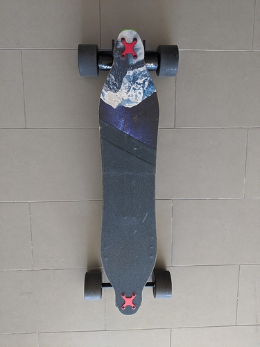

Looks like a similar build to mine. Flex 2.
40inch? Looks like you went w direct drive. Sick. Still running pulleys here.
