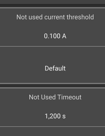

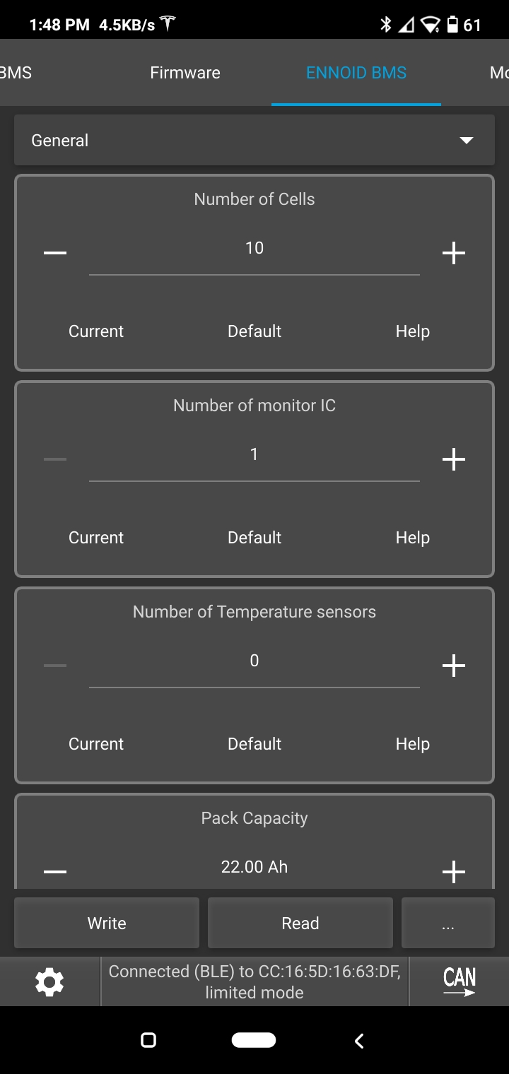

Last night I upgraded my X-LITE-24-V1 firmware to 5.5 and started using VESC tool to configure it, having some trouble with it. I’ve gone through the setup a few times with 5.4 and the Ennoid tool over USB, and each time I do a full charge while the USB is still plugged in to work out any kinks, and then never have a problem with it. Since VESC tool doesn’t show operation state and fault state, when it just stops charging for no apparent reason, it’s impossible to figure out why. I can’t get this to charge to full, I can manually press “allow charging” and it goes for 30 seconds and then shuts off again -
Here are the settings:
Screenshot_20230113-082930~2
Screenshot_20230113-082925~2
Also VESC tool lets you input values that would be out of bounds on Ennoid tool, which causes unexpected behavior. I initially put 0.03A for sleep current, and it would shut off periodically even at 5A.
You can use wireless bridge to connect with EBMS-tool desktop in the “connection->TCP” section if you need to diagnose the issue with fault code and opstate.
I think I’m observing what is going on in the video, I see a sudden voltage jump for a second or so. I observed that behaviour recently on a few units running V5.05. I don’t know yet if it is related to using a new compiler version for V5.05 on my side and what conditions create this issue. (I’m moving back to the old compiler for the next release due to this and will see if it goes away). It might also be hardware related, but I’m now using genuine ISL28022 due to its recent availability instead of previously using aftermarket ones that might cause such issues. For now, I know that you can bypass the problem by using parameter on ENNOID-BMS->signal->Pack voltage data source == sumOfIndividualCellVoltages instead of == ISL28022 (I2C). It will simply take pack voltage readings with sum of cells instead of relying on ISL28022 and no more error should occur.
