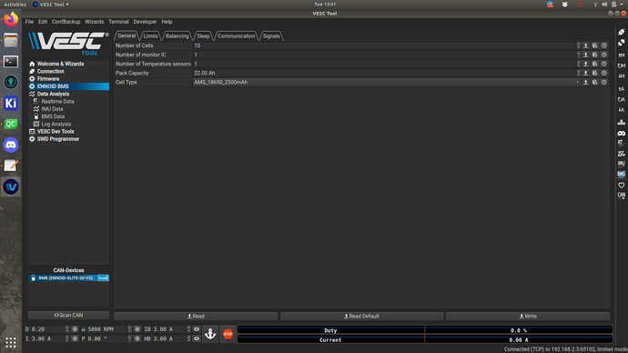

Configuration with VESC tool over BLE TCP bridge explained :
Once balance, battery and charger are plugged in, connect over the XLITE Bluetooth with your phone, enable TCP bridge in VESC tool mobile:
Then connect in VESC tool desktop with the IP address provided in VESC tool mobile:
You can configure the XLITE:
And stream real time data, enable/disable charging at will:
Once sealed, the battery pack datas can now be accessed and configured wirelessly, which is quite convenient. CAN bus IC being isolated, we won’t need to care about CAN bus connection order with this board…but only if you still decide to use CAN bus with your VESC, which is not really essential by the way.
