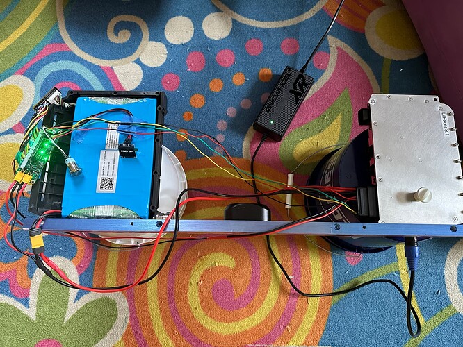

Working with Ennoid V3 connected to LilFoc 3.1. Stock XR pack and known good charger. Other settings seem right. I cannot for the life of me get the BMS to enter the Charge State. When the charger is plugged in it attempts to initiate but then shuts down after timing out. If trying to “Allow Charge” from the VESC tool it powers down immediately. @ENNOID , any thoughts?
I would add the images of the sequence of what I see when plugging in my charger, but I do not have access to post images yet.

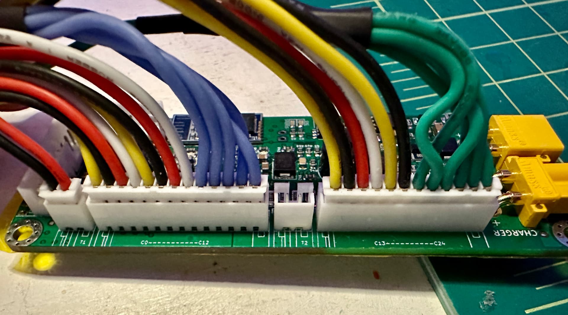

The sequence I see when plugging in the charger.
This is a very strange behaviour, it should reboot and not just shut itself down. Any picture showing your setup. Something might not properly be connected. The BMS goes into charging state, but no current is flowing in, so the XLITE shuts down itself.

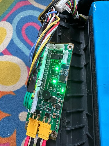

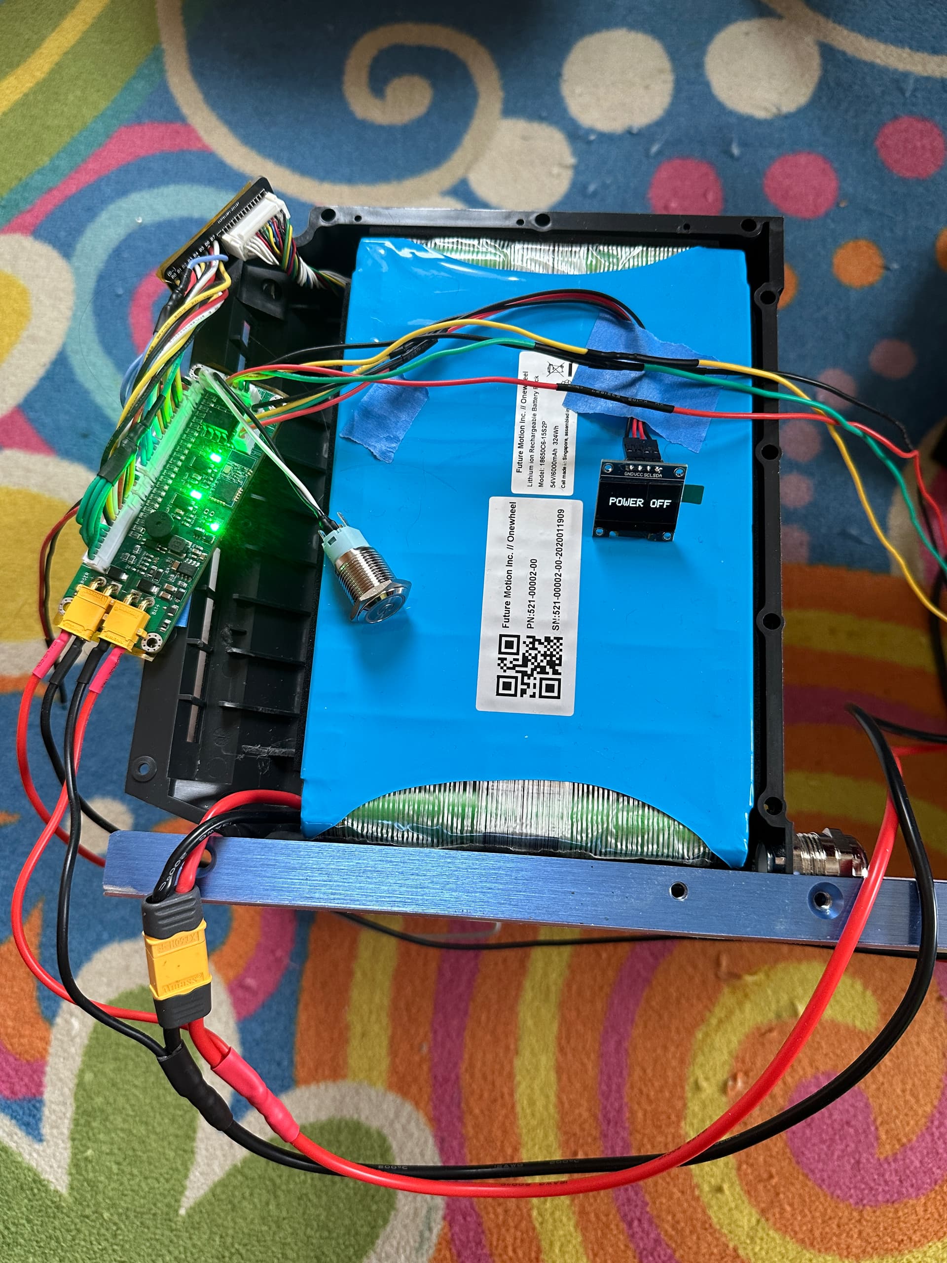

@ENNOID, thanks. I agree its seems weird. Here are some pics of my test setup. I assume I should not need to have the motor connected to test the battery side. Relatively new to this, but perhaps not a complete novice and didn’t hit any obvious snaps on setting it up thus far. Let me know what other info may help you.

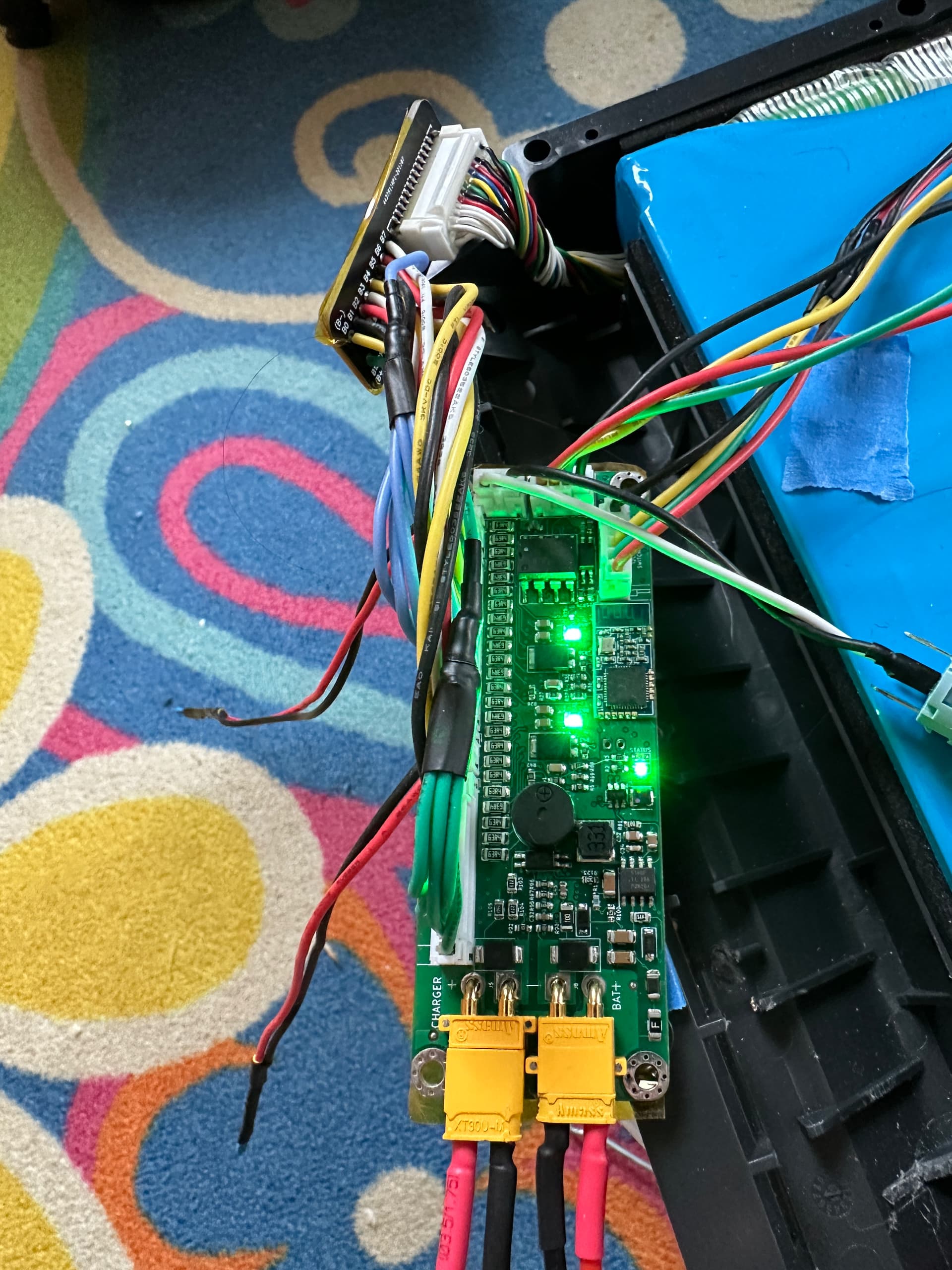

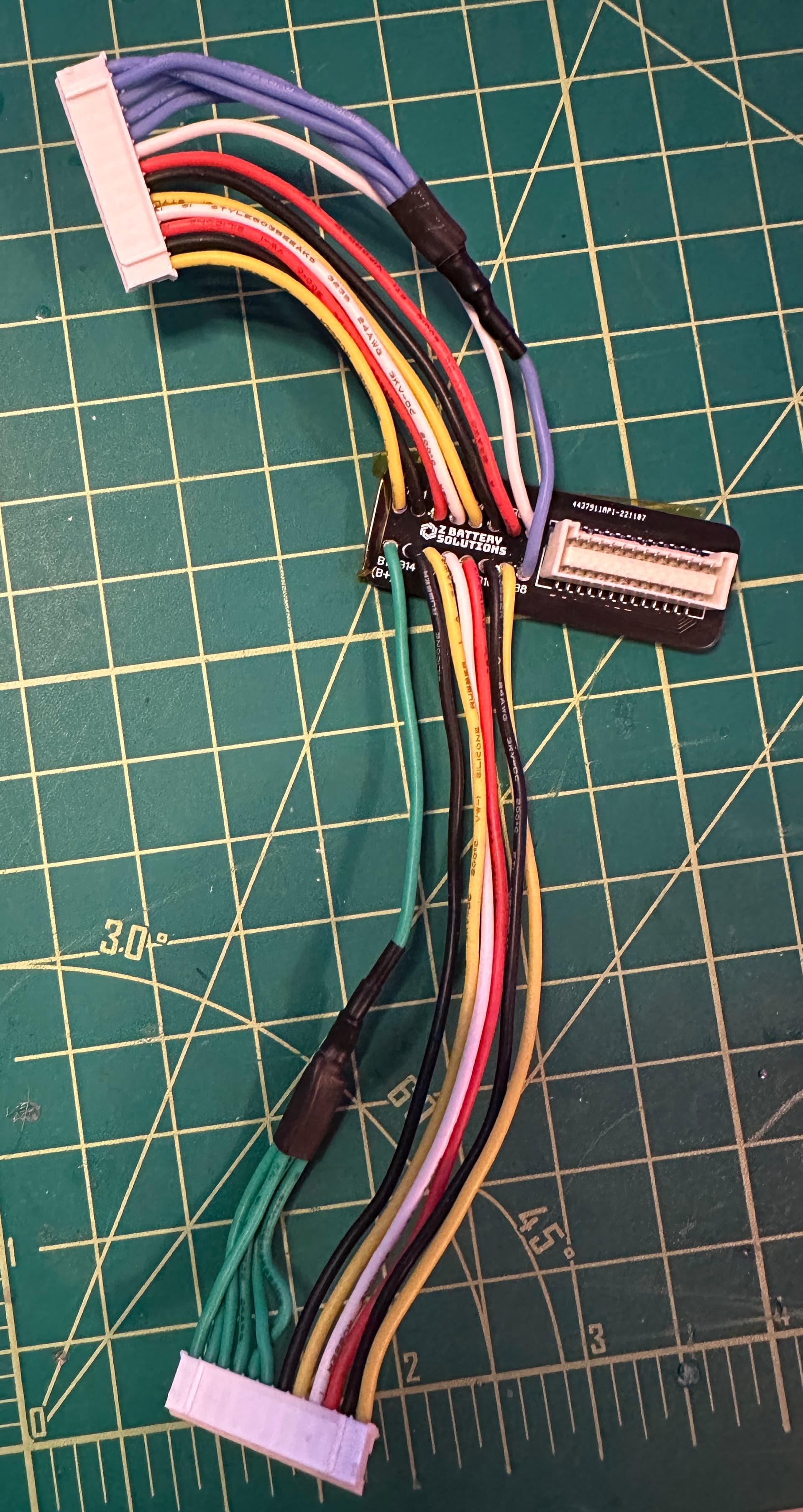

Showing my shorted balance leads.
Could you try without any accessories connected. Button, display, CAN. I think your button might not be wired properly and shuts down the charge process. Hard to see exactly from the picture

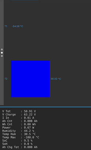

With everything unplugged.

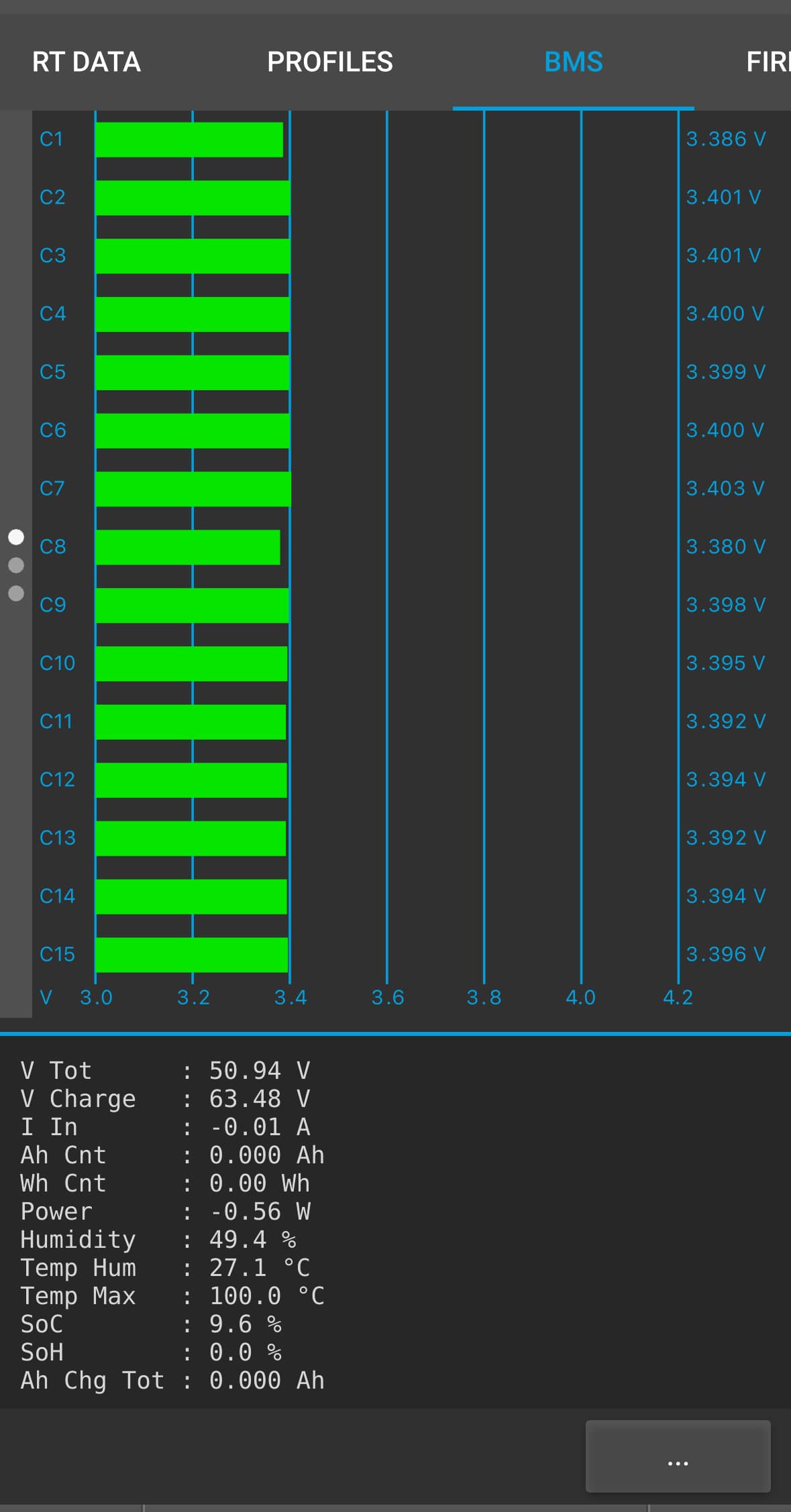

I think I see 9 LED flashes upon pressing “Allow Charging” in VESC tool.
The BMS stays on and does not disconnect or restart, but not getting current from the charger. Charger LED stays green.
I also get 9 LED flashes upon plugging in the charger to wake the BMS from everything being off.
I assume I don’t need to worry about the temps being reported? This is with 0 sensors per IC. I think I have all the Limits set to not allow Temps to prevent charging.
yes, that is weird, maybe you could share your settings in PM so we can try to troubleshoot this in private.
For now, 9 Blink is error code #9 which is FAULT_CODE_CELL_SOFT_UNDER_VOLTAGE. That is possible that a low cell is blocking the charge process due to soft over voltage setting, but it could be something else as well.
