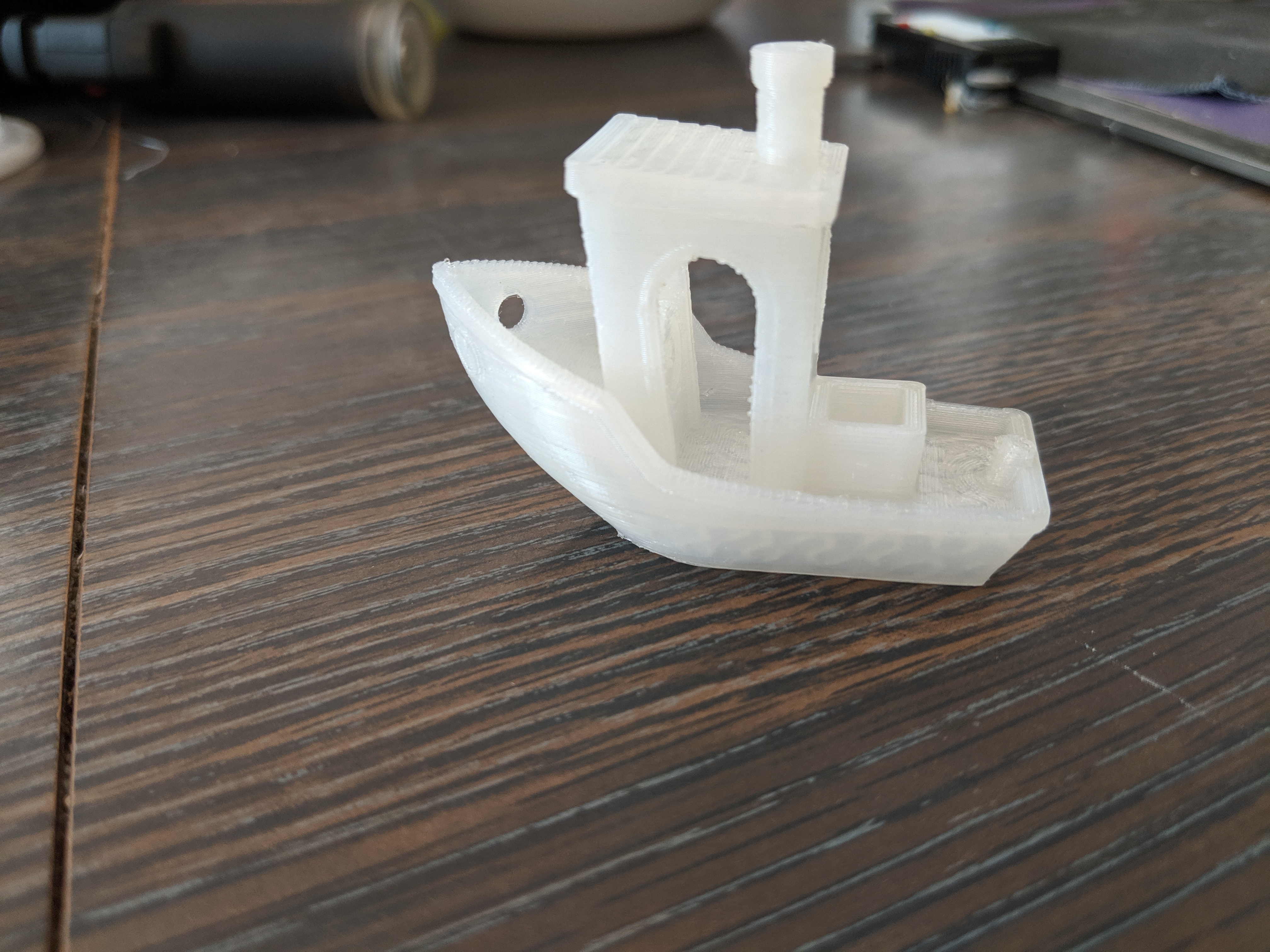

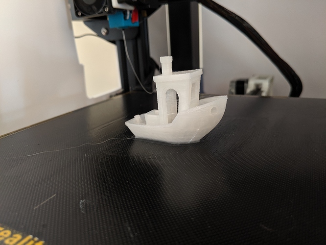

It looks beautiful and clean. Also printed without any cooling. The layer adhesion is not as good as PETG though. I was able to snap the chimney along the layer lines, with some effort. But otherwise the along all other direction it is impossible to break, even with pliers. Gotta increase the temperature and maybe the flow% too.

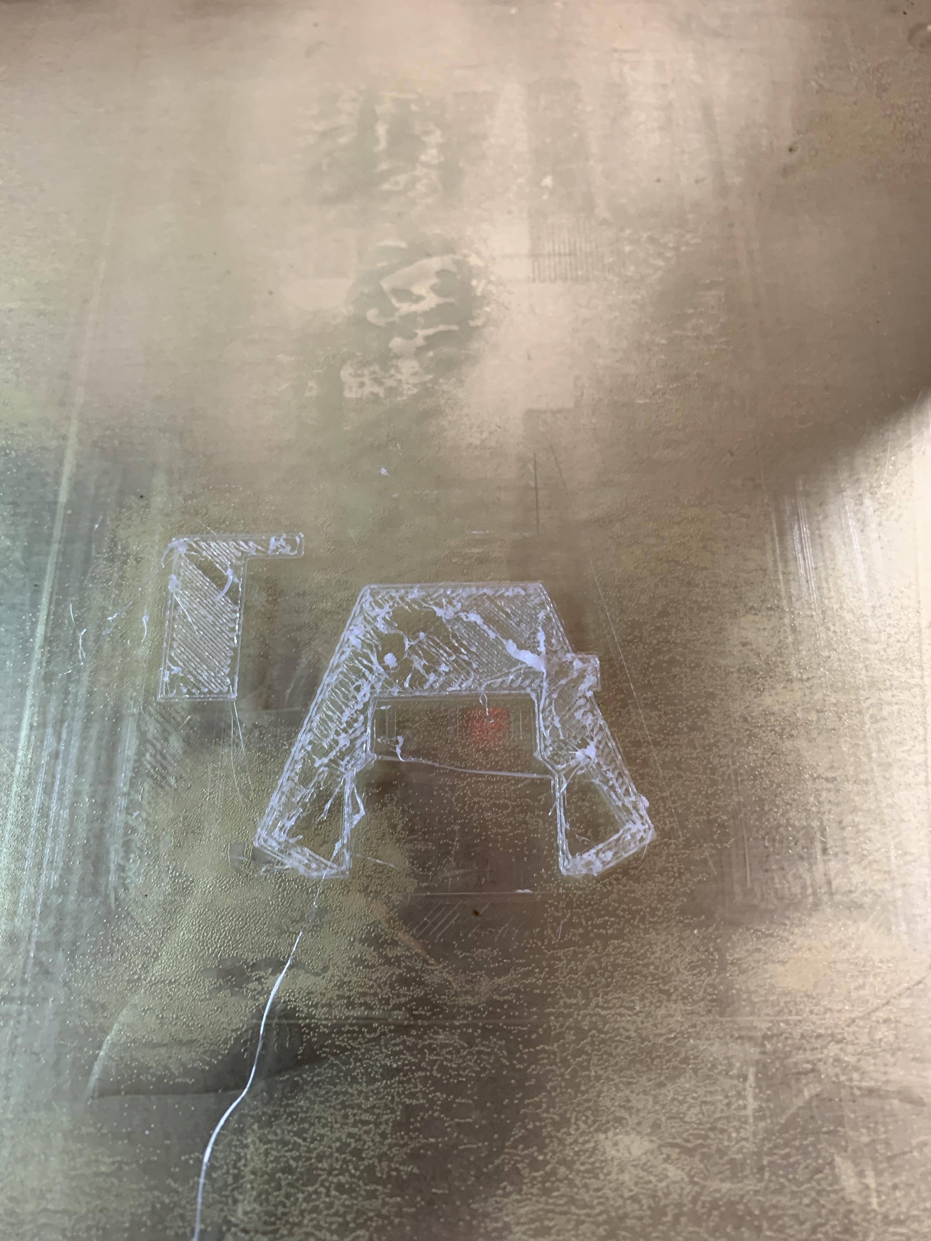

Bed adhesion problem was totally solved with half PVA+half water smeared on the build plate. It was strongly stuck to the build plate, I tried removing it with water, alcohol etc. Nothing worked. Then I just increased the build plate temp to 80C and it popped right off.

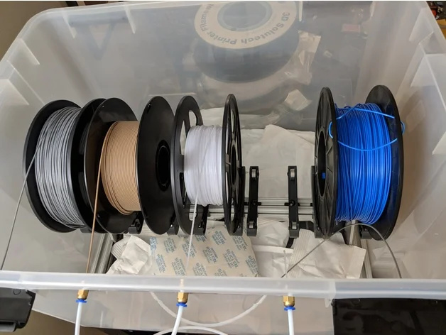

spool holder for 80/20 aluminum extrusion(1" square) by mishrasubhransu - Thingiverse. Moisture is no fun. This provides a isolated path for the filament directly to the extruder to reduce exposure to moisture. Have had no moisture related issues with TPU, PETG and more recently nylon.
The one thing i would like to change about this design is the angle at which the ptfe comes out of the dry box. it should be pointed downwards rather than 90 degree from the surface of the box.

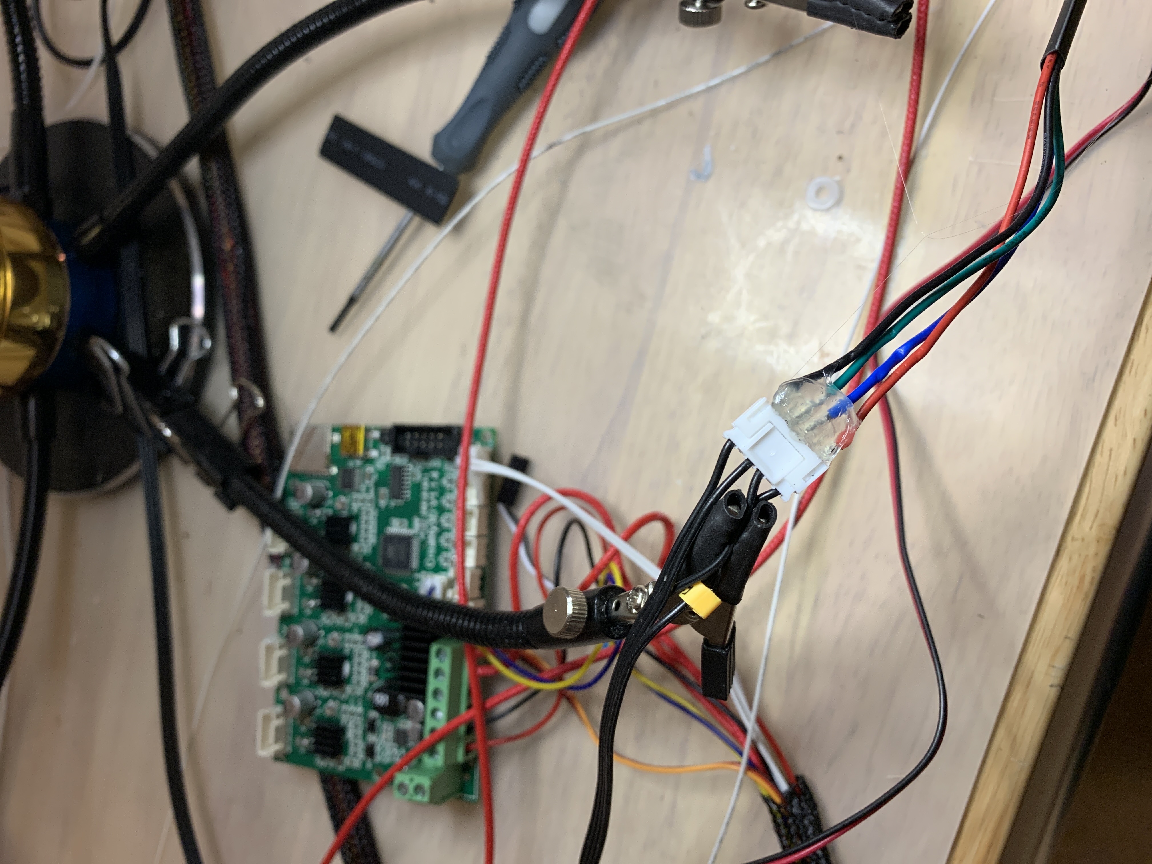

Thanks guys. God how much I hate solder on jst lol

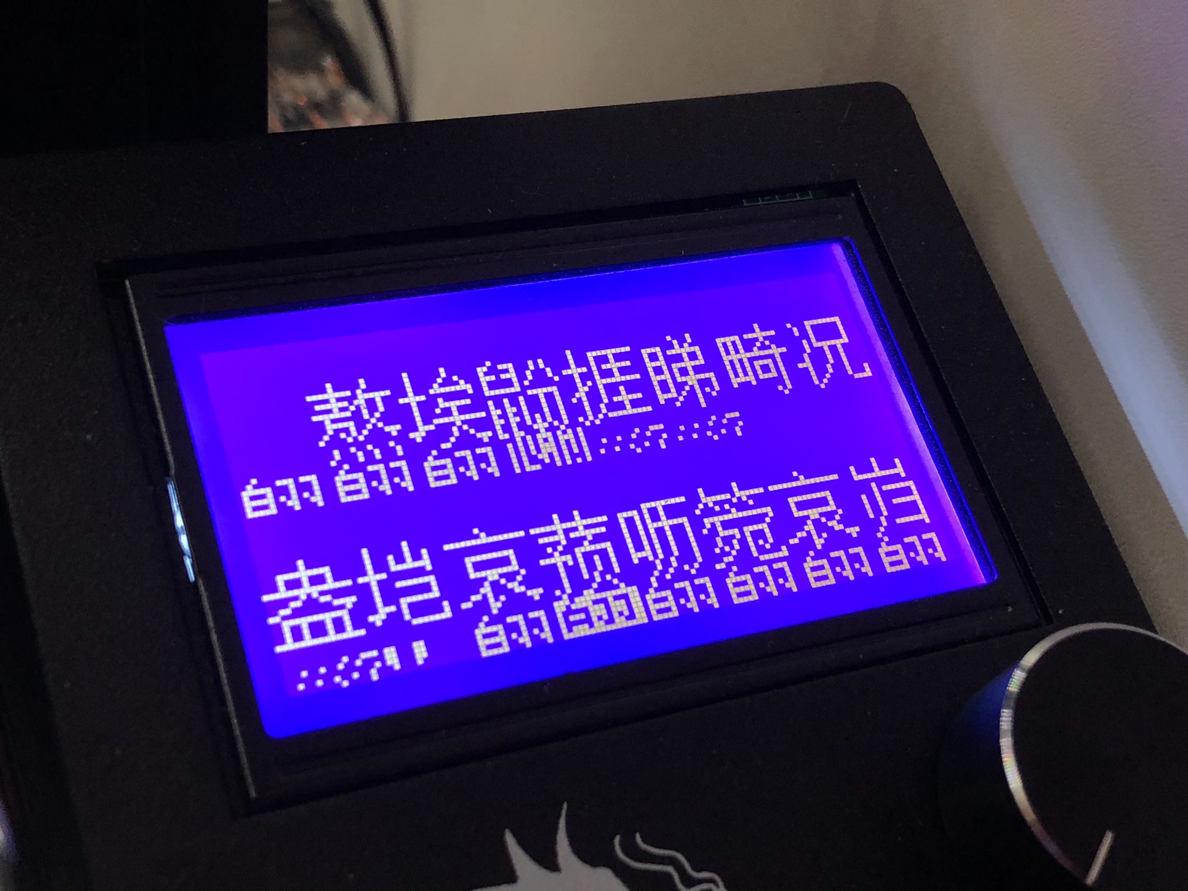

@mishrasubhransu If you’re enclosing the printer, I recommend you at least remove the PSU from the printer frame and place it outside the printer enclosure. And if possible, also the mainboard wants to be in a cooler environment. Learnt this the hard way - mine overheated and started speaking chinese to me.

Mounted everything … works … well … sort of:
It seems isn’t pushing enough filament … werid
search for esteps in TH3D configuration.h. Uncomment #define custom_estesp 415. Upload firmware. This is assuming you are using TH3D
Gonna test now! I enable also V6_HOTEND … wish me luck lol :smiley:
