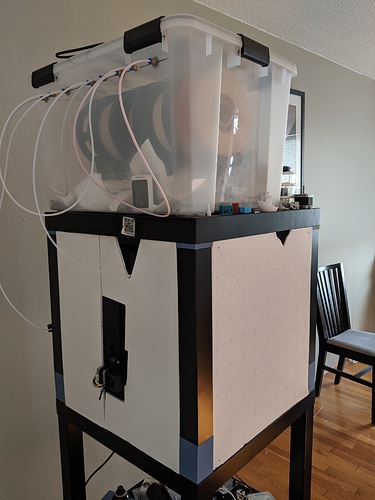

Well as enclosed as I could get. The relative humidity inside the dry box is 11%. Hopefully nylon won’t absorb much. I left it in there over night and still it’s not making any popping sound. So far it seems good. Also what migjt be helping is that, the filament is not directly exposed to air at any point, except inside the BGM extruder just for a bit.

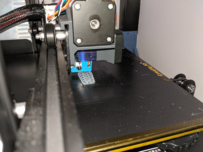

Printing benchy. :crossed_fingers: with PVA coating with bed at 45C. It’s important not to go higher because PVA starts to soften at higher temperature.
Looks good :crossed_fingers:. Only thing the huge later holes will dissipate all the heat. Maybe make a square print to allow the motor to move up and down but that closes the printer inside. Even a blanket on top will temporary fix it. I made my enclosure in a way that all the printer except the power supply and display fits inside.
In the dried chamber you can also had a heater sheet. The one used for reptile. They are cheap and it helps in keeping filament tried.
I see you passed by IKEA :grin: perfect tables for enclosure.
Yeah, I should remove all electronic to outside. The space inside is enough to have the motor inside, it’s just that the position of the ptfe tubes coming out from the dry box makes it hard to seal everything in. I have to sit down and make some changes.
But I am not worried about heat escaping because I just have to main 45C inside, same as bed. Basically what I want is that there is no temperature gradient as the printing goes on.

How did you guys mounted the filament roll?
I will put on top of the enclosure. If without then on top of the printer. It’s easier with direct drive or the filament will be to close to the print

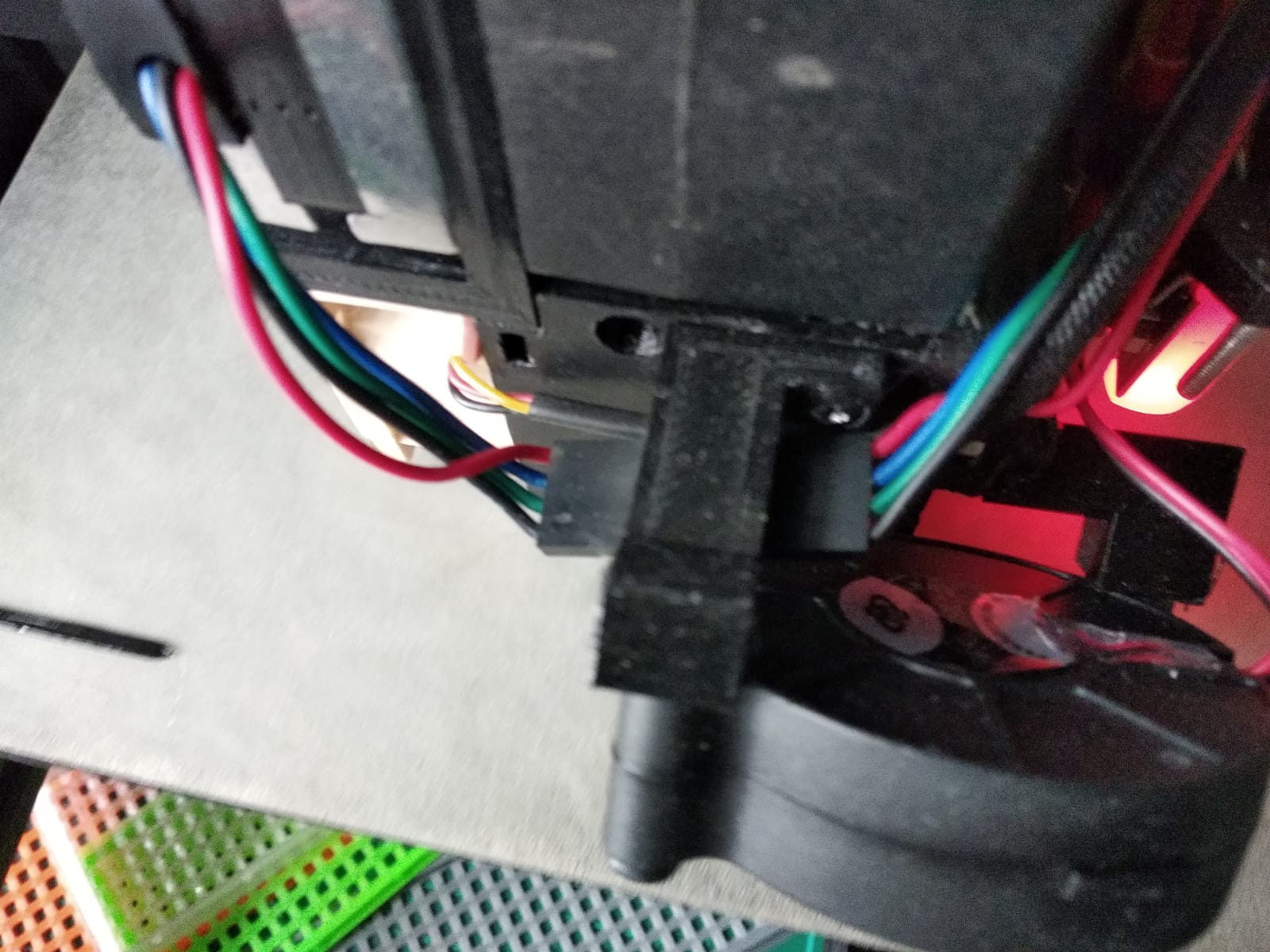

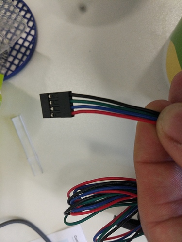

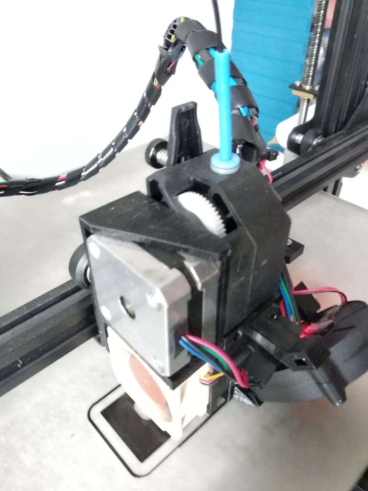

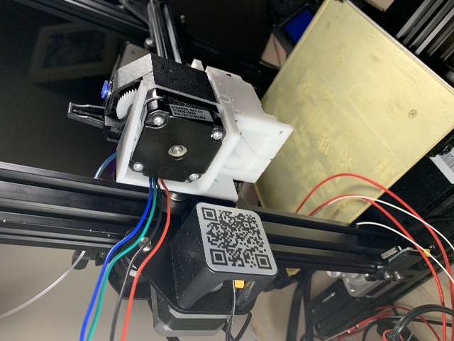

Can you take a pic of how the small motor is wired? I got mine without jst and no instructions lol :joy:
You have to swap the central wires from the printer JST. because the coils ared inverted otherwise the gear will turn in the wrong direction.
1 sec and I take the picture
From left to right is red - blue -green - black
On mine it goes Red - Blue - Green - Black. I wired mine with a dupont connector so it could be replaced easily (all x carriage electronics have connectors so I can service stuff easily). If it rotates the wrong way, you can change it in firmware, or just rotate the connector 180 degrees.
